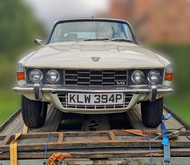

The answer is this:
Excuse the blurring. As the photos were taken in the seller's front garden I wanted to blank out the background as far as possible to remove any landmarks.
A P6 has been on my wishlist forever, but finding a viable one with a reasonable price tag was something I'd given up on a good few years back. I did look at a few about 15 years back, but all the ones I could afford then were complete basket cases.
A chance post appeared on another forum a couple of days ago from the seller of this car where they'd had issues with a buyer for this car having backed out making up non-existent issues when they had it delivered to them. I then figured it couldn't hurt to ping the seller a message, and the rest as they say is history.
From the look around the car I did it seems astonishingly solid. Bit of surface rust here and there and some historic repairs, but nothing worrisome. It hasn't been in use for Quite Some Time however, so will want to be properly recommissioned. It does however run, drive and apparently stop - so not a bad situation to be starting from.

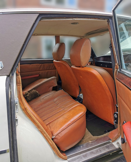

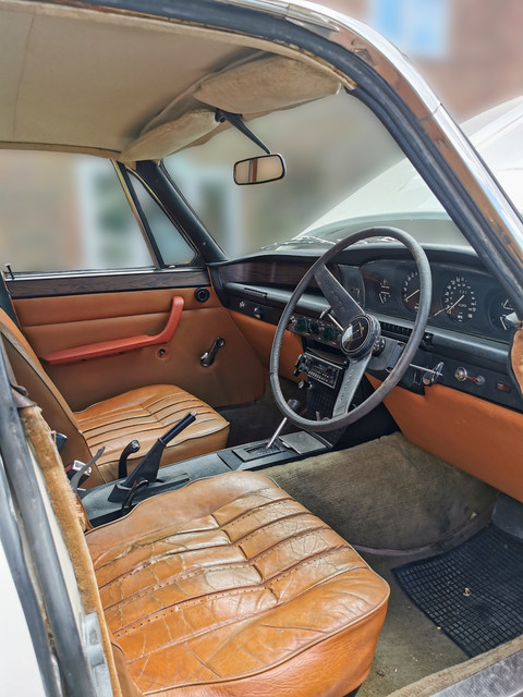

Have to admit I'm really pleased it's not brown with a black interior. I mean they do look good in those colours, but it feels like virtually every one you see is brown/mustard or a very similar greeny grey to the P4 and with a black interior, and it's no secret that I like lighter or more colourful interiors. Exactly like this.

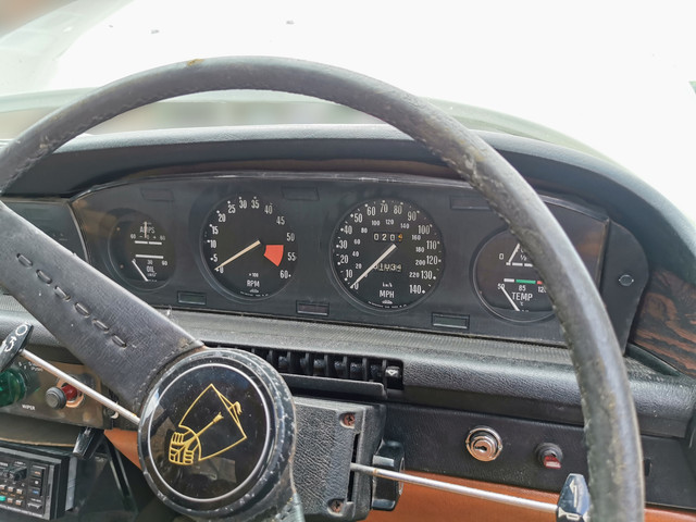

Odometer is showing 01034 - so that'll be 101K.

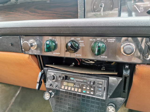

Have always been curious to see what this panel looks like at night.

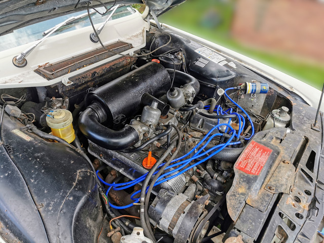

Nothing scary under here.
The previous buyer claimed that the oil was full of fuel and that a head gasket had gone because of the moisture on the oil filler. Yes, there's a bit of fuel in the oil but nothing you wouldn't expect from a car that's been out of use so probably hasn't been run off choke in years. Likewise there's a bit of condensation on the cap, but absolutely nothing you wouldn't expect. We're both kind of baffled over what the previous buyer was playing at.

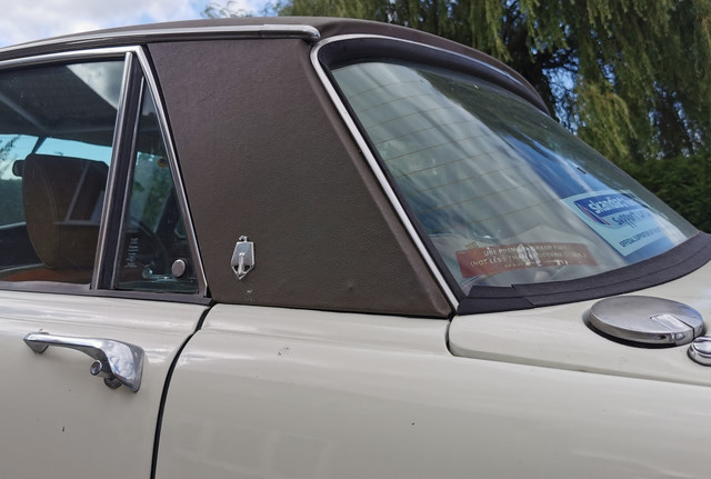

Even the vinyl roof is in decent shape.

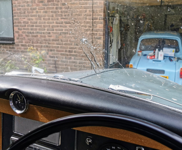

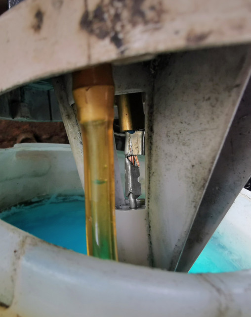

Only had half an hour to devote to car things today so chose the non functional windscreen washers on the P4. This was bugging my OCD, especially as I could hear the motor run so knew there couldn't be much wrong with things.
The issue was that there was originally a rubber coupler between the motor output shaft and the impeller. This had long since turned to powder. A previous attempt to repair this had been done using heat shrink tubing, but this wasn't a tight enough fit to transmit torque to the impeller.
After scratching my head for a while I ended up fabricobbling a coupler together using a horribly mangled crimp terminal, some wire and a screw terminal block minus its outer plastic casing.
Pretty? No.
However it is effective.
Not exactly a huge torrent of water, but it does what it was designed to. Nice to have ticked it off the to do list.
I'm sure the coupler is available as a spare if you know what to search for, but my attempts to find one a few weeks ago turned up nothing, save for the whole pump/motor assembly for more than I wanted to spend when it was surely fixable.

I wonder if using some heat sleeving with reinforcing wire would work?
- Posts: 4985
- Joined: 16 Nov 2014, 23:36
- x 1491
Re: Zel's Fleet Blog - BX, Jag XJ-S, Sinclair C5, Mercedes 208D & 230TE, AC Model 70.
Probably the most elegant solution would just be a length of really stiff rubber hose of small enough diameter - I imagine that's all the original coupler was. Sadly I didn't have anything even close to small enough in stock. So improvised with what I had to hand.
I was originally going to use a slightly longer brass coupler, but the set screw stuck out too far at the lower edge and would foul on the frame unless I ground the screw down...and that sounded like a lot of work given it meant digging the grinder out which I know is at the far end of the garage and needs stuff moving to get to.

I think that the original coupling was rubber to act as a flexible joint, as the impeller floats relative to the motor shaft.
Is that a 2 wire or 3 wire motor? The 3 wire version has a clever but unreliable "one-touch" function that is seldom understood.

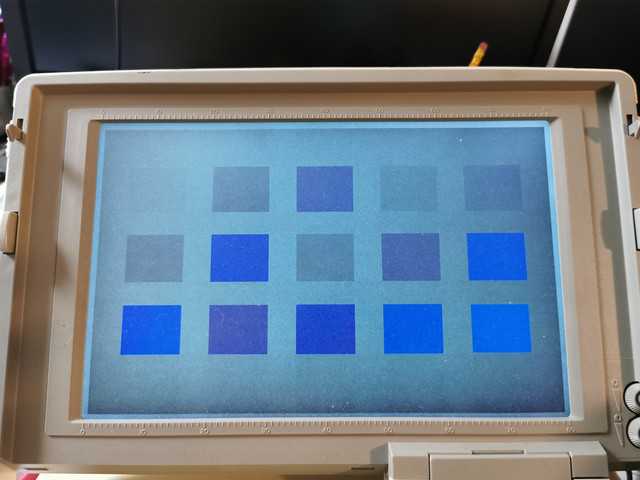

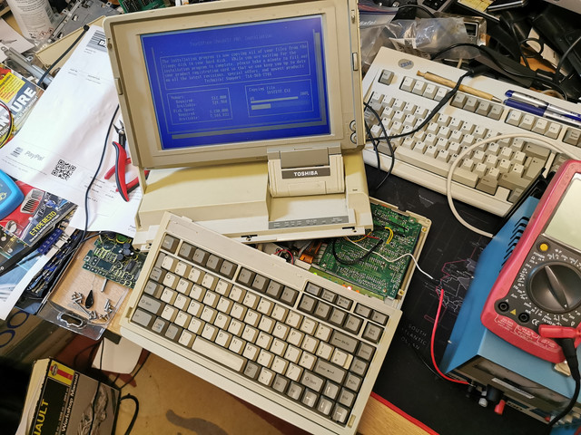

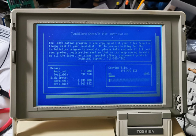

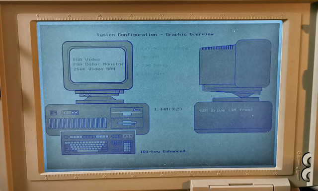

This evening I attacked our old friend the Toshiba T1600 again.
Look at that!
This is now running on a Pico-ATX power supply attached to the underside of the original PSU board for everything aside from the -22V rail, which is currently being supplied by the bench top supply next to it.
I wanted to verify a couple of things before I got too involved in dealing with that. Firstly was that the system itself was still working. Secondly was that the display would actually work when I fixed the missing rail. Finally was to get an idea about how accurate the voltage needed to be on it. Annoyingly the answer is actually "quite accurate" in this case. It needs to be within 0.3V or plays havoc with the contrast. So I think I'll just be picking up a pre-built adjustable module for this as it's likely to be far less twitchy than anything I build. I doubt it will fit in the power supply area, but they're pretty tiny things so hopefully I can cram it into either the bay for the modem or expansion slot which won't ever be used for anything else.
It may be a bit of a pain to power (well, not compared to a plasma, +295V as one of the rails sound fun?), this display really does look nice.
Yes, it really *is* that deeply saturated a blue in person, the camera isn't exaggerating it. I've always liked the smaller version on the T1200, but having a larger, higher resolution version is rather nice. Plus this can do something that the T1200 can't: Greyscale.
Which means we can do things with graphics much more convincingly.
Next step for this is going to be to tidy up the installation of the power supply as it is, then reassemble the machine. I'm just going to leave two wires sticking out the back for an external -22V supply for now as I'd really like to get a bit of soak testing done sooner than later. Plus it will allow me to get some experimentation done, get some proper photos for the website and to get the software sorted out. Currently there's nothing on there of interest, just a broken Windows 3.1 install (actually looks like there are two!), Word Perfect and a backup utility. Based on my prior experience with these hard drives the most sensible thing I can probably do is to low level format it (from that perspective it's handled like an old MFM drive), as several somewhat twitchy examples have behaved perfectly after that. Then a fresh Toshiba OEM DOS install and some choice software will be chucked on there.
Actually getting it into a fully working state this evening though felt like a massive victory! Just hope it stays that way now...
