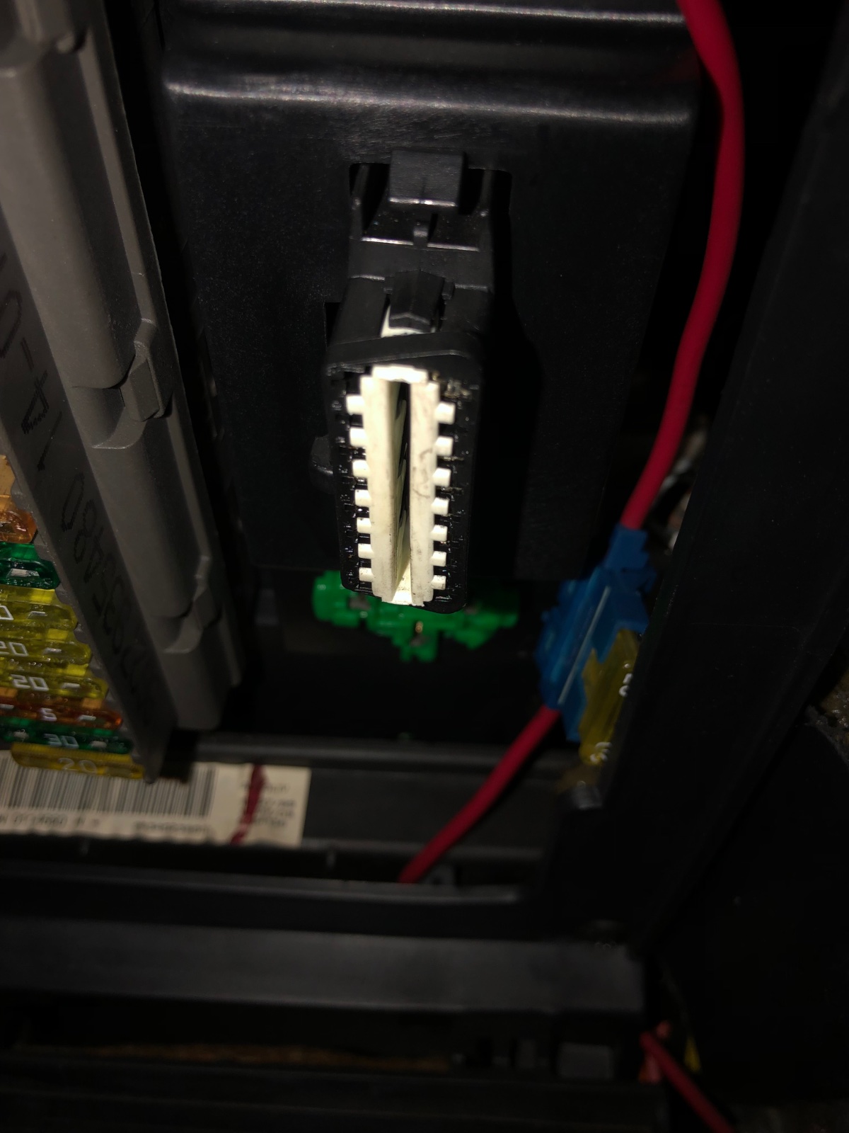

No Rothgar. I never got them from that YouTube link as that plug port is different on my Xantia -
I didn’t want to go proding about in there…just query about the ECU memory from what Jim said and what I read in your manual ….

You do have to be careful with the connector because if you spread the tangs apart too far and stress them then you can cause a problem with communication with the ECU when using Lexia. I accidentally caused a problem on mine and the only way I can currently read diagnostic codes is backpinning at the ECU connector!!!Skull wrote: 16 Nov 2025, 12:13 No Rothgar. I never got them from that YouTube link as that plug port is different on my Xantia -
