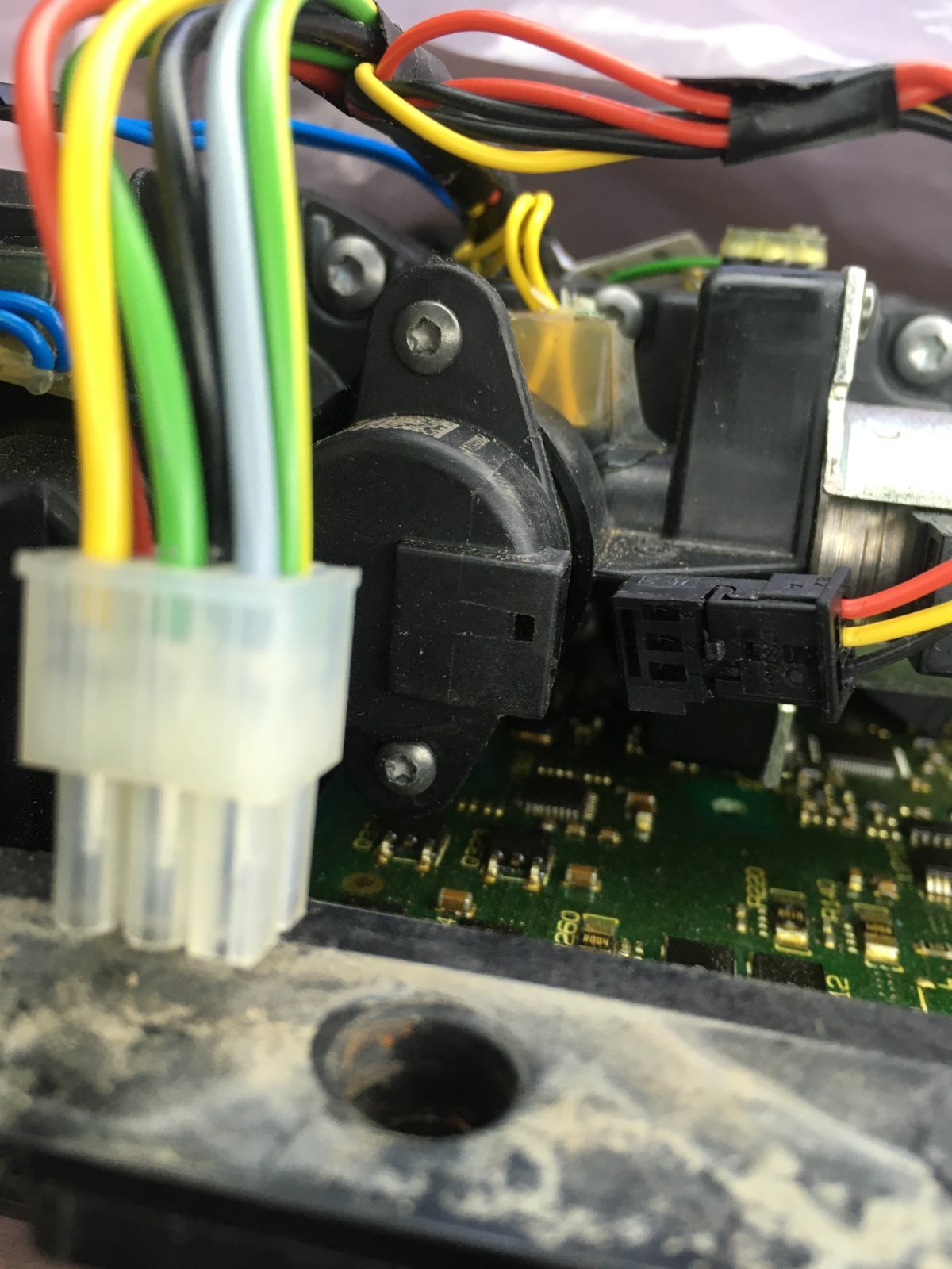

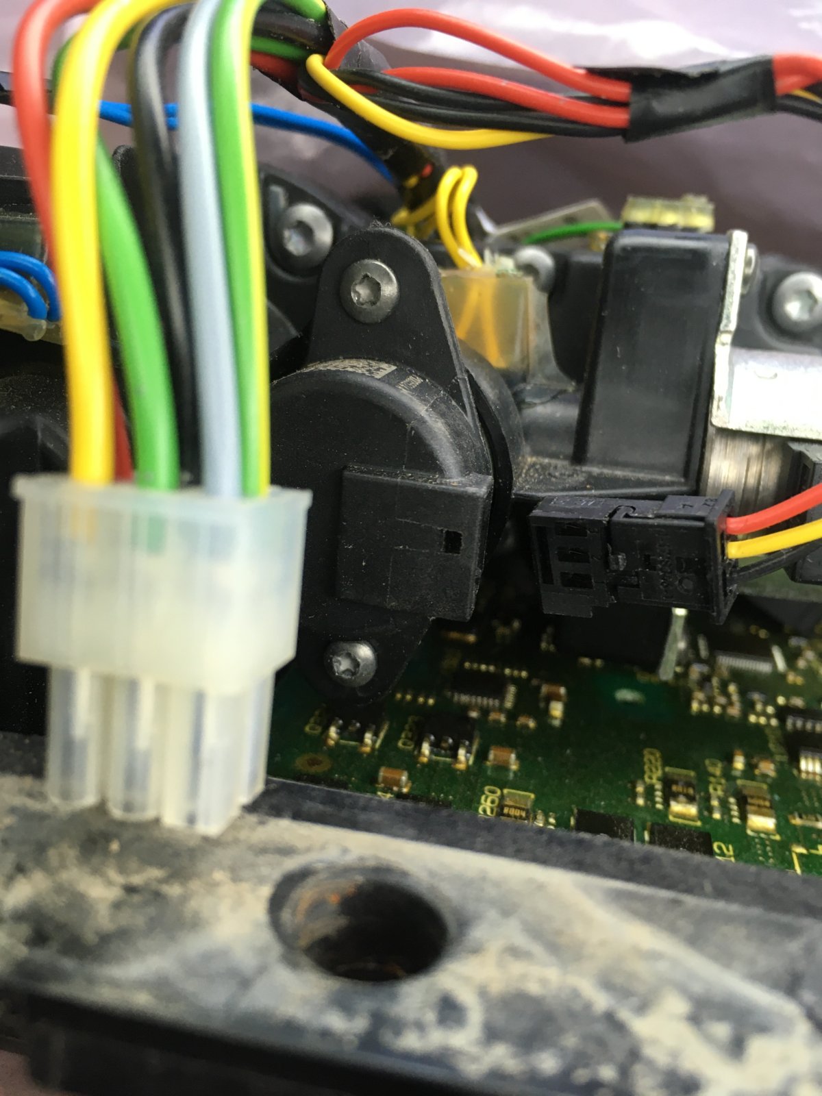

Trickiedickie wrote: 06 Dec 2024, 11:26 So for the second solution just do the usual...........which would be;
1-Drain tank
2-Drop tank
3-Disconnect Adblue supply pipe
4-Disconnect wiring harness
then
5-Remove pump module from tank unit
At this point there are 2x cable connections to undo and 2x screws. NOTE (these are pentalobe 5 point screws and I didn't have one so I carefully used a suitable sized small flathead screwdriver, easy as they are not very tight) and then you can swap out the pressure sensor for a replacement. Then reassemble and refit the tank to car, refill with adblue etc. It would be a good idea to use Diagbox to reinitialise the adblue system as it runs a test at the same time though in most cases this would not be required if all adblue related codes have been cleared from the system.
The photo shows the multicore white cable connector disconnected from the pcb and the sensor black 3 core connector, both disconnected, and with the 2x pentalobe screws as fitted.

_________________________________________________________________________________________Stuart W wrote: 06 Mar 2024, 15:50 Some of you may have seen my posts on here when my 2015 Grand picasso suffered the all too common adblue pump failure with persistently screaming pump and Service light on, engine fault light and urea light on.
Diagbox says leak/ low urea pressure.
It is worth noting that diagbox says pressure is 4 bar even when its actually zero.It does not read below 4 bar.
However, when I removed the tank and ran the pump directly from 12 volts with a pressure guage attached to its output, the pressure shot up immediately way past the required 6Bar, reaching 8 or 9 bar in seconds.So the pump was not faulty.
The culprit was the pressure sensor that is built into the pump body.I metered the output from this sensor and it did not register the pressure changes at all.This explains why The pump was screaming, trying to reach a pressure that was not being seen by the sensor although in fact it was already too high.
The faulty sensor also mislead diagbox and me for a while, by saying the pressure was too low.The system will not inject the adblue if it thinks the pressure is too low.
This noisy overworking adblue pump seems to be a commonly reported problem so I suspect that the majority of adblue tank failures are due to this sensor.
THE FIX.
Since the original sensor is a purpose built part moulded in plastic and attached to the pump motor it cannot be replaced without PSA manufacturing a spare part.
The answer is to fit an external sensor in the urea output pipe that runs to the injector.
I bought some 6mm fuel line connectors, male and female ant with some 8mm hose and 8mm brass tee piece inserted this short extension pipe from the output of the blue tank.The Tee piece connects to an 8mm to femake G3/8 thread adaptor to accept a standard 3 wire pressure sensor (10 Bar)
The existing Citroen pressure sensor has a small 3 pin plug with red,black and yellow wires.Unplug this from the sensor and connect the new sensor to the same wires.In my case the new sensor had a green wire instead of yellow, but connect this green wire to the yellow of the Citroen lead. The Red wire is + volts supply and the black wire us - volts supply.The yellow or green is the sensor output which should move from 0 volts up to 5 volts as the pressure increases.
Since the sensor comes with about 30 cm of wire attached you will need to drill a small hole in the plastic lid which covers the pump and its electronics.
Feed the sensor wire through this and connect the red, black, green wires to the old sensor lead.Seal the cable hole to prevent dirt and moisture getting to the electrics.
While the tank is out, it is worth offering up the Tee piece extension hose to find a suitable location for the sensor to fit as space is limited between the adblue tank and the spare wheel.Adjust the hose length to allow the sensor to fit into one of the recesses in the tank moulding.
For belt and braces, I put two jubilee clips, close together, on each pipe joint. So 12 hose clips in all.
It may be necessary to bleed the adblue system with diagbox before clearing all error codes.In the course of doing this mod I have only had to bleed the system once.Previous times it was ok.
To see what is happening with your faulty tank it is worth checking the pressure by using a piece of this same 8mm pipe and clip on 6mm fuel line connector running to a 0 to 10 bar pressure gauge, also available from ebay or Amazon.Once the engine is warm the adblue pump should operate periodically to bring the stored pressure up to 6 Bar.
If your adblue pump is screaming and the fault codes are saying low pressure then it is worth doing this low cost fix.
All parts were bought from Amazon for a few pounds.See my attached photos.
