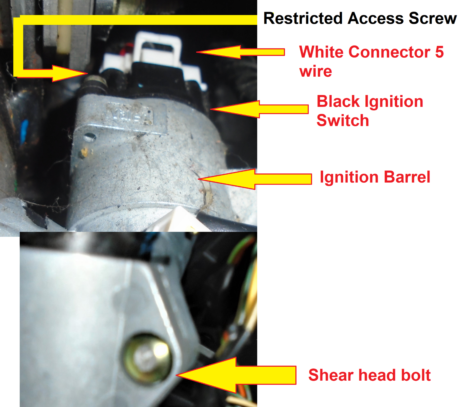

Re: Toolbag Tales-Homemade and improvised tools
nf own work
nf own work
Excellent info on the "security" shear head bolts, but if I can avoid touching them I will.
So any creative thoughts on how to remove that little retaining screw for the ignition switch with literally no back room to get an angled screwdriver in. We can rule out removing the steering column as an option for now.
Tips and wrinkles welcomed :)

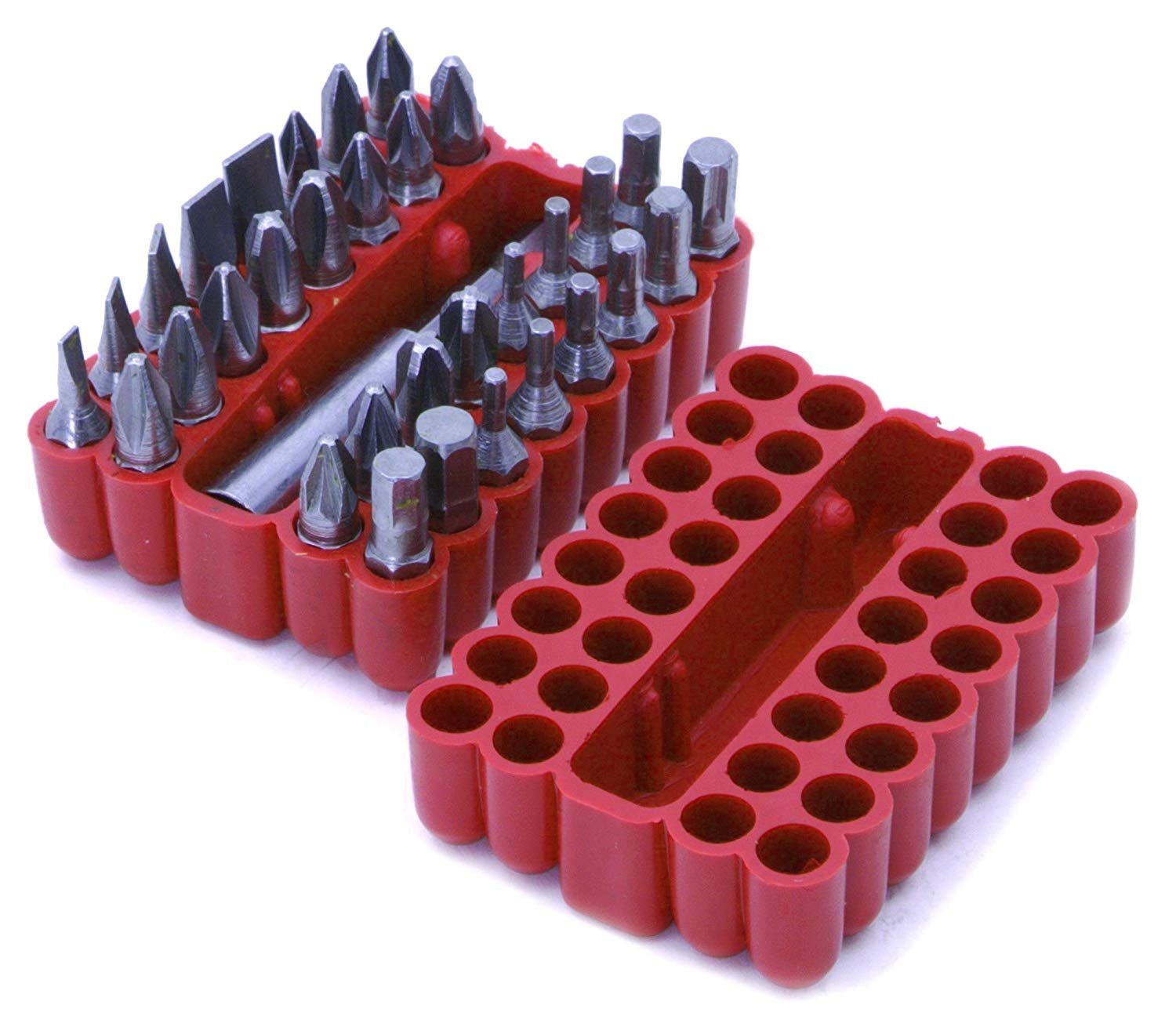

It looks like you may have room for a screwdriver bit from a set as below. Determine the right bit, mix up some araldite rapid and coat the bit tip and then strap the bit onto the screw with a cable tie. Leave it overnight and then carefully undo with small spanner or long nosed pliers' It has worked for me 5 or 6 times and failed a couple so it may do it:

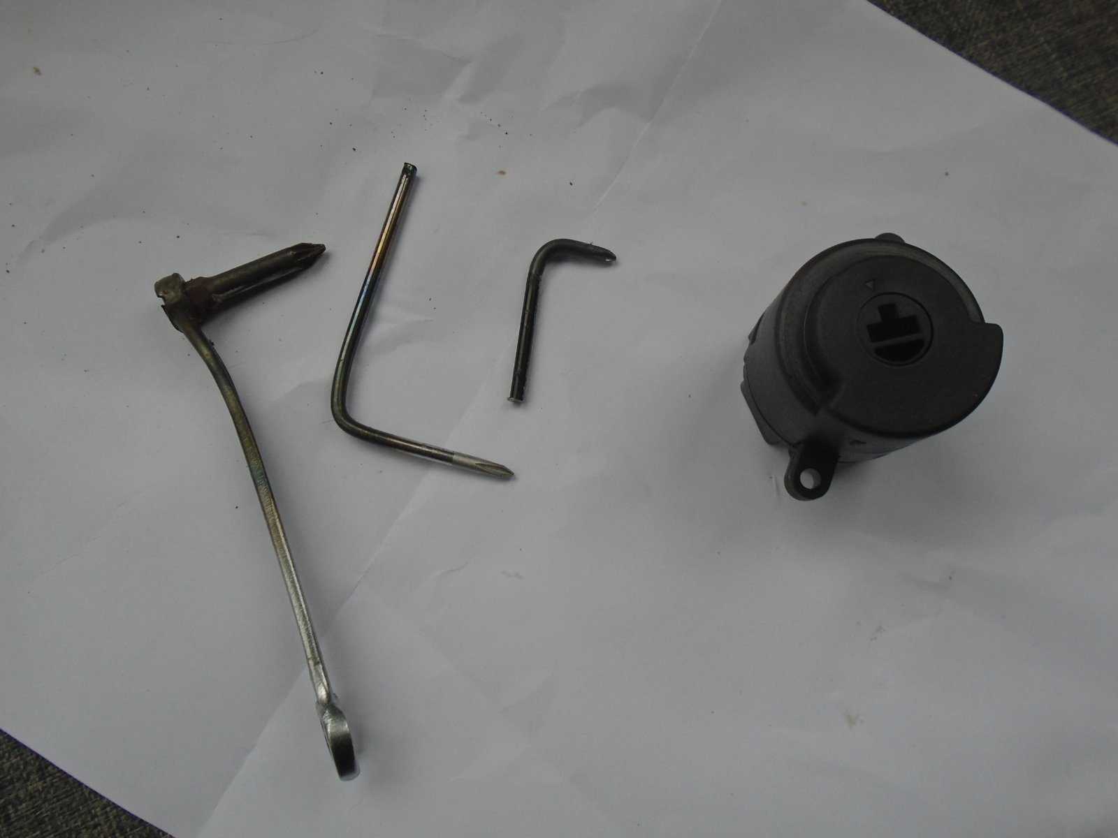

Like it Mick, very creative. The black switch is held by 2 screws, one of them much easier to access so remove that first and find a decent tight fitting bit like you say may just work. It really is incredibly tight for access room. I suspect you are supposed to take the barrel off, but the shear head bolts obviously don't make that easy.
May even have to grind down the length of the screwdriver bit to give that method a chance!
How long should it take to undo 2 screws? The entire afternoon if you have to forge your own tools to get them out.
nf own work
nf own work
The black thing is the ignition switch
Well done Neil, glad to see you cracked it!! Now you just need to refit the repaired/replacement one!! :clap: :clap:

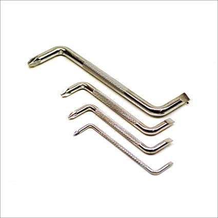

Have you none of these Neil?
Invaluable.

myglaren wrote: 30 Sep 2019, 17:33 Have you none of these Neil?
Invaluable.
Would have been handy Steve and saved a bit of time at the blacksmiths!
