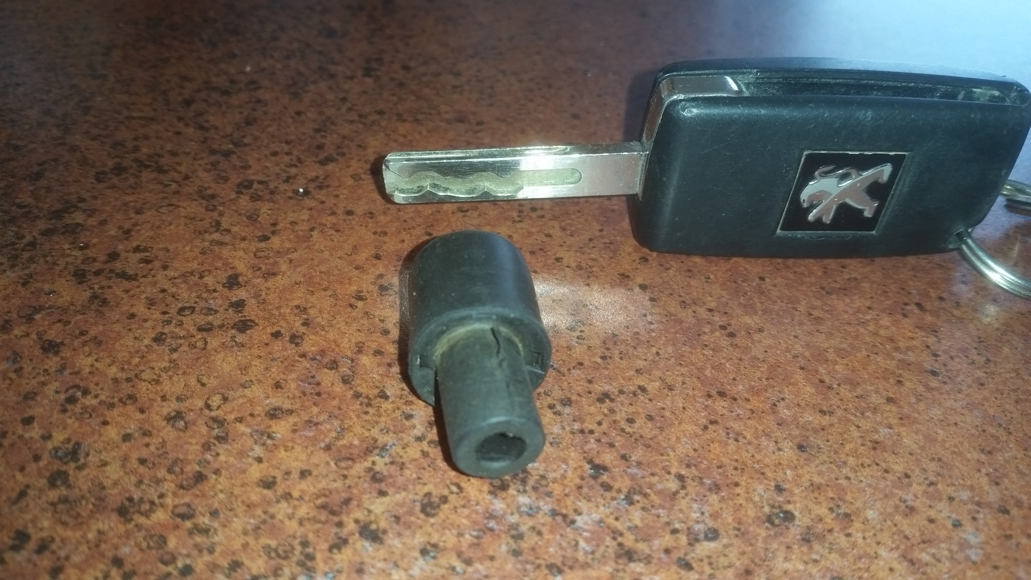

I removed all the stuff that is in the way of inspecting the hose from the boost control valve to the actuator (and there is quite a lot to remove), but inspection showed that the hose was not kinked, and sucking on it indicated that there is no restriction (although with the valve on the other end it is not a conclusive test.
I then need to find an alternate theory, and I think that I have nailed it (although it seems to be an unbelievably stupid design error).
The boost control valve has 3 ports, one to the (brake) vacuum pump, one to the waste-gate actuator and one that vents to atmosphere. On BMW cars with this engine, the atmospheric port has a clip-on filter to stop dust being sucked into the valve. PSA decided that improvement was needed, and run a hose up the back of the engine with a (different design of) filter situated just behind the cam cover.

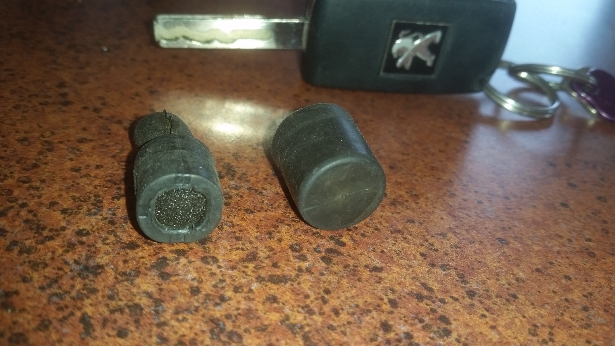

The problem is the design of the filter. it is a rubber tube with a small cylinder of foam inside. Over the opne end is a rubber cap that is (apparently) a loose fit so that air enters some small cutouts at he end of the cap, then finds its way between the 2 rubber parts and then through the foam element.
On mine, the cap is a snug fit, and makes the whole assembly quite restrictive of the flow of air (the element itself has much less restriction). I refitted the filter without the rubber cap, and took the car for a test drive, and I am fairly confident that the problem has been solved. Acceleration is now gernerally much smoother and more closely coupled to accelerator movement, and I was unable to provoke and over-boost fault (previously it was not very hard to provoke). All in all, the car has never been nicer to drive.
Filter unit assembled, note the 4 tiny air gaps between the body and the cap.
Cap removed
Cap removed

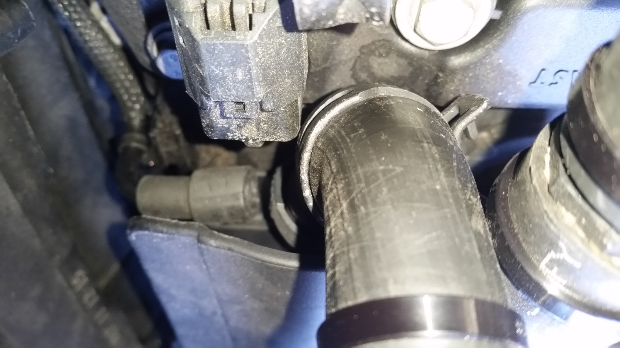

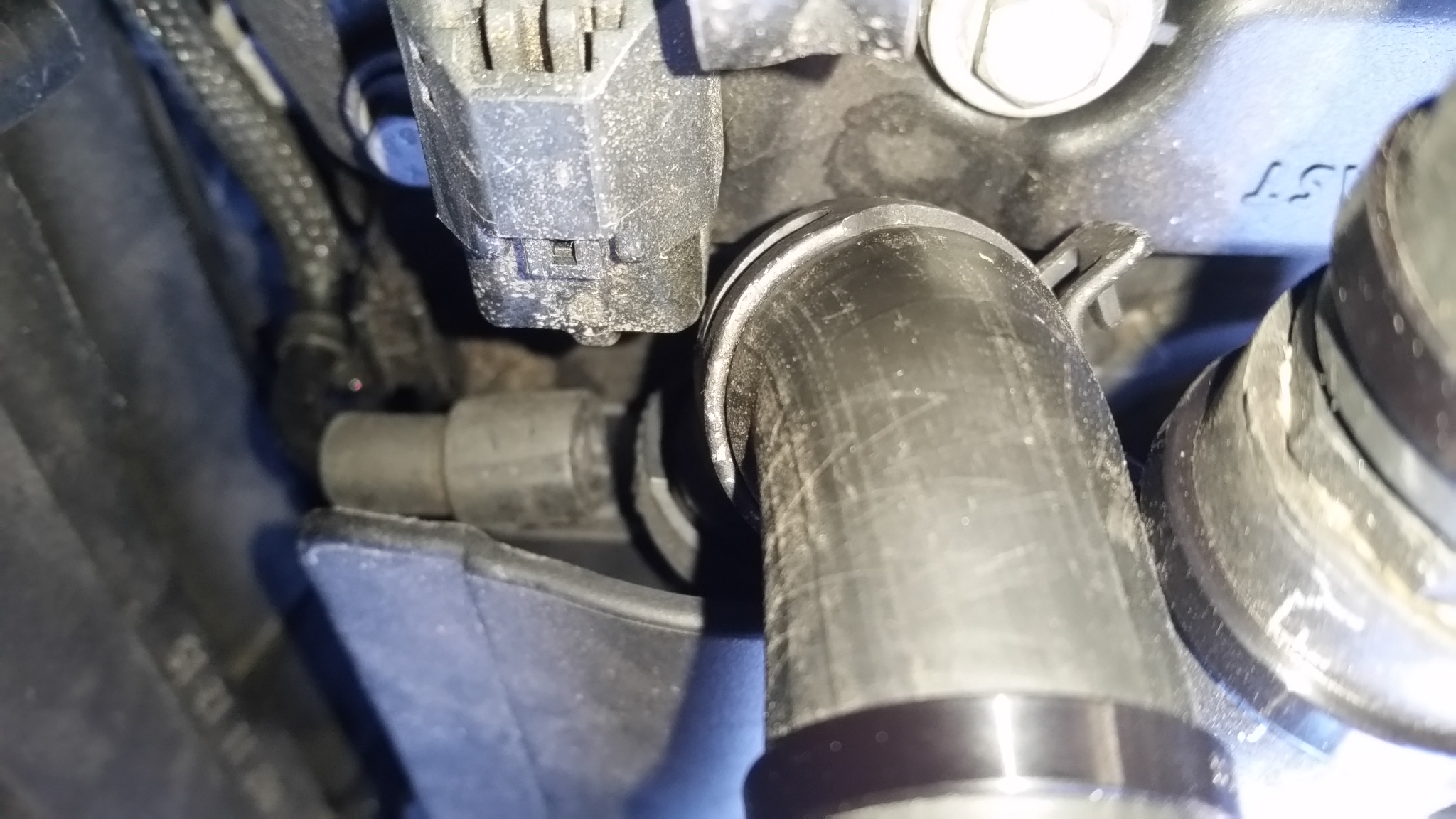

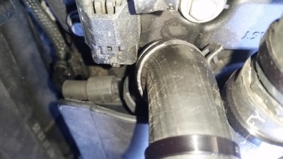

There is the little blighter in position. The photo is rotated, up is on the right hand side. The photo was taken with the camera up against the side or the brake fluid reservoir

Would it not be possible to relocate it?
Sent from my Nexus 7 using Tapatalk
Dave
- Posts: 10750
- Joined: 09 Nov 2005, 22:03
- x 1355
Re: Louise's 308 CC
The location isn't the problem. You can actually get to it with your fingertips without removing anything else once you know where it is.
The problem is the filter itself. Maybe the rubber cap shrinks with age, but it is not a good design
