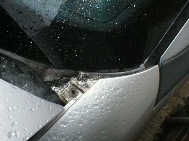

work is still underway on the xm at the moment but i came home to find the Activa was steamed up today, it hasnt done it before now with all this rain we have had.
I had a feel of the carpets and they were dry, stuck my hand unde3r the drivers carpet and that was dry but under the passenger side was soaking wet and there is no smell of curry/burning electrics now so im not sure it is the matrix, the coolant level is well up and strong with antifreeze and the water under the floor smells a bit mouldy, not at all sticky antifreeze so now i wonder if it is the matrix thats leaking, i will get some nice black mastic when the xm is back to full health and seal the crack in the scuttle trim and see what happens from there.

Hi Dean,
Thats almost classic scuttle leaks you have there
There will be gallons and gallons of water soaked into the foam and you must remove the carpets and dry them out. The septum poses a problem as it cannot be removed. prop it up with blocks of wood and get a fan heater in there to accelerate drying.
Don't replace the carpet until you are sure the leak is fixed and pray for rain. It's the best test.
I've used green food dye in a watering can in the past as a test in the past.
Another cause of the leak can be a duff windscreen seal right in the corner. Look at the edge of the screen and if the laminate has gone milky right there then that's it. Damp has got between the layers of glass and attacked the laminate.
It's vital, when you remove the scuttle panel to reaseal it, that the lump of soft mastic is present just under the screen edge. It directs water running down the A pillar and door gutter safely out of the way of the heater intake...
Have a look at this picture and you can see the lump of mastic and an additional bead I placed at the edge to help seal a screen that had indeed let go right in the corner.
