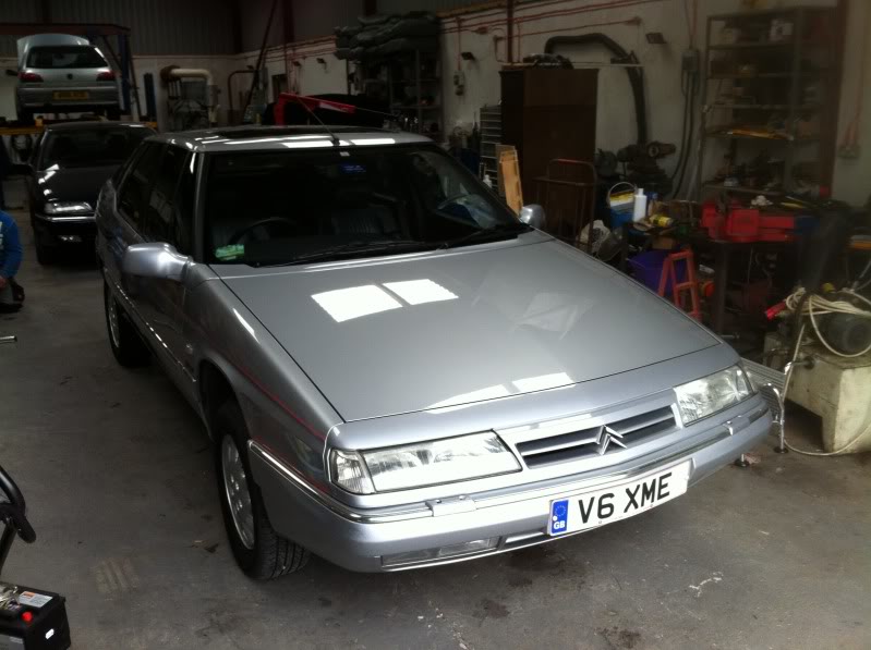

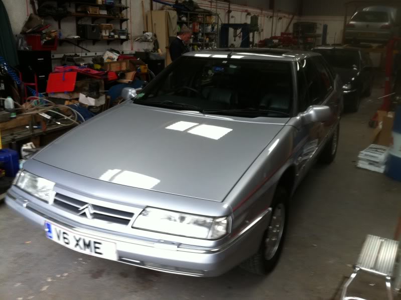

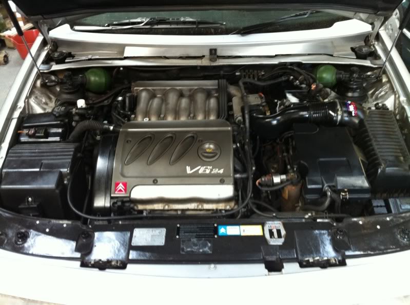

Well after all the hassle and confusion with the water pump I finally managed to get the belt on.
Panicked a little when I saw the cams didn't line up after spinning the engine over by hand.
A big thanks goes out to Jim though for confirming my idea of rotating the cams inside the vernier type pulleys was correct! 15 mins on the lathe and we had a tool as good as the Citroen item.
The new belt is now on, the timing is set perfectly and the car is running as sweet as a nut.
I need to get the car out of the workshop and cleaned but I did find some time to clean the engine bay yesterday whilst it was in the workshop. Apologies for the poor picture, it was a quickie on my phone. Will get some better ones when it's washed.
David.

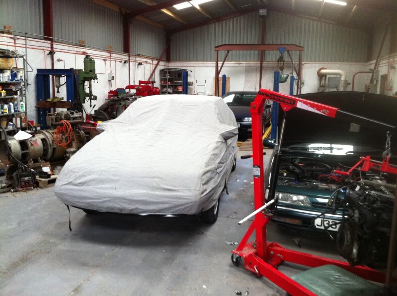

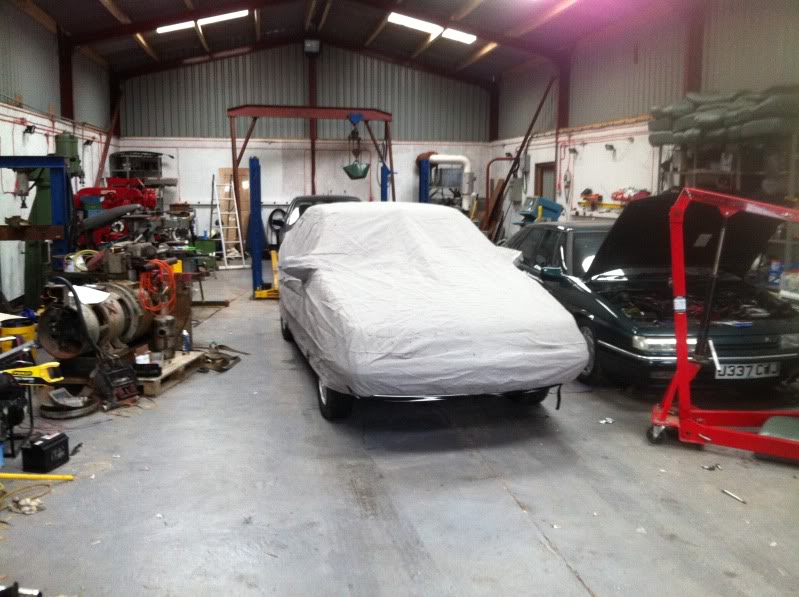

Well I spent today getting my S2 XM ready for the trip to Wetherby today...
Washed the car and then dried it, polished the bodywork, each wheel individually and then every pane of glass inside and out.
Now so that it doesn't get dusty in the shed before Sunday it's got the cover that I bought from Citroenmad over it.
Just got to hope that it doesn't rain between Glasgow and Wetherby on Saturday morning now!
David.
David.

Very good. The big garage is brill now with the temps up? You can stroll around in comfort like a shop chargehand.
Good to see you keeping Dad busy
Need to drop by some time and show him Ser 11 109........saving up for some fuel

The engine hanging on the crane is from a Seat Leon Cupra that dropped compression on the third cylinder... Not the XM!CitroJim wrote:David, I envy that garage![]()
Wish mine was that big....
What's the story with the green XM and the engine hanging on the crane?
I did just buy another 24v XM today though... A Series 1 too!
Well, I say an XM, more like half an XM!! The guys car was rotten... he wanted to keep the engine and box so cut the car in half, scrapped the back bit and kept a hold of the front bit!
David.
