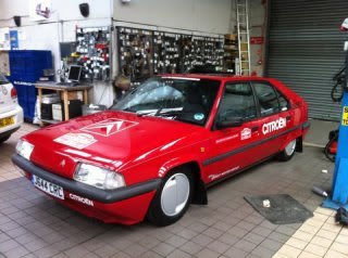

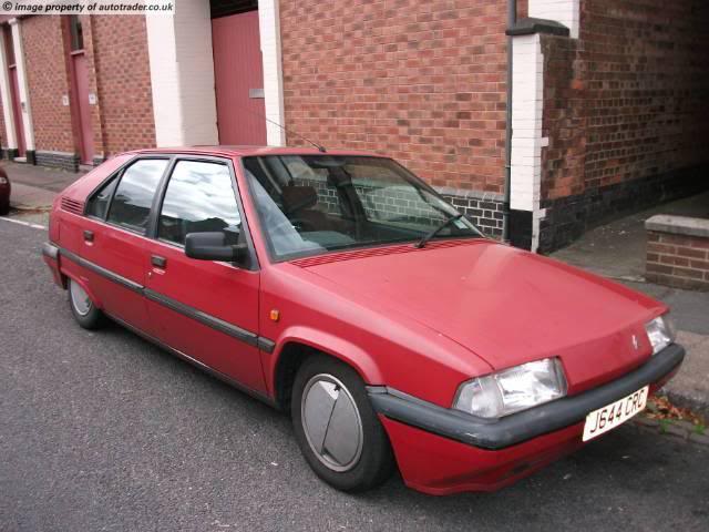

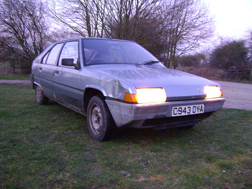

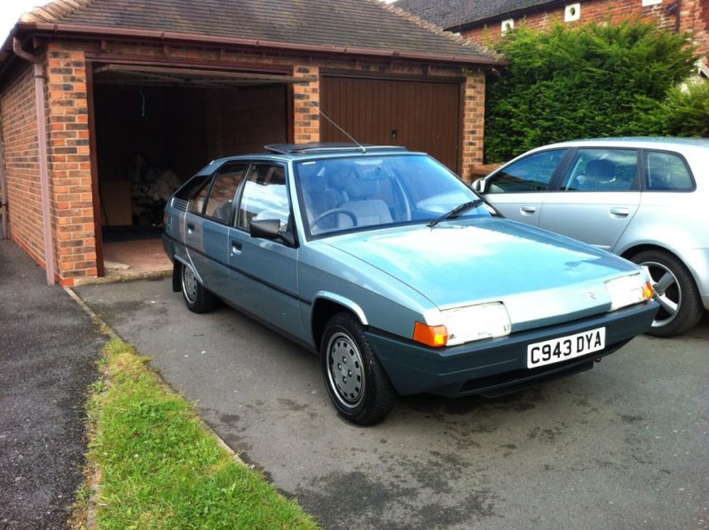

Its been a VERY long time since I updated this
the tatty battered BX 19DTR has gone from
to this!
Also in the last 12 months I bought and sold this (aswell as doing 2300 miles round france in it)
to this
to this!
to this

Awesome transformations Tim....stunning end results
I havent seen you in ages....you going to the CXM?
What did you do to the red one? Re paint, and resto the wheel trims or did it just clean up that way?

Thanks guys, the DTR was at harrogate for 5 days, dont know how you missed it, I was at CXM with the Xantia.
The DTR did have a full repaint but the red TZD was just polished ALOT!!!
