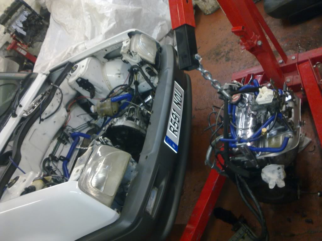

Destroyed the clutch on the van a while back so has been sat in the lockup.

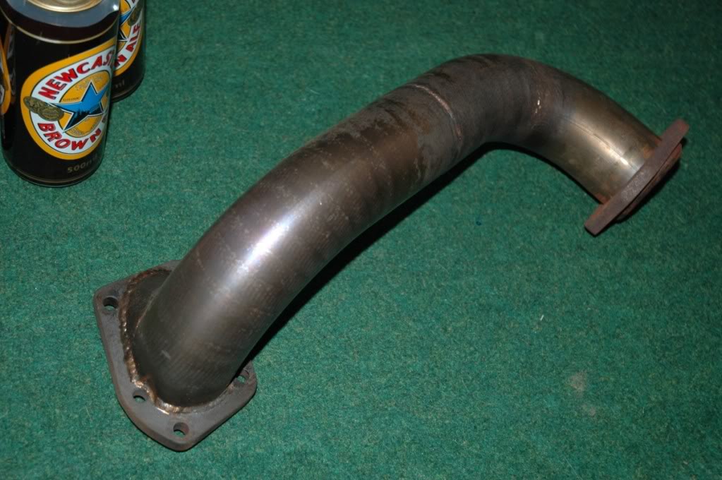

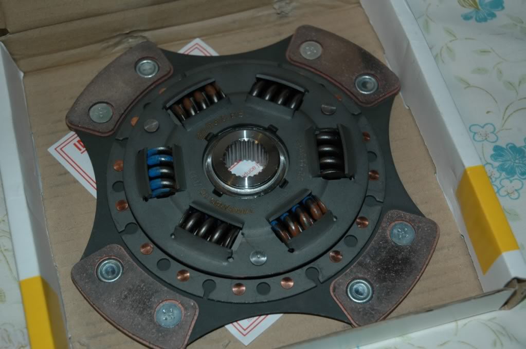

Work commences this week to get it back on the road. Next years goal is 12 sec qtr so have started gathering the relevant parts to make the most out of the current setup..
Ap 4 paddle clutch
Big Jim racing 1 piece elbow/downpipe to replace the nasty stock cast elbow.

My Maestro has a 4 paddle clutch similar to that, but its coming out next year as its such a pain to drive in any traffic and takes the fun out of just 'driving' its. Great for drag strip work as you can get an amazing launch with it, but it you do any significant road driving i would advise against unless there is no alternative.

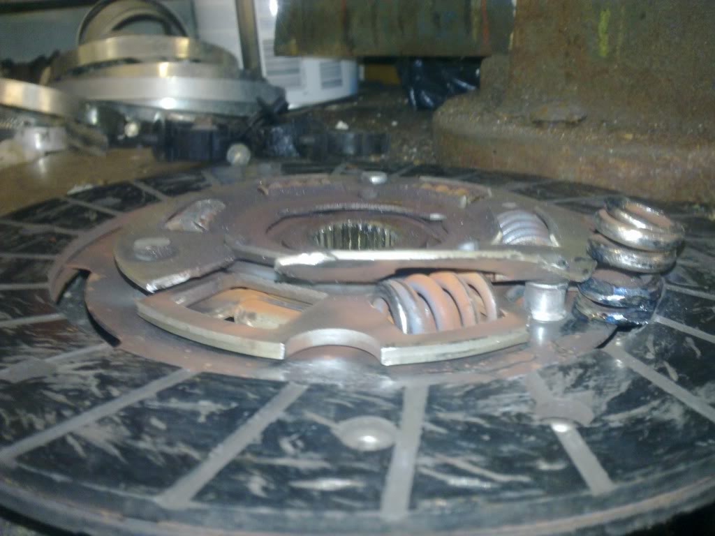

Pulled engine out of the van tonight, found the problem. I can only assume a few hard launches at the pod & epic wheelspin in 2nd gear when setting it up made it fail?
Spring was pointing out sideways on removal aswell thats how it came out. Made no noise when running!
