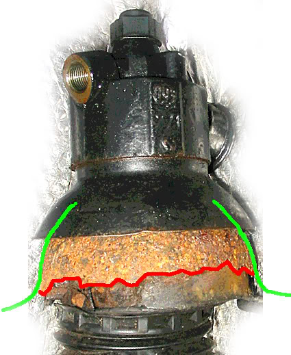

It's simple enough - the flat plate that has the four bolts attached through it to the wheelarch tears away thanks to the rust roughly around the red circumference/collar area. The green line is an approximate cross section outline of the top with the vertical part covering the rubber donut (in grey) that also fatigues and tears.

Thanks for that simple explanation, Andrew - I needed it :oops:. I didn't realise the plate, rubber doughnut and strut top come as a single unit - how typical.
