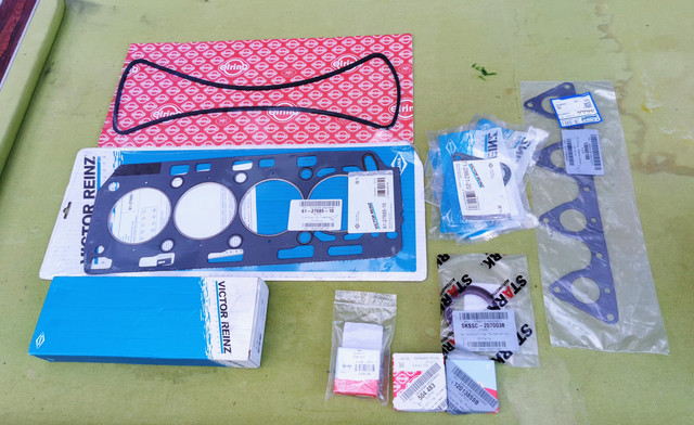

Also the last couple of bits I'd been waiting on for the head gasket job on the Renault are now here. The timing belt kit is already in the boot. So I *think* I now have everything I need for that.

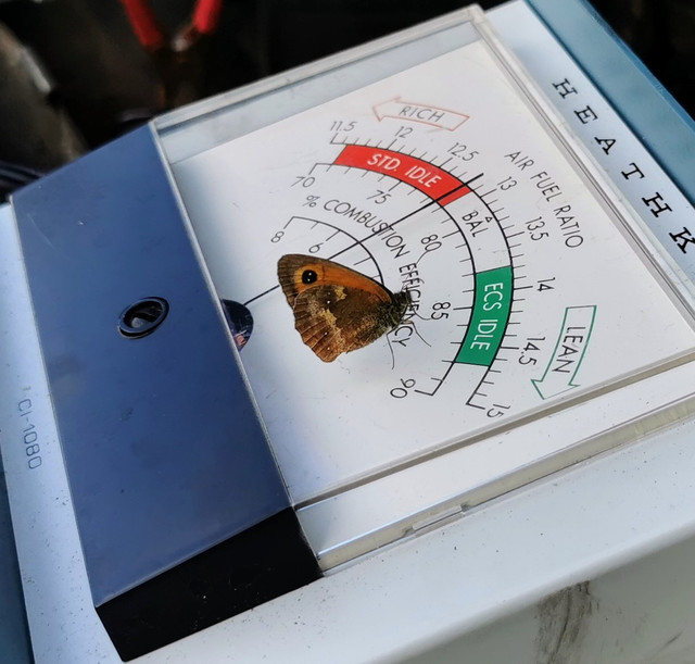

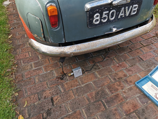

With everything back together I set about trying to dial things in. For what felt like forever. I just couldn't get the engine to idle smoothly no matter what I did with the mixture adjustment. It would clear up around 1000rpm or so, but below that would just get really stumbly. Until I took about 10 degrees of timing out. At which point she immediately returned to a more or less smooth idle. Not quite as smooth as it used to be, but I was clearly in the right ball park.
I'm not sure if the distributor had crept out of adjustment (the clamp wasn't massively tight) or what had happened there, as I'd not touched the timing in a long while.
Anyhow, with that set more sensibly I set about trying to find tune things a bit. While working largely by ear, I figured I may as well use the equipment I had to help see what I was doing.
That seemed to be where she was happiest. Not entirely sure that gauge reads accurately with modern fuels, but it was at least a help in terms of making sure I was adjusting things in the direction I thought I was.
Still waiting for the point where connecting things up this way around stops feeling really odd.

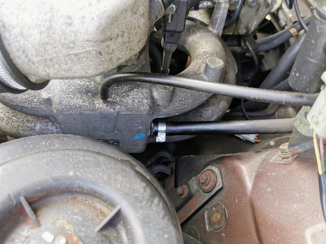

On a similar note I noticed that the wiring loom down to the generator was rubbing against the brake servo at higher revs due to the airflow from the fan making it flap around at one spot so secured that in place so it no longer moves around.
A test run revealed things to be pretty close to back to normal. The throttle linkage needed a slight tweak as it was hanging up a little. I didn't realise you needed to preload it slightly because of how several springs act against each other.

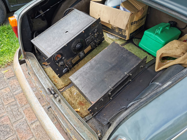

I did pick up a distraction a couple of days ago from a neighbour.

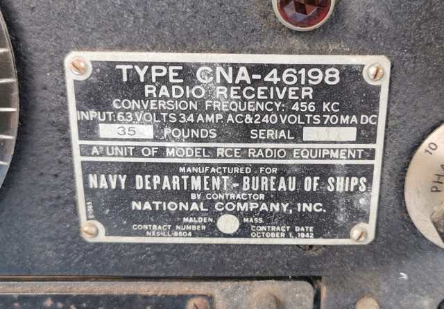

This is a 1942 era short wave radio receiver made by National, including the power supply and a full set of tuning coils.
This was otherwise going to be destined for the recycling bin...so suffice to say I wasn't going to turn it down. It looks to be in decent shape at least at first glance

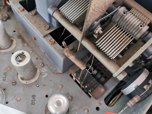

Will obviously need all the wax paper caps like this one replaced though.
I'm expecting this to be relatively simple though, these were pretty well made units so new set of caps and it will likely wake back up as though it was put away yesterday. Should be interesting anyway.

That HRO is quite a find but it's been well and truly got-at over the years. Most of the valves are not originals. B9A and B7G based valves had not even been invented when that particular HRO was built! Back in the day there was a lot of that going on in the amateur world in attempts to improve performance, especially at higher frequencies, and to find substitutes for the original valves which, even in the late 60s and 70s were becoming hard to obtain. I hope the modifications have been well executed, else restoration may be quite a challenge.
You may find it now has a product detector to aid better SSB reception. A popular modification.
Do you have the full set of coil packs? If so, and with it all working well, the old HRO is still quite sought after and can perform well within the limitations of a single superhet. Good luck with it - a nice winter project and a nice change from those vintage laptops!

Zelandeth wrote: 05 Aug 2023, 00:01 This is a 1942 era short wave radio receiver made by National, including the power supply and a full set of tuning coils.
It still amazes me that folks can can come in possession of some that is clearly pretty ancient - eighty years old! - and their first response is "oh well, best get that down to the tip"
Even more nowadays where googling or even image search might tell you what it is, and even if no inclination to do that, slapping it on eBay, Gumtree or even Freecycle might let the thing find a more appreciative new owner. Throwaway Society and all that.
Anyway, good progress on the vehicles - Rover: if you like the way it sounds, I'd leave that intake box off! Enjoy it the way you like it! :)

Apparently they've had it for many years, and have tried several times to move it on recently without success. They gave up on eBay after the fifth person bought it and then "something came up" before they were able to make payment. Other avenues contained similar levels of time wasters and it eventually just became a frustration. Museums aren't interested in it either as it's nothing particularly rare, and they're already generally up to their eyeballs in wartime era technology.
CitroJim wrote: 05 Aug 2023, 05:30 Good work on the Rover Zel, just shows how tolerant the old SU is, still running fairly reasonably with all that muck in it!
Be good to see the Renault fixed and back up and running :)
I believe I've got a full set of coil packs to go with it, all of them from 00 through 7 anyway. Not really surprising to see that it's seen some modifications through its life given the age and that these things would tended to have been used by those with the knowledge and drive to keep them going. The big question with this one I imagine will be if it "ran when parked" in which case a recap will likely get it going, mods and all - or if there were deeper problems which resulted in it being shoved in the loft and forgotten about. In which case I'll probably need to do a bit of reverse engineering. At least that should be relatively simple to do compared to some of the nonsense I've been messing with lately...

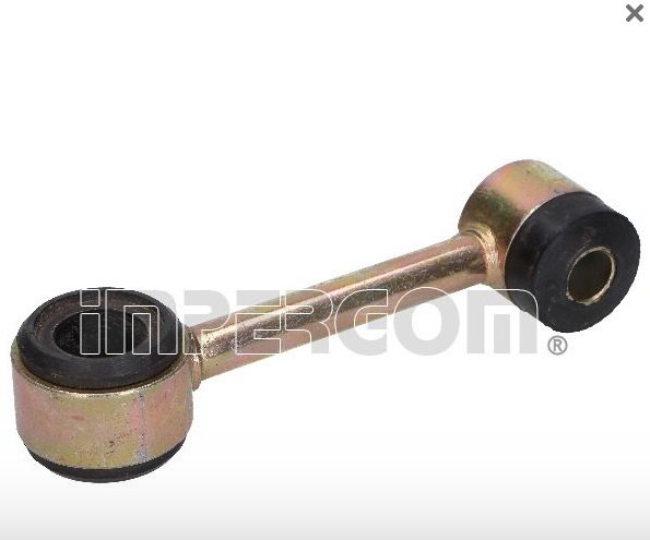

There are three things which need doing (that I know of!) in the immediate future for the Renault. The head gasket is an obvious enough one and assuming that no absolute horrors are found when the head is removed should be relatively straightforward. Just keeping my fingers crossed the head hasn't gone porous or anything maddening like that. Second is a bit of welding in two spots. One is to repair some rust around an area that was damaged clearly some time ago by improper jacking, and some more on the inner wings where the seam sealer has clearly failed and trapped water. I think I've managed to find someone to do that now. Third is something which has been on the to do list since day one, and that's that it still needs a set of drop links. I'm still as unable to track down a set as I have been since day one. The issue here is that there are three different types which were used on the 25. One on the V6 (which is readily available) and some sources say the automatic, one for the lower power version of the 2.0 engine (which I have found one or two of in Germany), and one for this variant. Which appears to be completely extinct. The part I need is 7700766869. Which most websites tell you is compatible with 7700781498 - the V6 version. They're not...they're completely different. The latter part is a good 20mm longer and has the two ends pointing in totally different directions to the correct part. It doesn't help that when you try to search for part numbers for anything on Google etc now about the first 300 results are just repeats of Autodoc trading under about a thousand different names - which gets really old after about the first ten times you've clicked on results to find the same page saying no stock with a slightly different header at the top of the page. Alternatives are RTS 97-90477 or Imperium 31561. Searching for the latter of those is further frustrated as that's a valid Febi part number for something completely different so that saturates the search results. I'm sure there were probably a dozen other smaller companies who made third party parts that were compatible back in the 90s, and equally I'm sure someone somewhere still has a bunch of them sitting on a shelf somewhere. I've been digging on and off since December last year for them though without any luck. It's such a stupid, simple consumable to have turned into such a long term headache.
This is the thing I'm after.
So the solution is most likely going to involve having to try to extract the existing bushes sufficiently intact to ascertain their correct dimensions and then obtaining new ones from here and re-stuffing the existing links. I'm just extremely thankful that they're bushed on both ends rather than having a ball joint on one or both ends as with a lot of cars as if that were the case I'd probably be well out of luck short of trying to put something together using rose joints and adjustable linkages from a racing supplier most likely.

On the HRO, dry out the mains transformer very thoroughly before applying power. It may have absorbed moisture over the years of inactivity. A recap of the critical ones will be in order but don't go mad until you have some life out of it. I'm not a fan of mass recapping - it's a great way to introduce unintentional faults that take a lot of head-scratching to find... Replace the audio output valve grid coupler and any tone correction caps around the audio output transformer by default but all others can be left until you find the need. Get it up and working, however badly, before replacing anything willynilly. It'll soon tell you what does need to be replaced 😉
Powers it up... Pop whee! "OK, that valve that is now embedded in the ceiling needs replacing. Does anybody know what it was before it launched itself out of there?"

I have had a mains reservoir electrolytic capacitor can launch itself with enough force to put a visible dent in the ceiling once. There's a good reason not to stand over a device under test!
