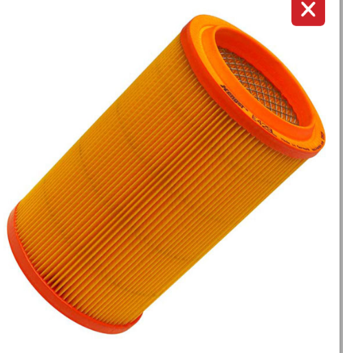

Depending on the dimensions, perhaps you could convert it to the cylindrical filter as per 306 XUD (would need the central rod extending and a new "cap" to seal the end
Picture from Eurocarparts / Google
