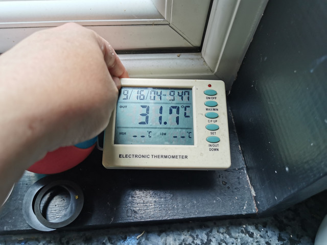

I do not handle heat well. Anything north of low 20s C, I'll be hiding in an air conditioned room please. I'm from Aberdeen. I wasn't built for heat.
Perfect day for working on a car then.

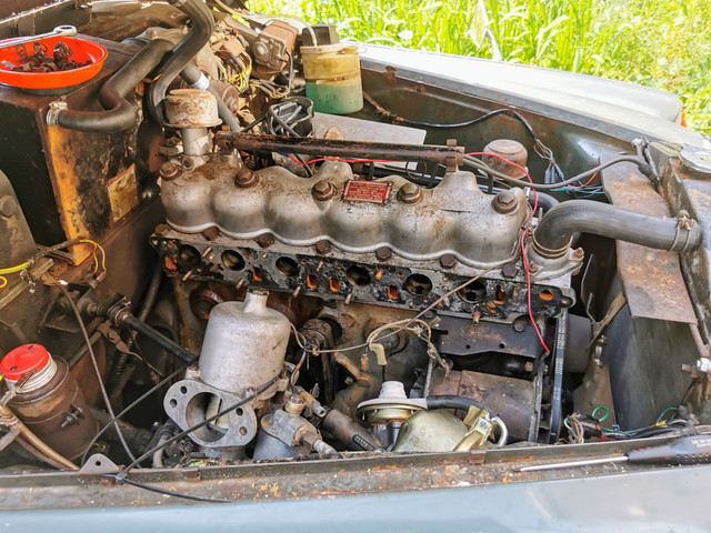

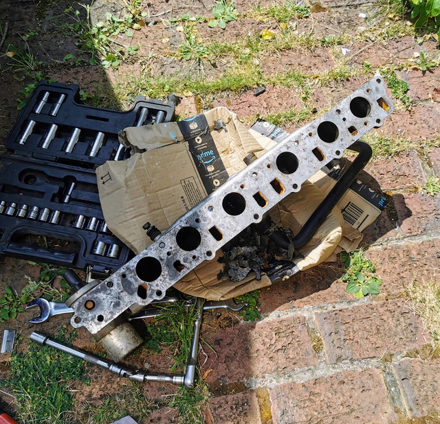

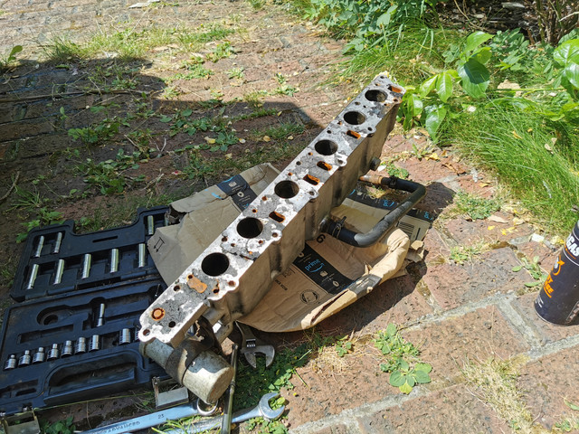

Simple enough, couple of the nuts on the underside of the manifold were a bit of a pain to get to, especially the one directly above the generator, but nothing too bad. Helpfully all those involved are sizes which match metric, so I could use the less clunky tools.
The front lower nut holding the carb onto the manifold though still tried my patience. I really need to get a stubby spanner for that one as the brake servo and it's bracketry gets right in the way.
Thankfully everything unscrewed without any protest - I was slightly concerned about the hazard of studs breaking, but no worries there. About a third of them unscrewed from the head rather than the nut coming off, but I'll take that over a struggle any day. I kind of wish they had all done that as it would have made scraping the gasket off a heck of a lot less fiddly.
My theory was that the gasket had failed around the rearmost lower coolant passage, so finding this was a bit of a morale boost.
What then followed was the best part of two hours of scraping.
Shown here at about the 80% stage I think.
Obviously I dug as much of the gunk out of the head and manifold as I could, but there really wasn't much to be honest for a car of this age. Few bits of flaky crud, but nothing too bad.

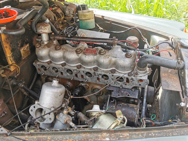

I was originally planning to leave it ready to put back together and call it a day today. However then bloody mindedness, mindless determination, stupidity (delete as you think appropriate) took over.
Roughly an hour later.
I reckon at least half of that time was spent bolting the carb back on. That one nut is absolutely incredibly fluffing awkward to get to.

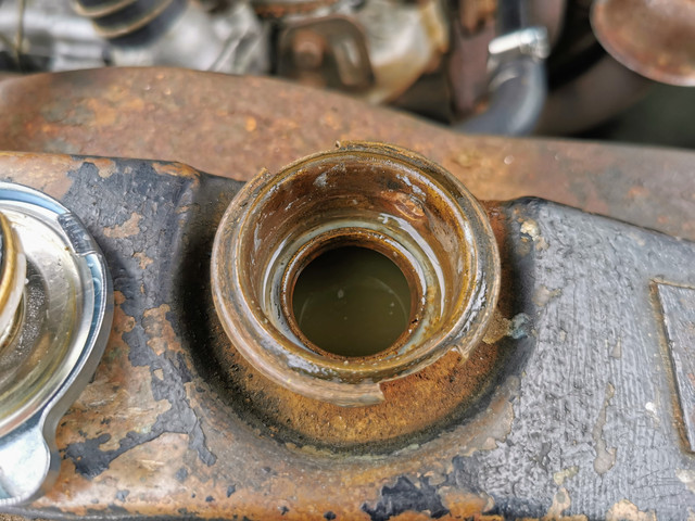

I got everything back together and had time to get the cooling system bled, up to temperature and a quick test run round the block.
Result?

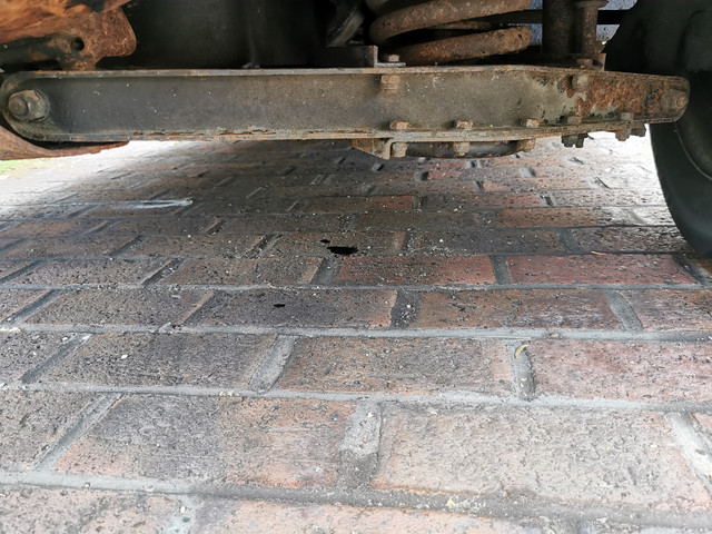

I'll take that. We had two oil leaks pretty immediately evident. One (which you can see there) was from the filter housing retaining bolt on the oil filter.
Which after being tightened up a smidge further seems to have stopped.
The other one is I'm 90% certain is just coming from the rear of the exhaust valve tappet cover which I'm waiting on a new gasket for.
After the car had been sitting for about 15 minutes there was one drip from the rear of the engine which looks to be oil rather than coolant - and on a 60 year old Rover I'll call that entirely acceptable I think.
We'll only really be able to tell properly after I get the car out for a proper run, but initially things look hopeful at least.

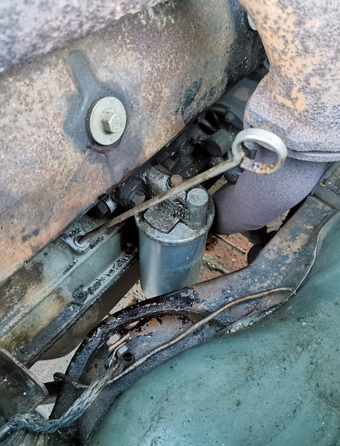

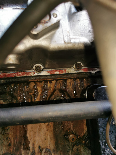

Had the Rover out this afternoon for about an hour or so of bumbling around running errands.
Good news, it's no longer peeing oil everywhere now the oil filter housing bolt was nipped up. It's also no longer peeing coolant out.
There is however still a coolant weep in that general area - it's not enough to be an issue I reckon as the amount of scale in the general area suggests it's been weeping for years if not decades. Plus before it started pouring out of that blown gasket there didn't seem to be any excessive water usage.
Pretty sure the only reasons we would be seeing water creeping out there is either a crack or porosity issue in the block. I can't *feel* anything, but the water appearing there (it never actually drips, even after the engine is stopped) tells me there has to be something there.
Given this is a wet liner engine and has a cooling system capacity somewhere in the region of 15 litres, so provided the loss doesn't become an issue from either a manageability or environmental standpoint I'm just not going to worry about it. Doesn't strike me as the sort of issue that's likely to suddenly get worse overnight. Just keep an eye on it I reckon.
Couple of folks have pointed out that this is exactly the sort of engine and sort of issue that old school Radweld was really designed for...I mean it's not like this thing has a microchannel radiator or anything like that like on a modern car for it to clog up.
I usually run a mile from the stuff, but then again that's because I've usually been trying to dig it's residue out of 80s and 90s cars where someone has stuck in stuff like that to try to fix a totally stuffed radiator or water pump...this is a slightly different animal.
PS. Yes the sealant is a horrible mess. It was so hot that it was basically setting the moment it touched the metal making it really hard to get as thin and even a layer as I wanted. I used a bit because the bottom of the manifold was quite pitted in a few areas so figured it was warranted. It's tidy up top where you can see it...I didn't have the patience to get in there with a rag and solvents to clean underneath the manifold

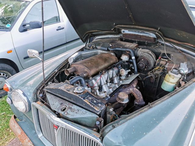

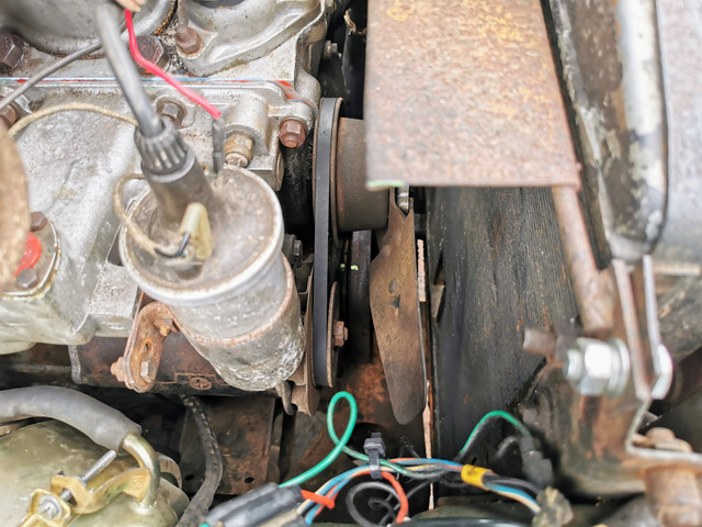

Something I'd been wanting to check on the Rover was the timing, especially since I'd had the distributor off and had set it back using naught but Mk I Eyeball and confirming it sounded happy enough.
The actual timing mark on this engine is on the flywheel according to the manual...not interested in even trying to see that.
Number 1 plug out, use a screwdriver to show me when the piston is at TDC, then out with the paint marker.
Things are correctly lined up when viewed in line with the edge of the fan shroud.
Yes that's the outside of the harmonic balancer (no idea if it's got a rubber damper in), but we're not using this to set up anything critical - I just want to see what it's set to, confirm the mechanical advance is working properly and tweak it a bit if need be. It's not like I'm setting up the cam timing after having the engine apart or anything like that.

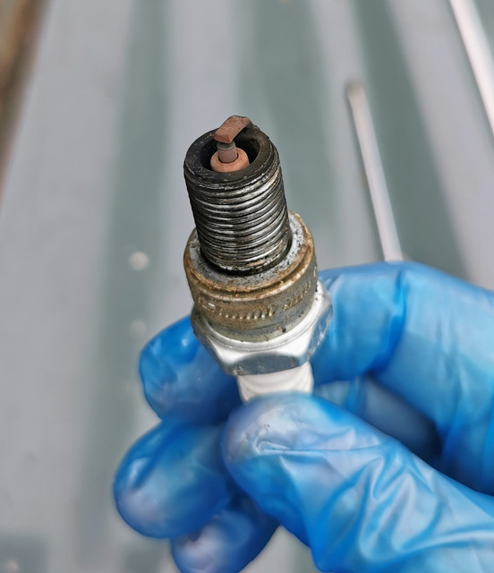

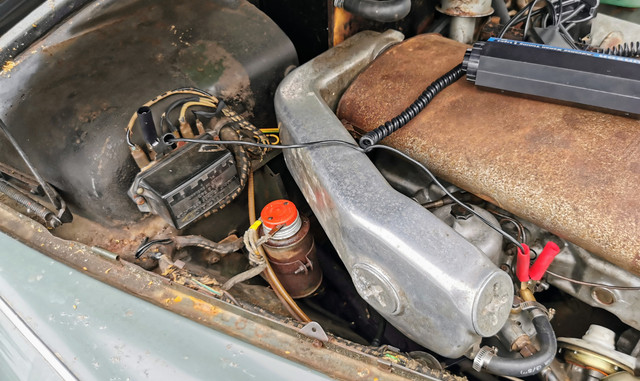

This is what the plug looks like. Seems healthy enough to me.
Hooking these leads up this way around felt so, so wrong.

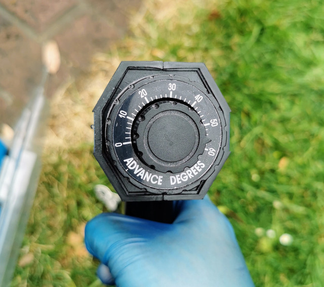

This is where I ran into problems. Specifically that my timing light appears to have died. It's still firing, but the advance control does precisely nothing.
The shown timing is all over the shop too... though that seems to be the equipment rather than the car. I checked the Renault too for reference and it was similarly showing me to have just over 60 degrees +/- 20 advance at idle...which I know is utter nonsense.
I know I have another older, better quality timing light buried in the garage somewhere - however the where is a very valid question! Of course this is exactly the sort of job the Sun motor tester would be ideal for if it were within range of the garage rather than still sitting in my conservatory. That would let me see what the dwell angle is as well and if it's stable - which given how smoothly the engine idles I reckon it must be.
I'll see if I have a chance to have a rummage later in the week and will take another look if the other timing light turns up. Just irritating when tools you've only used a handful of times go faulty. I'll obviously pull this one apart and see if it's fixable - if it's just the potentiometer having gone open or something like that it shouldn't be hard.

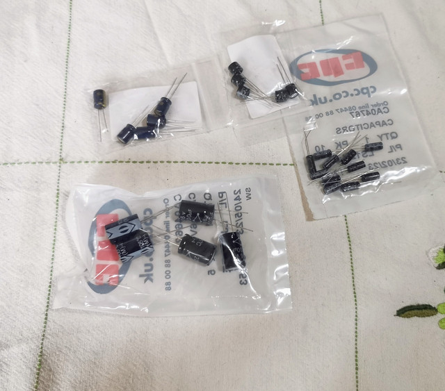

The capacitors I ordered a couple of days ago for the Toshiba T1600 arrived today...in a far, far bigger box than I expected. Turns out I made a bit of a silly blunder.
This is what I was *expecting* in the delivery plus a bottle of contact cleaner.

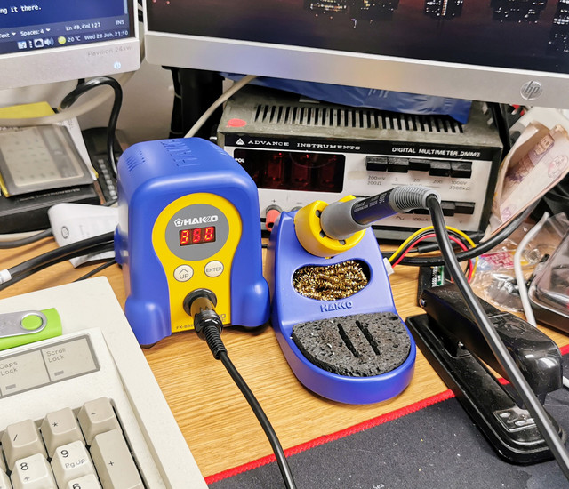

Last time I was working on one of these computers I was lamenting my lack of a decent soldering station (again). So was looking at a few options - and had stuck what basically seemed to be the yardstick to which most of the options were being compared in my basket on CPC so I didn't forget what it was.
Yeah...it was still in my basket when I checked out yesterday wasn't it? And I just clicked through the checkout screen on autopilot as it's a seller I use all the time and it was just a few quid worth of caps.
So in addition to the caps this was also in the box.
Oops.
Oh well, that's one way to make the decision for myself and stop procrastinating about it!
