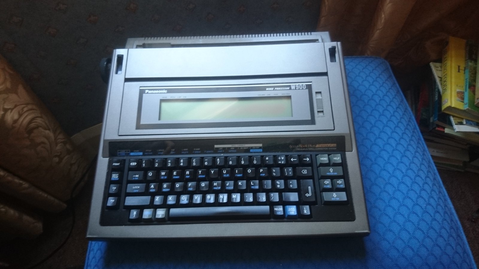

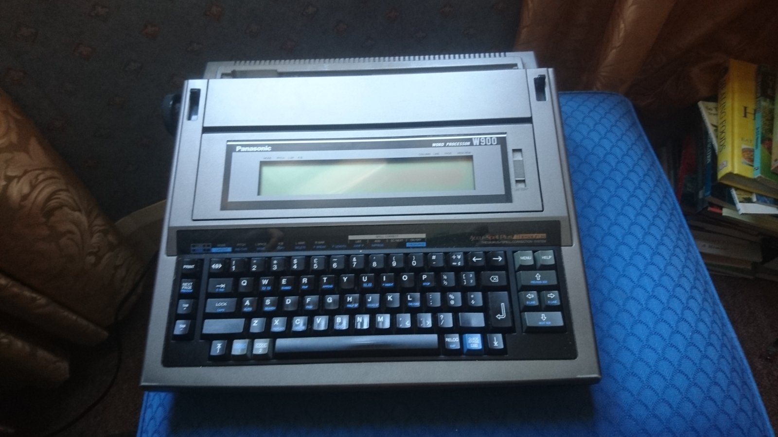

If this interests you Zel, it works, £40 would see it in your collection!! :)
Panasonic WP
Panasonic WP

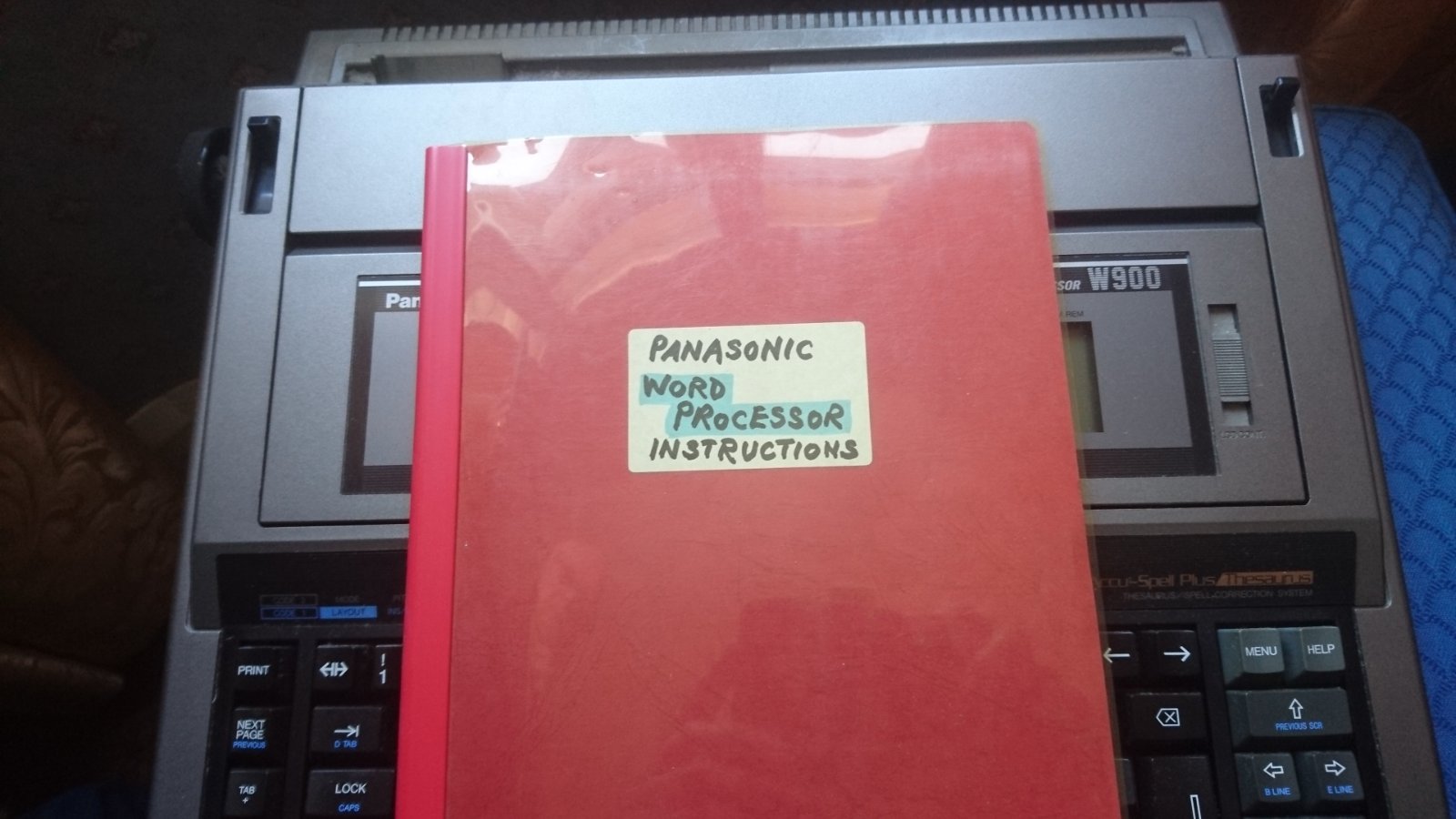

Instructions

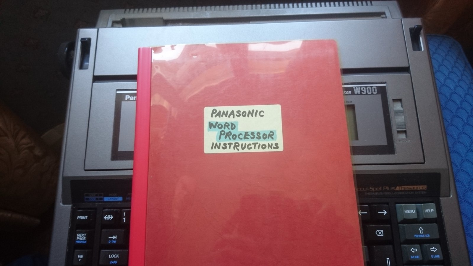

Instructions

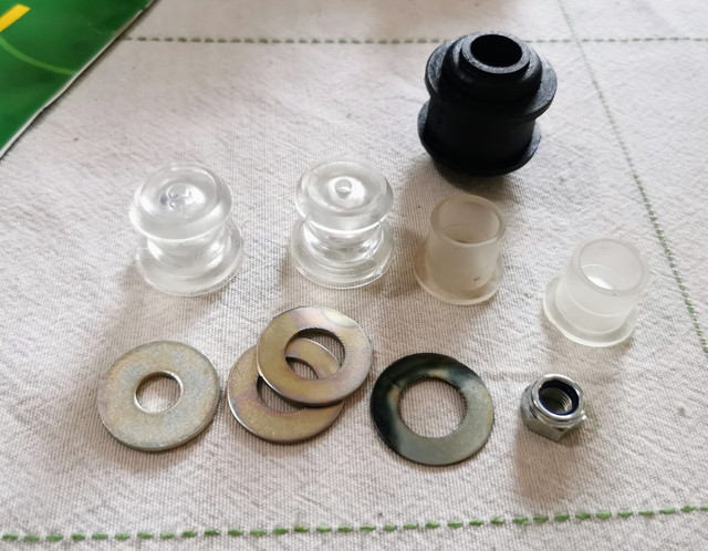

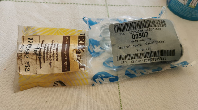

Something finally arrived yesterday. After a long fight trying to find one, wound up with two sources turning up together.

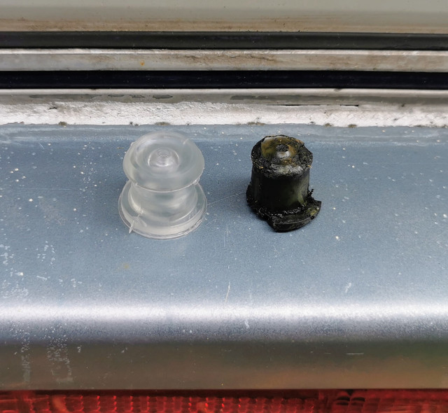

The contents being this lot.
Which I was finally able to confirm indeed does include the necessary replacement for my knackered gear shift bush on the Renault.

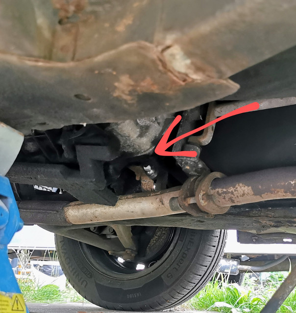

Which needs to go here.
Which is as far as I got today. The bush it turns out is made of a really very firm material and I've nowhere near enough strength to get it either onto the ball joint it is meant to sit or to get the outer part of the linkage over it. All I've succeeded in doing is bruising the heck out of my right hand trying.
It's the sort of job I'd normally say "just use a press" for - but when one end is a component part of the gear box that's not so easy. Next plan of attack will involve a G-clamp and I'm sure a good deal more swearing.
Will be rearranging things a bit too as both the jack and axle stand today were positioned in exactly the most annoying location possible...both to be absolutely in the way, and for the bush to manage to bounce and roll under the axle stand just about every time I dropped it. Which caused a lot of swearing.

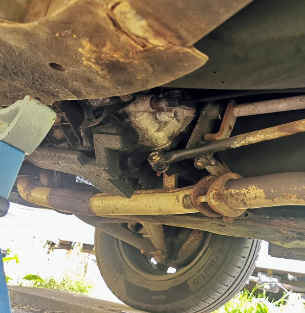

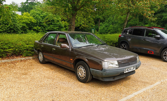

That is one tight fitting bush, but eventually got it to cooperate.
This involved using a G-clamp to force it into place on the linkage itself, then again to pop the whole thing onto the ball on the selector assembly. The former was definitely reaching the limits of what I could muster in terms of strength, but got there in the end. I guess at least I know it's not coming out of its own accord.
I have loosely looped a cable tie around the upper selector rod as well just so if that bush should fail again in the future the linkage will be caught before it hits the ground.
Proof the car has actually moved today for the first time in well over a month.

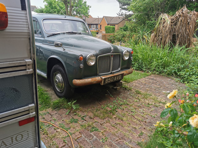

The Rover has also moved - into the "bay" which is reserved for the patient currently undergoing treatment.
I'll get stuck into pulling the head later on in the week.

Excellent news on the Renault Zel :D

CitroJim wrote: 19 Jun 2023, 05:23 Excellent news on the Renault Zel :D
Now there's just the small matters of getting the welding it needs done and finding a solution to the drop link issue before the MOT runs out next month...no pressure!

I was thinking the Renault was Tax and MoT exempt Zel... Then I looked at the registration plate and see it's got a year or so to wait yet :(
I'm sure all will be good :)

CitroJim wrote: 19 Jun 2023, 14:07 I was thinking the Renault was Tax and MoT exempt Zel... Then I looked at the registration plate and see it's got a year or so to wait yet :(
To be fair it's just a matter of finding someone to do the work. Especially as a lot of folks seem unwilling to get involved in work which is likely to total a significant portion of the value of the car. We know that sort of boring logic isn't in play with this car though, it will get whatever work is needed done.
The damage around the chassis outrigger I could probably manage myself as it's a pretty straightforward repair. It's pretty clearly damage from the car being improperly jacked there and corrosion which has just happened around the damage rather than awkward long term corrosion. Plus being buried well under the car nobody is ever going to see it, so if it's not pretty it's not the end of the world (and trust me, my welding is not pretty!). Sorting the inner wing seams though needs a bit more finesse, as that's both a more complex shape to work with and is visible when the bonnet is open.

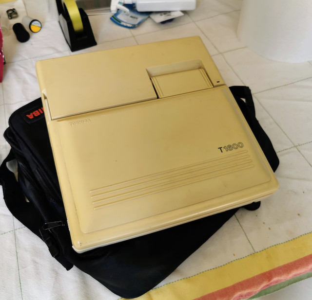

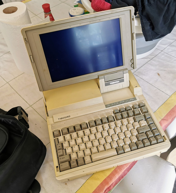

In other news, oh look another one!
While I've not actively been going looking for anything lately, I do have a few saved searches set up on eBay, and "Toshiba T1600" is one of those as I'm still trying to get hold of a working example. This was listed with a buy it now price of £30 - so I immediately pounced on it. If you're even vaguely familiar with the market for this range of machines these days you'll know is even in non-working or "untested" condition is silly cheap.
This basically continues the ever increasing count of "how many do I need to buy before I find one which hasn't been blown up?"
The seller in this case seems to deal mainly with antiques and house clearance items, with very little by way of electronics at all in there. So maybe this one *will* actually have escaped the usual fate of having been plugged in and blown up.
It certainly doesn't have the usual smell of suspiciously fresh magic smoke which usually (read: almost invariably) accompanies one of these machines. So time will tell I guess.
While it's filthy, the case seems to be free of immediately obvious damage and the display looks to be in good order (these are prone to fading similarly to the ones on the T1200) so at the very least that will be a nice spare to have.
There isn't much wear on the keyboard, so I don't think this has a massive number of miles on it.
So expect to see some further carnage at some point in the next few days when I get time to tear into it. There's quite a lot of that involved here as getting the power supply board out of the T1600 is way more involved than on the T1200 where it's literally a ten minute job, as the T1600 is far more densely packed under the cover as this really was a machine that was pushing the limits of what could be done at the time.

Fingers crossed the T1600 can be brought back to life Zel :)
I remember those as quite special...

CitroJim wrote: 20 Jun 2023, 04:16 Fingers crossed the T1600 can be brought back to life Zel :)
I sat at a table in a filthy cafe in Northern Athens in 1991 using one of these. It gathered a few curious old chaps at the time.
