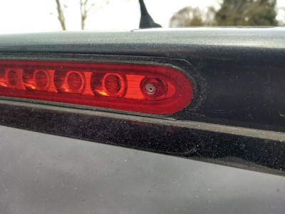

Although it's impossible to see, I could get a finger in and it was definitely set around the brake light. I undid the nuts, but it still wouldn't come out easily - a look at the unit on eBay seems to show a sort of foam seal, and a couple of clip type protrusions on each side. I guess some 'gentle' persuasion would have popped it out. However given that the seal is not available on its own, and I wasn't forking out £100 for a new light, decided I might as well seal it in. Out with the masking tape...
(Supposed to be a pic here, but phone decided not to save it...)
Sealed it round with the black silicone, see if that stops the water coming in!

Sealing looks to have been a success, sealant only just visible if you look closely.
Trim refitted so it's bound to leak again now!

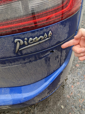

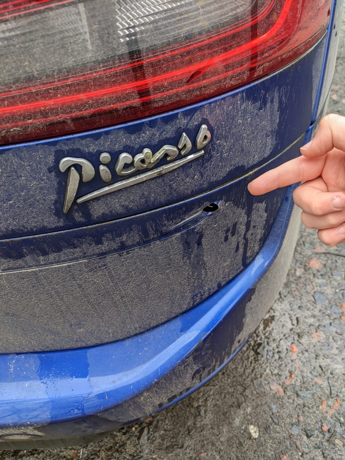

Plastic repair needed
Gate Vs car, gate wins! Punched a hole right through. I think replacement of the panel easiest if I can get a used one the right colour. There's a moulding line it's right in the middle of which will be tricky to replicate.

A motor trader would find a badge to fit over the hole, it does the job and invites questions from the curious.
- Posts: 54716
- x 8161
Re: Confessions of a Citroholic
That's a good way of hiding itGibbo2286 wrote: 19 Feb 2023, 09:57 A motor trader would find a badge to fit over the hole, it does the job and invites questions from the curious.![]()
Or perhaps insert a dummy reversing sensor...
