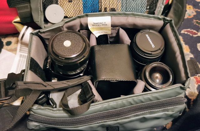

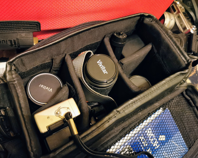

Bag number 1.

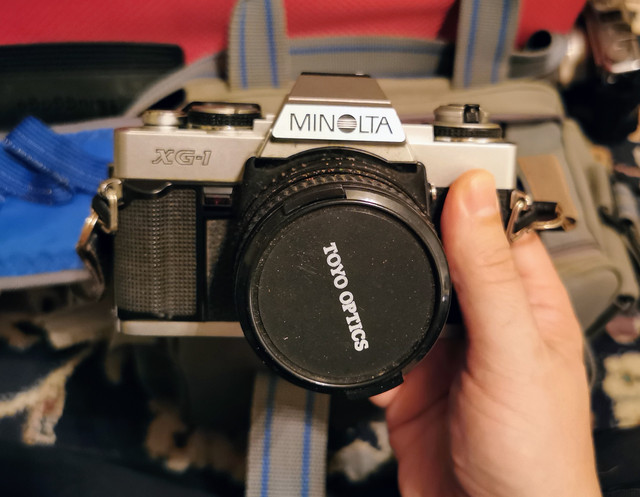

Minolta XG-1, a slightly more modern light meter, matching flash and some lenses. Toyo 28-75mm, Minolta 50mm, Toyo 28mm, and an 80-200mm I forget the maker of.

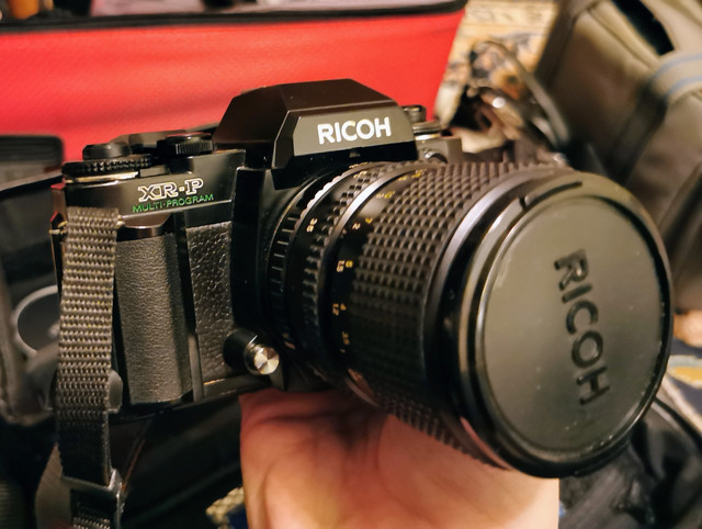

Bag number 2.
Ricoh XR-P & lenses. Ricoh 35-70mm, Soligor 24-45mm & a Vivitar 70-210mm.

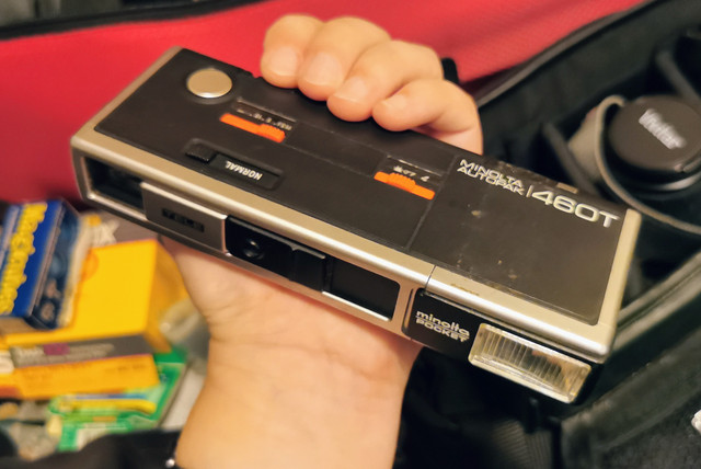

Oh, and this Minolta Autopak 460T which got stuffed in this case because it fit there.

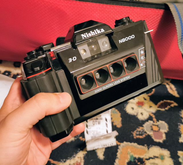

Now isn't this a wonderful contraption?

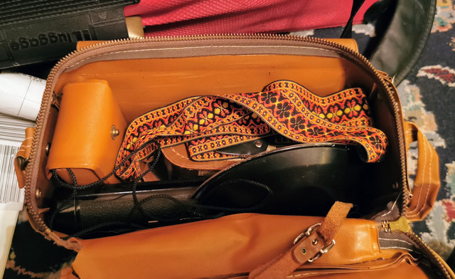

In the case are also a period flash gun, light meter, and probably most useful for some of my other cameras, a standalone rangefinder.

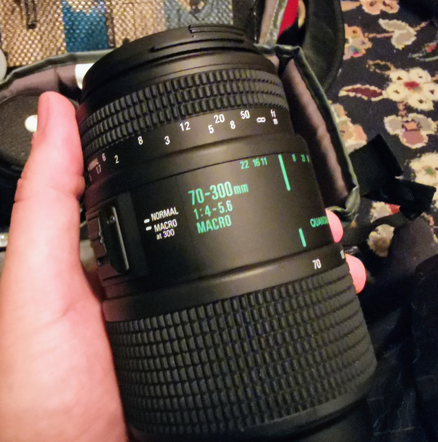

Somewhat battered looking Minolta 7000i and lenses. This one was probably the most immediately of interest as even if the body in there was useless the rest will all work with my 7000 anyway.
Especially this.

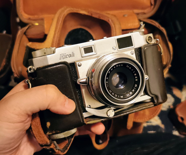

Which contained this very clean looking Ricoh rangefinder and various filters and adapters.

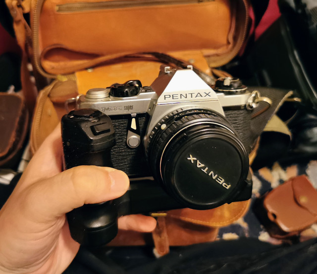

There was quite a bit of space in there so it also became home to a Pentax ME Super.

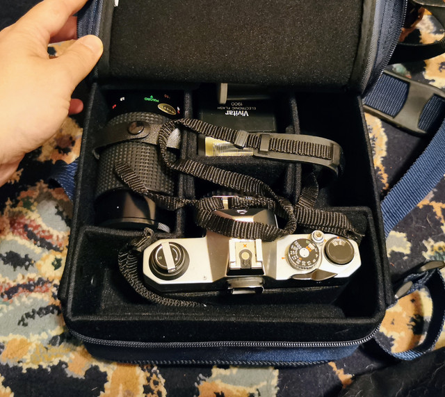

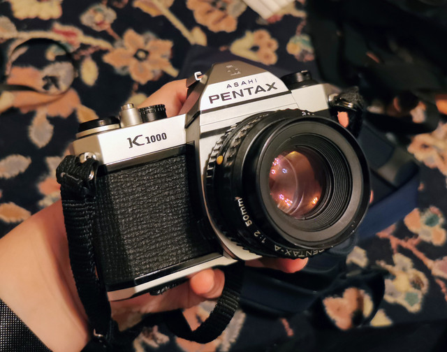

More Pentax, a K1000 this time.
Along with 50mm and 80-200mm lenses and a matching flash.

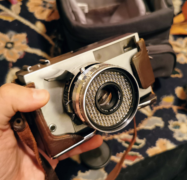

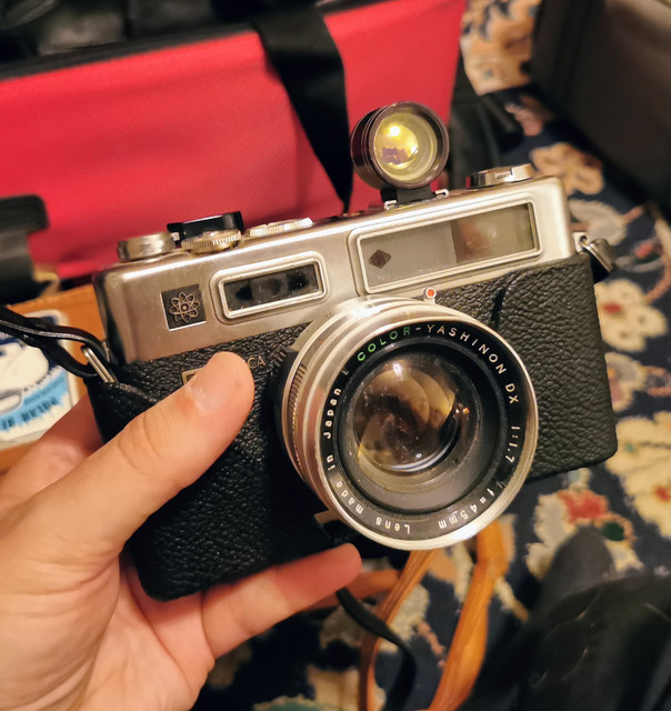

This oddball thing just for the sheer obscurity factor.
I can't for the life of me remember who made this one. Yes, I did remove the add on viewfinder for safe transport.
Edit: Have checked and it's a Yashica Electro 35.

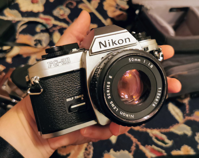

Finally...I think, a Nikon FG-20. Which feels really tiny compared to many of my SLRs.

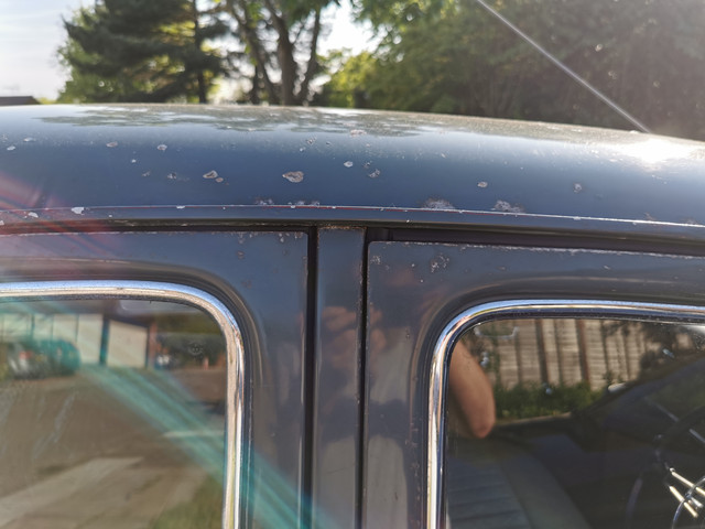

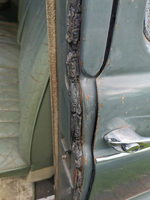

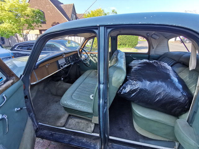

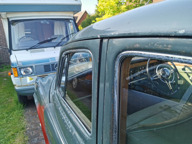

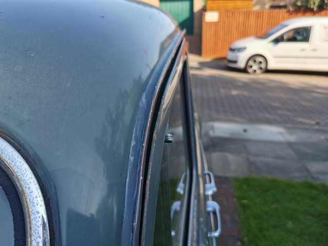

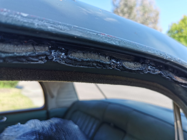

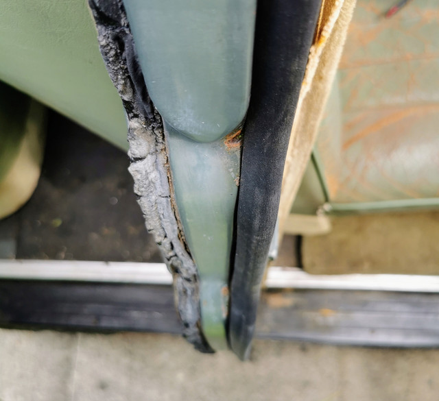

Spot the difference.

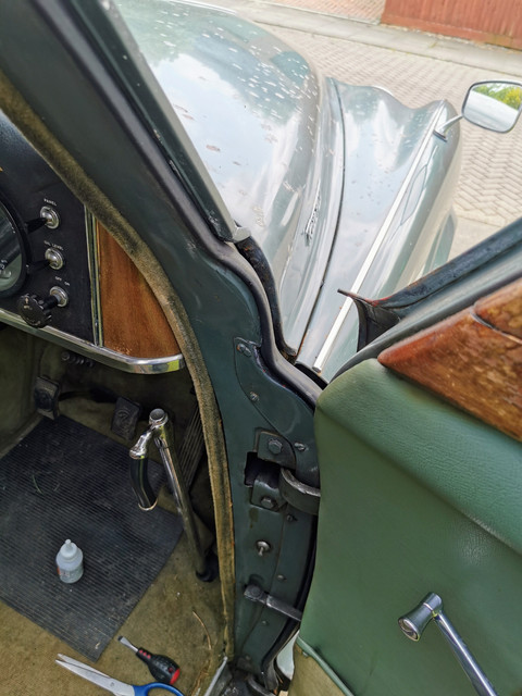

First new door seal is in. Looks a bit healthier.
One down, three to go. You can still see a little daylight around the top of this, but it's far better than it was. The wind noise is still there, but has been reduced by several orders of magnitude.

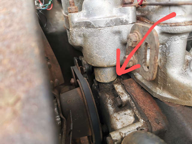

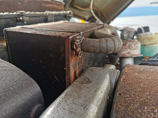

I did notice when getting back from the test run I could smell a bit of coolant, sure enough it was dripping from the hose to the heater matrix.
The staining there suggests it has been for quite a while. The hose actually just pulled straight off as it had compressed so much under the clip. Lost about 50ml of coolant changing this as it's the highest point in the system and the leak was positioned such that it had let the water drain down into the rest of the system.

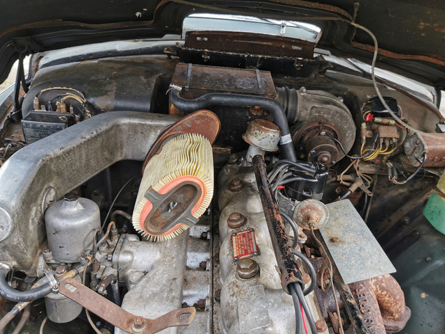

I've noticed that she does have a bit of a miss now and then, especially when cold. While the surprisingly good impression of a V8 burble at idle might be amusing on the right car, it needs sorting. Investigation has shown that we have a really weak spark on no 1. Which is interesting as I know the previous owner has already done some fault finding on this. We seem to have an absolutely solid spark at the other five cylinders (my eyes have just about stopped spinning from checking that), however removing the plug for no 1 at idle when cold does nothing. Removing the bakelite lead holder entirely from the equation (as they have a tendency to go electrically leaky) we still have a very poor spark from that HT lead. So it basically has to be the lead itself or the distributor cap I think - that's the only thing not shared with other cylinders I think.
Ran out of time today, but hopefully that will be pretty simple to sort as there's only so many variables involved.

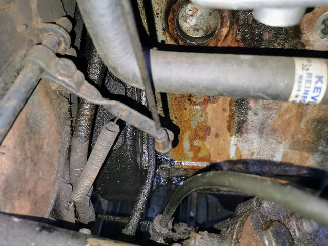

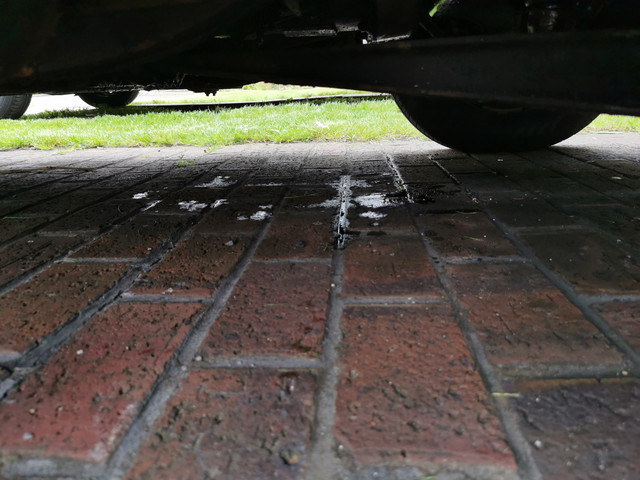

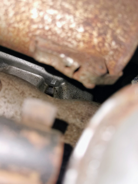

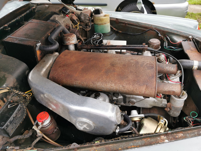

Also noted this when I got back from a run this afternoon.
That's oil. Quite a lot of oil. Not quite as much oil as the Jag used to mark it's territory with, but close. I was initially concerned this might have been coming from the rear main, but I'm not so sure now. I'm not expecting this car to ever be 100% oil tight, but that's a little much.
There's definitely evidence of quite a lot of oil running down the right hand side of the block towards the rear.
Also oil having visibly pooled on top of the inlet manifold in the same area.
I'll need to remove a couple of things to investigate though as that side of the engine bay is rather busy.

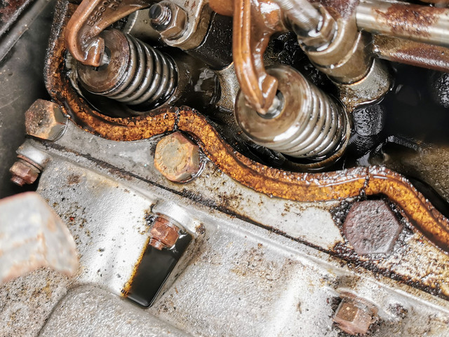

Wondering if it might be something as simple as a wrecked intake valve cover gasket given it does look quite well squished where I can see it towards the rear. No idea when the valve clearances were last checked anyway so would definitely not hurt to check those anyway. Helpfully one set need to be done stone cold, the other at full operating temperature.

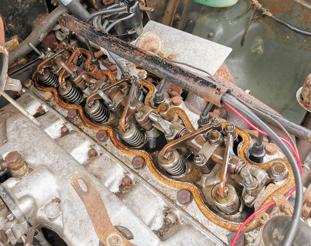

Had a spare half hour today after the rain had moved on so set about investigation of the oil leak.
A full top end gasket set is on the way, but I'd like to get a better idea for certain of where this is coming from. The gasket set includes everything needed to do the head gasket - which I'll likely need to do at some point to deal with this somewhat crusty looking O-ring.
My initial reaction there is "surely it would be easier to remove the water pump..." But apparently they're renowned for snapping bolts, so the head is probably the lesser of two evils. Plus I don't know for certain if you can actually manipulate things into position when slotting the pump into place. I guess the assumption would have been that back in the day you'd have the head off relatively regularly for decoking anyway - obviously less of an issue with modern fuels and oils. I'm not going making work just now though, I'll deal with that seal when it becomes an issue or when we can include it with other work.
For now we're after the (primary) oil leak. I'm sure there are several, but there's only one actively making a mess right now so I'm concentrating on that.

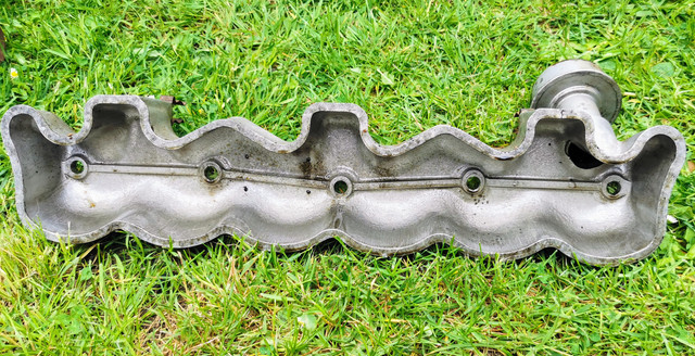

I'm kind of used to when dealing with engines of this sort of age which haven't been meticulously looked after taking off the rocker cover and having to hunt in among the slime and tar to try to find the valve gear. So was pleasantly surprised when this was what greeted me.
I'd be happy finding an engine that's ten years old that's that clean.
Unsure whether this was the cause of THE leak, but it definitely can't have been helping anything.
Three very clear splits in the cork seal there.
I've done a bit of a bodge to see if I can improve that until the new seal arrives.
Absolutely is not a fix. I'd just like to see if the leak is at all reduced before the seal kit arrives. Stripping things down to this stage takes all of about ten minutes so it's no huge hassle. Just waiting overnight for that sealant to set before I give it a test.

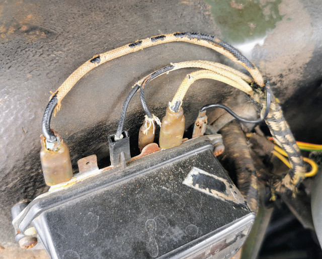

Did spot one little bit of work for the weekend though.
Note the bits of bare copper visible. Especially on the larger wire to the left - that's connected directly through to the battery negative, maybe via a fuse if we're lucky. Yeah I think I'll be deploying a bit of heat shrink tubing there.

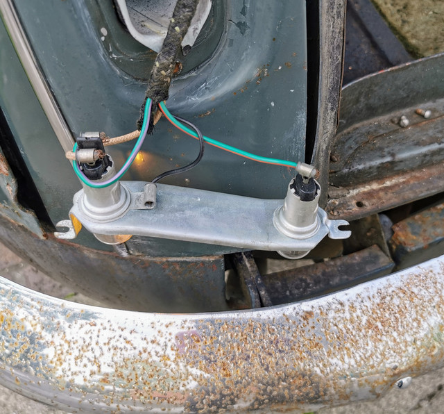

A little wiring correction already made its way onto the to do list today. I'd noted that the nearside tail lamp was behaving oddly, with the brake and running light functionality seemingly reversed.
Turns out it's because the wires simply were connected backwards on the lamp holder. So a 30 second job to sort.

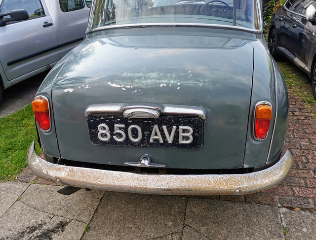

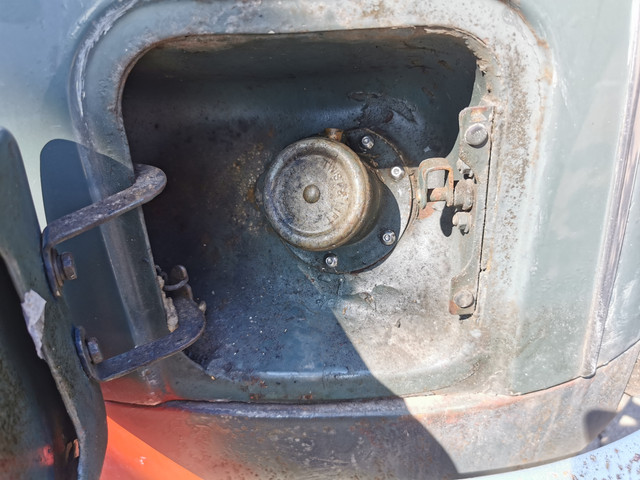

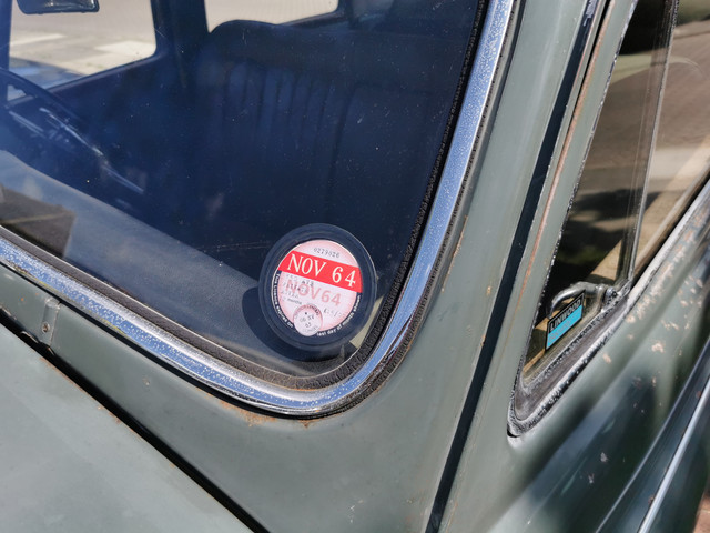

Yesterday I ticked off a small job in that the bolts securing the fuel filler neck were missing. Not exactly a strenuous job to sort that one.
Likewise fitting a replica tax disc - just feels odd not having one in the windscreen, so may as well make it look period if possible.

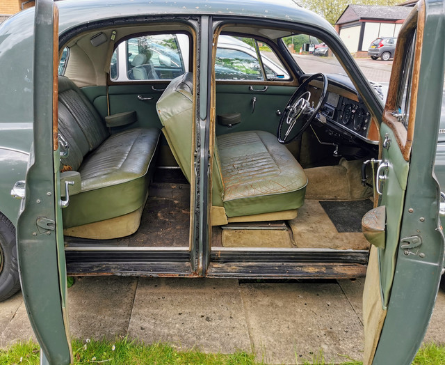

All four doors on the Rover now actually have door seals again. Rather than decomposing goo which was once rubber.
Simple enough job if rather tedious.
The bag is just a bunch of recycling I ran out of time to drop off today.
I think I've tracked down one of the main reasons for us suffering from such horrendous wind noise.
The passenger's front door needs adjustment, it's sitting a good 1/4" too far out at the top, so is actually sitting proud of the gutter.
So even with the new seal in there's quite a gap there still.
The driver's door has also dropped a bit probably due to wear on the hinge pins.
That I'm not massively surprised by on a car of this age to be honest. That one at least *mostly* seals now.
The doors do close with a decent chunk now rather than metallic clatter. It's also reduced the apparent level of rattles in the cabin by about 70% as the doors no longer rattle around like a garden gate on a windy day. A quick test run also confirmed that the really intrusive wind noise is now very clearly centred solidly on the front passenger side door now too. So adjusting that gap is definitely going to be high on the list.
