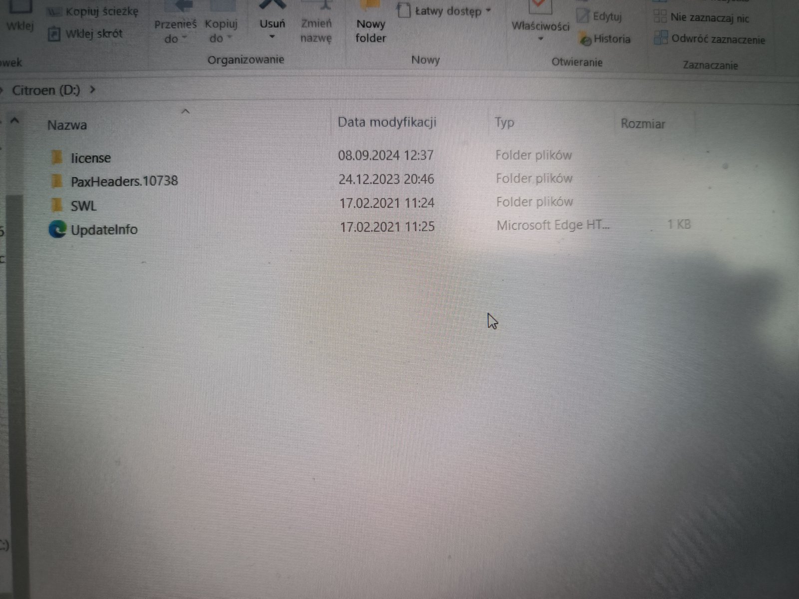

thank you, the update has started and unfortunately at the end of the update it displays an error, at this point my screen is blocked and it keeps asking for an update, no functions work. Is there any solution to this problem? Is there an option to return to the old version?
Posts: 42019
x 6917
Re: PSA NAC RCC Updates
This will only usually happen for the following reasons:
You cannot downgrade firmware! You will need to ensure the installation is completed correctly.
1) Have you used a big enough USB and was it formatted to FAT32 EACH time?
2) Don't use a MAC - it leaves system files not compatible.
3) Did you update Firmware first and reformat before you extracted the file?
4) Do you have a screenshot of the USB (Use the full-post editor to upload your pictures) so I can see what is on the USB?
5) Downloads can be corrupted or incomplete.
This has worked for thousands of others, so is a local issue most likely.

1)YES 64GB pendrive formatted in FAT32 using rufus.
2)I use a computer with the Windows 10 operating system.
3)I don't understand the question. No. 3, but I will answer: I unpacked the downloaded packed file with the firmware in Windows and then copied the files to a pendrive formatted to FAT32. I did not update MAP
Posts: 42019
x 6917
Ok, so the likely problem is you are using an old version of an archiving / compression utility like 7-Zip. This is known to cause problems with some files, because you should not have the 'PaxHeader*' folder there!
Upgrade your 7-Zip to the latest version from their website and try again - but reformat the drive again first and all should be well.
You should only have the license folder, the SWL folder and the Updateinfo file, nothing else.
