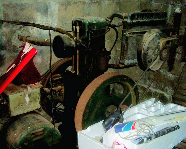

Well I do have an open invitation to re-home this once I figure out the logistics... it's only 550 miles away...mickthemaverick wrote: 05 Nov 2022, 18:34 Seems a lot of brainwork and component gathering when you could just get one of these Zel!! :![]()
Sure it wouldn't be at all heavy and difficult to manhandle into the back of a van...

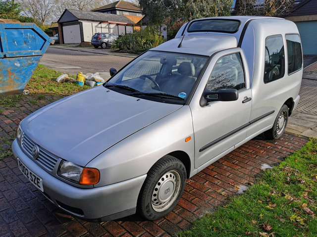

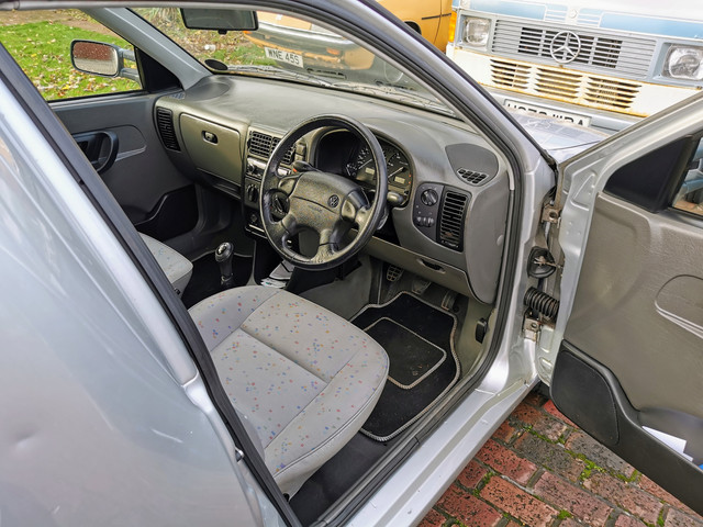

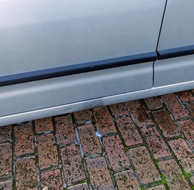

It's MOT time for the Caddy tomorrow so I gave it a quick clean today. I always try to turn up with my cars in a reasonably presentable state.
Still doesn't scrub up bad for a 20 year old van.

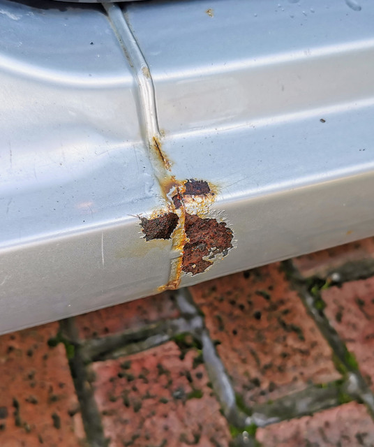

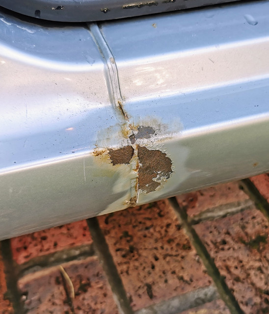

Also took the wire wheel to the crusty looking bit on the sills, which looked like this after I'd blasted the loose crud off with the pressure washer.
Then after this was hit with the wire wheel.
Seems perfectly solid. I've just thrown some Vactan and (not quite the right shade) silver paint on it for now.
It's better than crusty rusty anyway. Then I went round and checked all the obvious stuff like lights, making sure the washers weren't about to run out of water, stuff like that.
