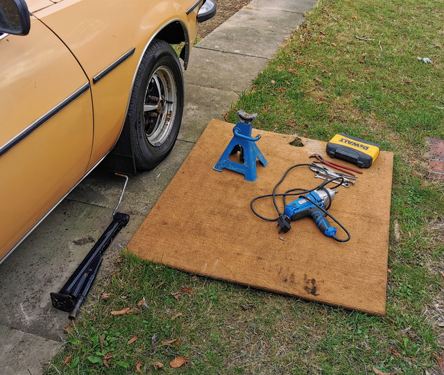

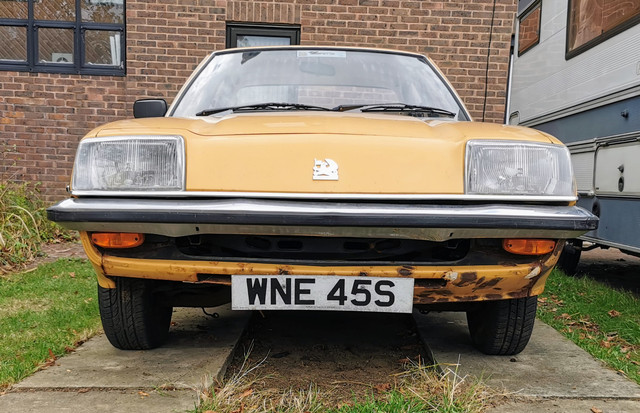

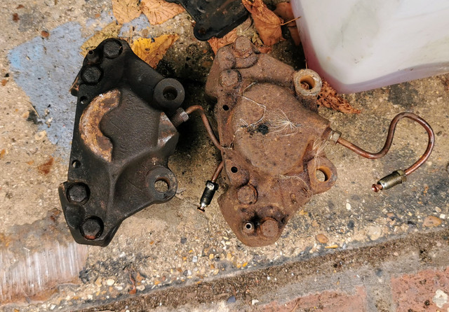

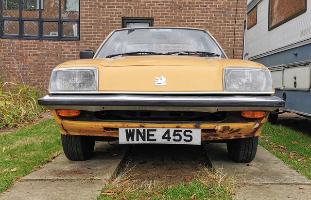

This afternoon I played chicken with the weather. This was rapidly bearing down on my position.
Mission was simple: Get the offside brake caliper off the Cavalier so I could get the pair sent off to be rebuilt.
In a rare show of organisation, I actually made a point of getting everything I expected to need out in advance and putting it where I could get to it, rather than the usual 15 trips back and forward to the garage.
Five minutes later, first contact with the enemy.

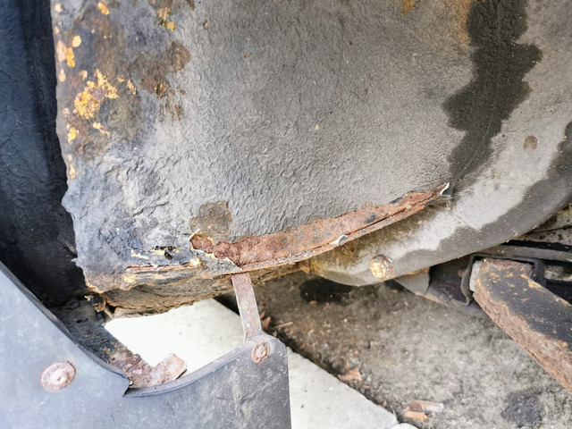

I was briefly sidetracked by a sinister looking bit of peeling seam sealer on the inner wheel arch, but thankfully I seem to have caught it in time.
Really isn't hard to see why these cars have a reputation for rusting.
Thanks to the wonders of power tools, less than ten minutes after picking tools up I had the caliper off, wheel back on and the jack back in the boot.
The little bag the jack and wheel brace live in are even colour coded to the car, how considerate of Vauxhall...
Yes I know they're just all that colour, but it amused me.

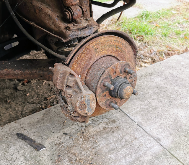

This is where we took a moment of "one step forward, two steps sideways."

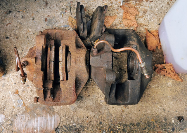

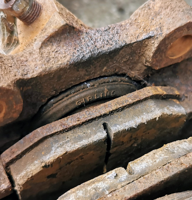

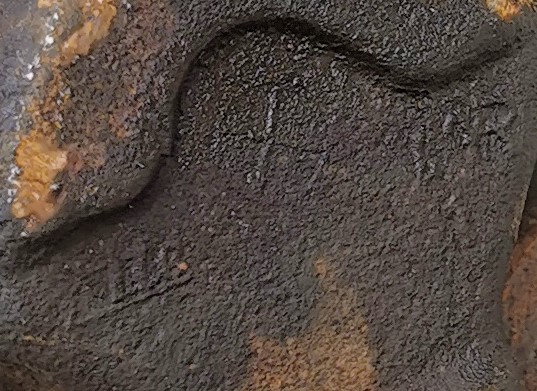

These two calipers are not the same.
The one on the offside is made by Girling.
Whereas the nearside one is an ATE.
Not really surprising that the car has had one changed, but it's rather annoying as it means I don't have a matched pair to send off for rebuild.
I'm also rather alarmed that the pads in each side are a totally different brand with a significant difference in the amount of wear on them...so it seems that whoever changed the nearside caliper didn't bother swapping the offside pads when it went on... additionally the lower caliper to hub bolt was missing it's washer...You remember me saying I was going to test the rear brakes before pulling things apart? Nope...on the strength of this, they're definitely getting properly inspected beforehand now.
Don't suppose anyone has an old nearside Girling caliper floating around do they?
Did spot something I'd previously missed that was a quick fix (well, it still needs a little attention but is a lot better). Spot the difference.
The valance had been shoved upwards on the offside. It still needs a little finessing and whatever did the damage has broken off one of the tabs where it attaches to the lower part of the wing, but it's a lot better.
So a little stuck while I decide what to do about the brakes. If I can't track down either another ATE or Girling caliper I will probably just end up buying a new pair, as don't want to hold this up too long.

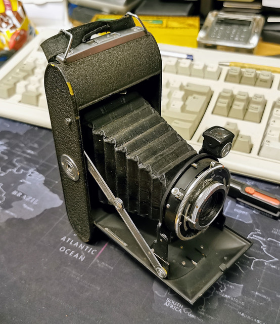

In other news, a little while back I picked this up for not very much.
However I ran into an issue in that I totally failed to properly take note of the fact that the focus ring is a multiple thread screw when I dismantled it for cleaning (there was a bunch of mould on the inside of the lens). So the focus ended up way out of whack, resulting in the focal point when set to infinity being about 3' in front of the camera.
I've just had the first film from after I had hopefully fixed this problem back (well, the scans of it anyway - the actual negatives are currently around 3500 miles away).
Think I can call that fixed!
Sadly I can't remember what film that was!

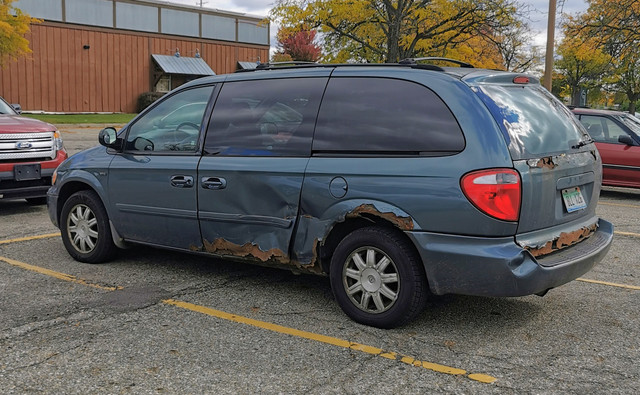

Ah, life in a US state with no vehicle inspections. Michigan in this case.
The other side didn't superficially look so bad until you realised that the inner and outer sills were *completely* missing.
This is not even *close* to the shonkiest thing I've seen on the road so far yet either, just a pretty typical example I came across in a parking lot. Being overtaken on the freeway by a pickup truck that's doing 90+ while visibly bending in the middle is somewhat unnerving.
Cars here literally get used until they can't function any more. Last time I was here there was a Ford Focus that was running around locally here with the entire front end held together by structural duct tape, zip ties and a windscreen made of perspex, having been in a significant enough shunt that all the airbags had deployed. It was clear that the left hand side of the car was a good few inches shorter than the right and the thing went down the road visibly crabbing to the left. That was just over five years ago. Saw it again today, still going.
Quite a different world here in some ways!

^^ Gosh, that's truly shocking Zel!
