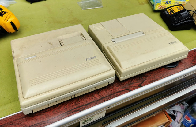

So much for self restraint. Insomnia and eBay are a dangerous combination.

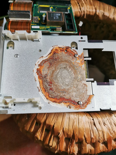

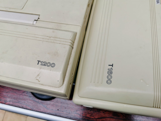

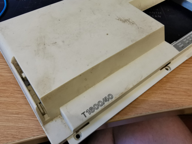

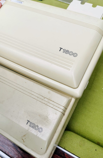

I always keep half an eye out for T1200s going cheaply as they're a big favourite of mine, despite being machines that don't cope with decades of hibernation very well. This one was collection only and obviously quite rough so I had a feeling might go cheap. So I stuck a low bid on and promptly forgot about it for six days until an email arrived telling me I'd won it!
This was for a pair of machines, a T1200 and T1600, which piqued my curiosity as I'd never seen one of them before. Obviously from the same period as the T1200 but clearly a more advanced machine.
Being quite used to the trials and tribulations of Toshibas of this era I didn't even think about applying power straight out. The power supply at the very least will need to have the electrolytic capacitors replaced and the inevitably leaked slime cleaned up. So I immediately started to strip the T1600 down.
The odds I gave it for surviving dropped significantly only a couple of minutes in.

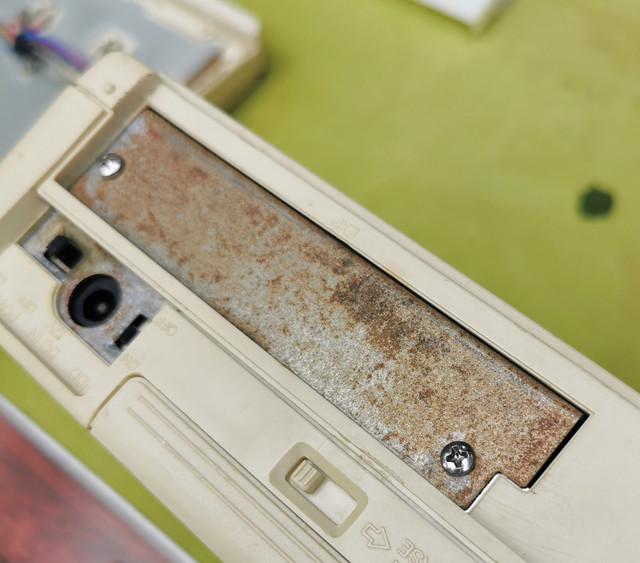

This is the frame the drives attach to, the corrosion there being caused by the suspend-to-RAM battery pack leaking. By some miracle Toshiba in this case had sat the pack in a little plastic tray and had also put a plastic shield on the motherboard underneath it, so this is the only actual damage I can see from it.

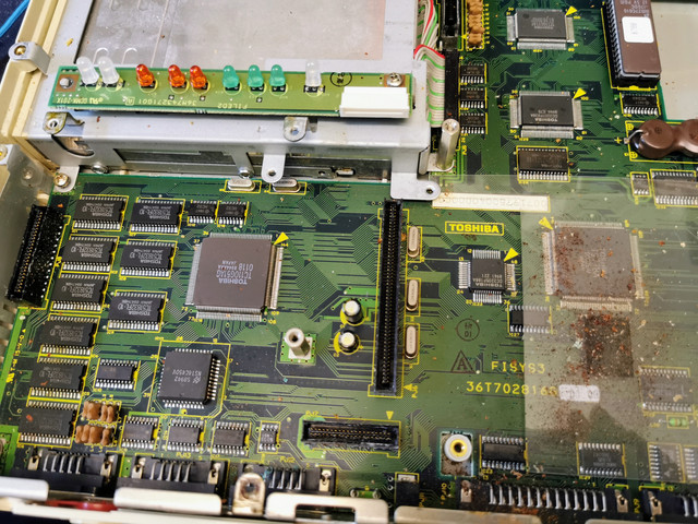

You can see the rust flakes at around 4 o'clock in the photo below, though the motherboard itself seems to have avoided the corrosion.

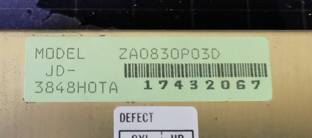

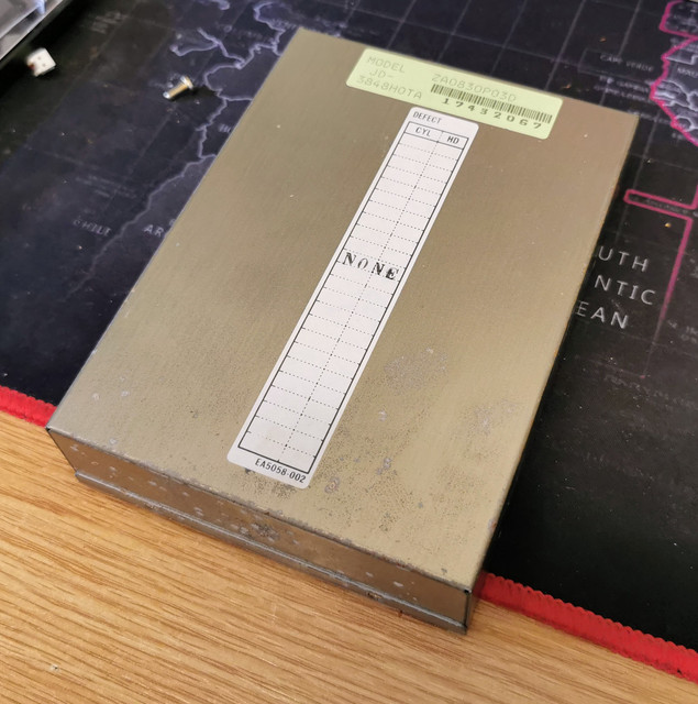

The hard drive sits straight above the corroded area yet aside from a bit of surface rust on the outer casing looks to have escaped. Whether it still works is another matter. I thought I'd seen all of the different proprietary drives Toshiba had used by now, but no... here's yet another one.

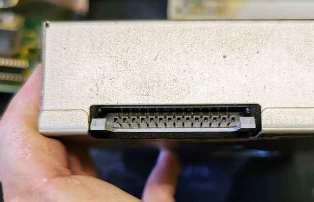

I believe this to essentially be a 40Mb version of the 20Mb drive used in the T1200, using the same I/O connector.
The model numbers are very similar and the early T1600s apparently had a 20Mb drive, which I'd put money on being the same one as used in the T1200. So if this drive is dead I can probably still get it going with one of the spares I have for them. Only choice I'd have really given finding a replacement is likely to be near impossible, and the proprietary interface means solid state solutions aren't really an option. You can't even use a Gotek or similar for the floppy drive as those are also non-standard. This is the connector they use (the black one below), which carries both data and power.
At least they did use this all the way to the mid 90s so I have a few spares of those. The one in the T1600 is a high density drive too, the T1200 being double density only is occasionally annoying.

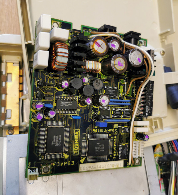

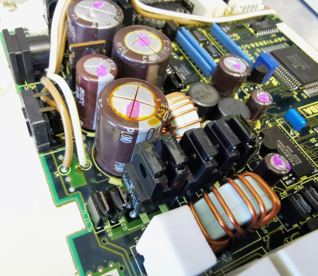

With that lot extracted I could wriggle the power supply board out.
Quite similar to the one in the T1200 just laid out a bit differently.
Closer inspection revealed the entirely expected incontinent capacitors. The goop was literally dripping off the power transistors in the foreground.
I can't see any eaten traces though so hopefully we've caught it early enough.
This is basically standard on these things nowadays and is why it's so important to not power them up. On the T1200 it is quite common for the resulting fault condition to stuff unregulated 12V down the 5V rail, usually nuking the motherboard.

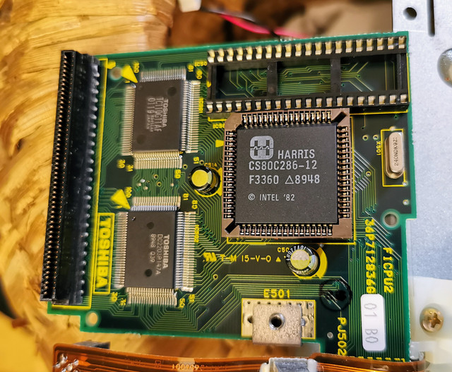

Speaking of the motherboard, the CPU isn't attached to it. The CPU and memory both reside on a little daughter board crammed in under the keyboard.
Which being an 80C286 does support the belief this is the big brother of the T1600.

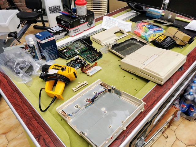

The whole machine was absolutely filthy so in addition to the innards which needed to be cleaned of capacitor slime, everything was removed from the case so it could get the same treatment.
Everything was left out in the sun to dry this afternoon after blowing things dry with the air line. Ignore the heat gun in the photo below, it's just waiting to be ferried to the garage.
The difference is pretty clear to see! These two were identically grubby when we started out.

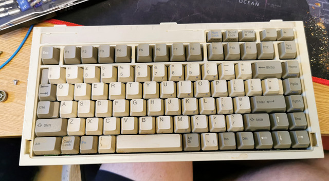

The keyboard will be getting the same treatment tomorrow having been passed by today as I couldn't find the keycap puller (it's since turned up). This layout was carried over to the T3100SX in 1993, possibly longer.
I will need to get some capacitors ordered up before we can go much further, but I should be able to build most of it back up tomorrow before I have the chance to lose too many screws and forget what order too many bits go together in. I know getting the one flex connector back into place is going to be an absolute pig as fishing it out was a real logic puzzle.
Must have been a real beast of a portable in 1989. 12MHz 80C86, 1Mb (standard) memory, 40Mb HDD, 1.44Mb floppy, full EGA graphics (onboard monitor is grey scale), optional inbuilt modem, 50 mins or so per battery (2x slots, hot-swappable), and a weight of around 5kg - with a much better handle than the T1200. The footprint is barely any bigger though which surprises me. This really couldn't have been made any smaller.
Speaking of dates, based on the codes on things it looks like mine dates from the first few weeks on 1990.
I'll probably pull the T1200 apart tomorrow for assessment and cleaning. Though given the *externally* visible corrosion I don't hold out great hopes for it.
I've found these are usually worse inside than out, so am expecting this to be pretty bad. At the very least it should yield come useful parts though.
Hopefully I'm just being a pessimist...watch this space I guess!
