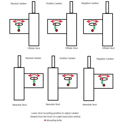

I am considering replacing the shocks and springs on the Subaru simply because I feel they are getting tired being 20 years old and having covered 145000 miles. In order to keep my brain from fading I drew a diagram of the front strut camber setup showing, with green arrows, where I have to mark the old strut before removing it so I can transfer the marks to the new strut before installing to ensure I get the camber correct. I just thought I'd post it here for anyone's general interest as a reminder for me should I mislay the original!!

Get it wrong and you will have a Scrubaroo

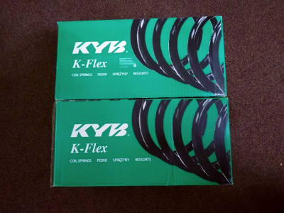

The first parcel of parts for my next project arrived today, I am ordering the parts monthly to spread the outlay and this is the cheapest parcel:
They look very good quality, so they will live on the shelf until I get the rear shocks.
I suppose you want to see what was inside:

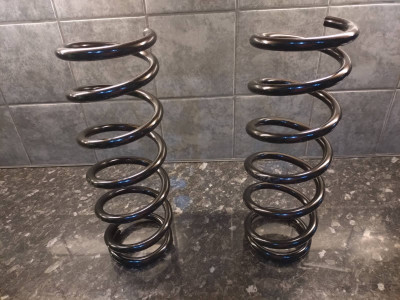

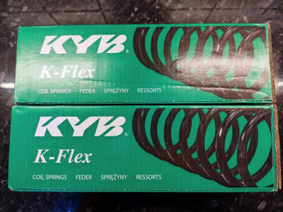

The next parts arrived today, the front springs!!

Magic! Spring really is just around the corner

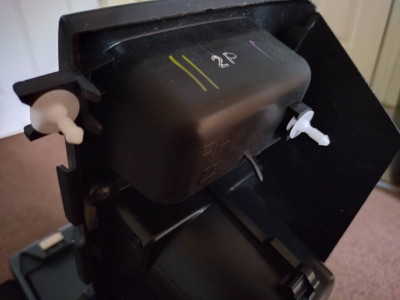

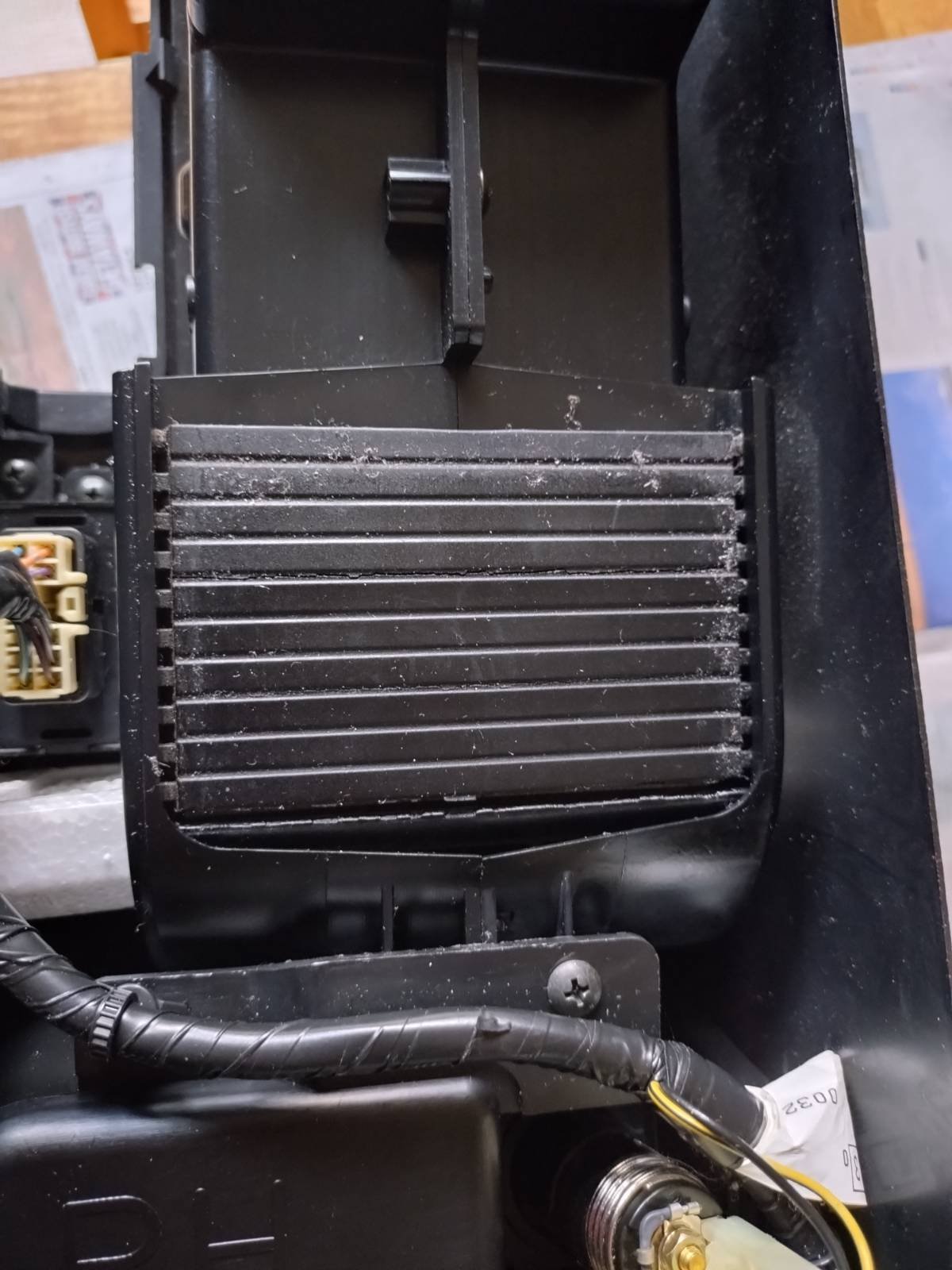

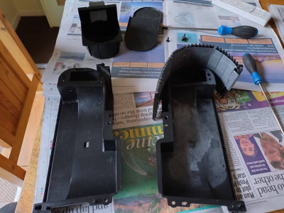

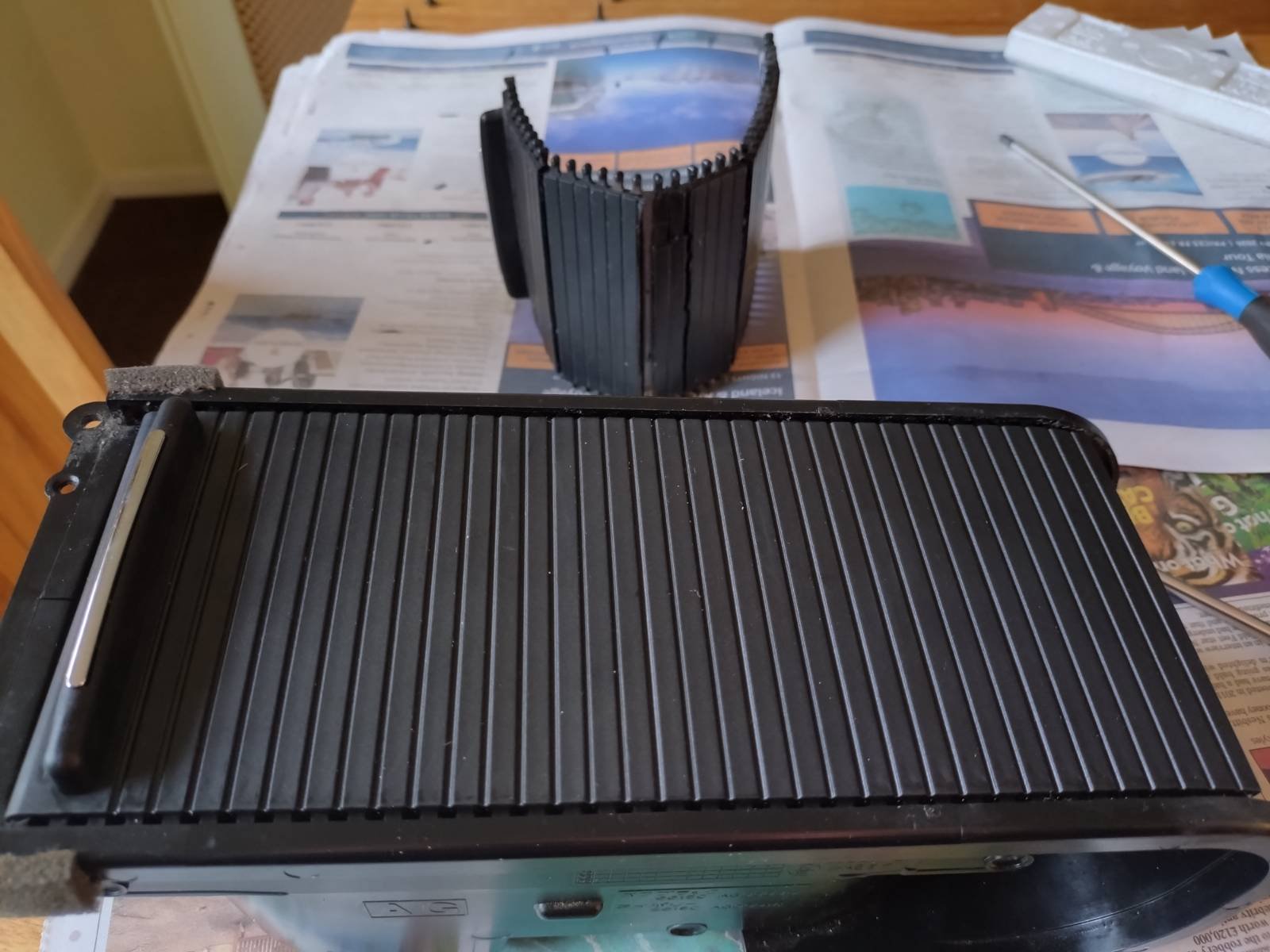

Time to install the subject of my Whatsthisthen. A fairly simple job really, best shown by the following pictures but briefly the procedure is:
1 Unclip the gear lever boot from the console
2 Remove the two mounting bolts in the bottom of the armrest box
3 Lever up and pull out the front locating pegs
4 Disconnect the single electric multi connector at the back underneath the box
5 Remove complete console and withdraw to the warmth of the dining room
6 Undo the 3 screws to release the centre box from the console and extract it
7 Undo the 4 holding screws which keep the two halves together retaining the blind in its runners
8 Remove the repaired but tatty blind
9 Fit thye new blind into the running slots on one half of the box
10 Replace the second half of the box ensuring the blind fits into its running slot
11 Reassemble the console and fit back in the car
12 Have a nice glass of Guinness to celebrate the removal of a longish time niggle!!
