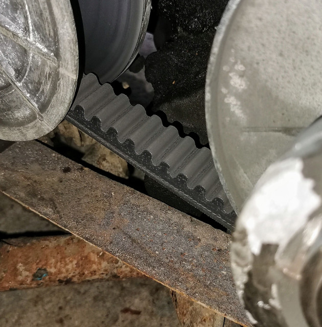

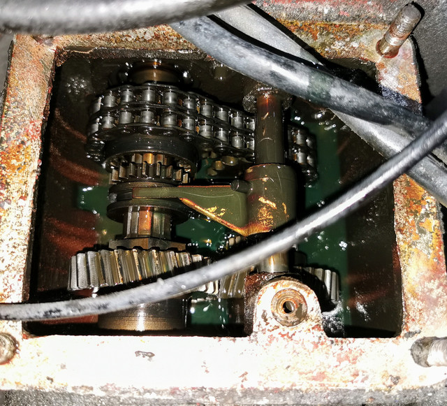

While waiting on parts from Mercedes for the S123 I figured it was a good opportunity to get a service item on TPA I'd been putting off done. Gearbox and diff oil change.
What came out was quite grim, not glittery though, just very degraded. Was really thin and seemed to have lost a lot of its lubricity. The oil that went in last year was from a very old container, and even though it was still sealed I think it may have broken down over time on the shelf. The new oil that went in today was actually new and hopefully will fare better.

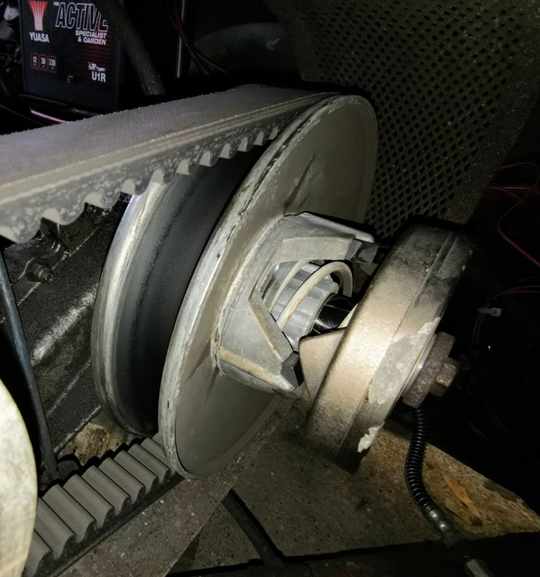

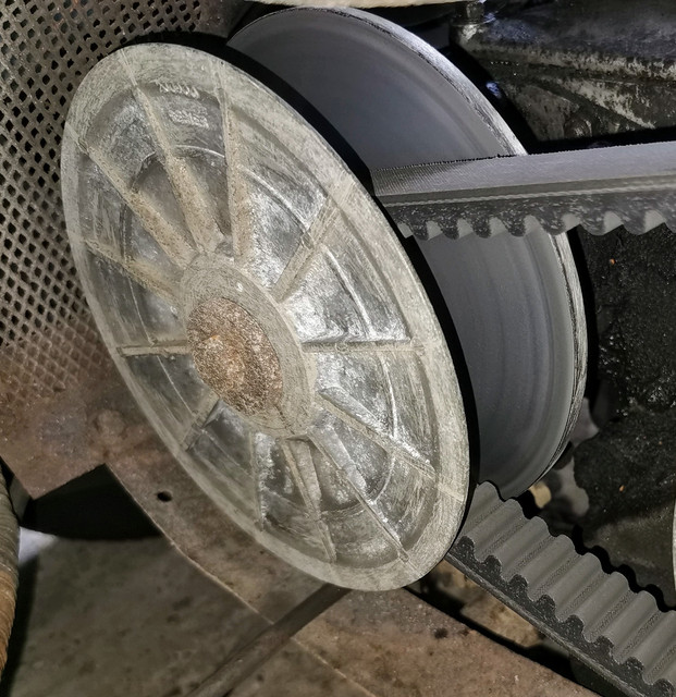

While I was in there I took a look at the condition of both CVT pulleys and the belt - these items live quite a hard life so it's worth checking for any signs of distress whenever you're in the area, especially as we've been experimenting with a current belt type rather than the exact one originally specified.
Everything looks fine though, looks like the Dayco HP2020 belt is able to stand up to the job.
It's been on there since last August and has about 1500 miles on so far.
Main reason I had been putting it off was that getting to the level plug for the diff is an absolute pain in the tail. It's not quite so bad now I've done it a few times as I know where it is (you can see it or touch it, but not both at the same time), but is still bloody awkward. I'm sure the intended way of changing the oil was to have the car on a lift in which case it would be dead easy. Having the original seat would make it easier too actually as the backrest can be easily removed from that, not possible on mine so you're working around it.
I've found that cracking the level plug off from in the engine bay but then unscrewing and removing/refitting it from in the cabin and then doing the final tightening from the engine side seems to be the easiest solution.

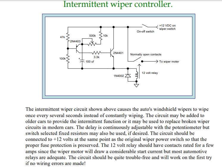

Windscreen wiper does a better job of clearing the screen than you'd think with how tiny it is, though an intermittent wipe function would be nice...you really want two hands on the handlebars whenever possible so having to keep turning the wiper on/off gets a bit tiresome after a while.

You might find this useful Zel, I fitted it to my Reliant and it worked well!! :)

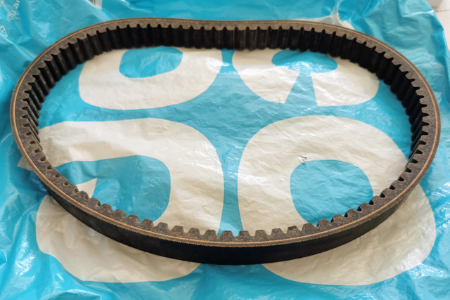

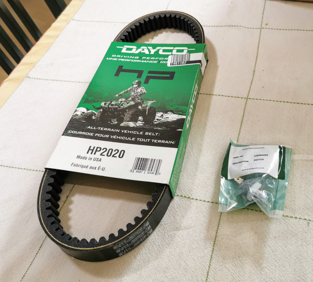

The belt on your CVT is interesting, because it looks like a toothed/timing/cam belt, rather than a notched V-belt (replacing the original solid V-belts).
What's its history, Zel?
Zelandeth
Posts: 5269
Joined: 16 Nov 2014, 23:36
x 1583
Re: Zel's Fleet Blog - BX, Jag XJ-S, Sinclair C5, Mercedes 208D & 230TE, AC Model 70.
Unread post by Zelandeth »

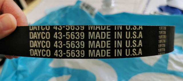

white exec wrote: 18 Oct 2021, 21:31 The belt on your CVT is interesting, because it looks like a toothed/timing/cam belt, rather than a notched V-belt (replacing the original solid V-belts).
The ribs I believe are primarily to increase the surface area for cooling purposes.
The original belts were made by the thousand under contract to DHSS by major manufacturers - I've seen them with both Dayco and Gates labels on, however it appeared to be specific to this application. We've been lucky enough to come across quite a large stash of NOS parts, including half a dozen or so CVT belts - one of these shown below.
A bit of measuring later we found that the Dayco HP2020 was pretty much identical to the originals - well within the tolerances of the sample of originals we were comparing to anyway. This is a bonus as the HP2020 is used by quite a number of ATV type vehicles to this day - including big names like Kawasaki. So they're pretty easy to find, especially in the US (I bought this from Rock Auto - even including shipping it was half the price of anyone selling it in this country).
One of the vehicles I found it as OEM specification was rated at well over 50bhp, so the 19.3bhp here shouldn't be stretching it too much - though they're probably not generally going to be doing as much high speed work, which is why I've been keeping an eye on it. It definitely smells of hot rubber after sitting at 70 for a while, but seems to be holding up fine. I generally stick to 60-65 on dual carriageway/motorways though as that's where she seems happiest.
While we've got a pretty decent stock of NOS belts it made a lot of sense to me to see if we could find a workable modern equivalent as they're not going to last forever, plus they're only getting older. This initial experiment being triggered by me having one let go one day without any warning. This was from my own parts stock though which had come with KPL and I reckon had degraded due to poor storage (that's been a running theme with most parts that came with that car), and the other NOS ones will probably last just fine.

I think that the ribs are designed to increase the gripping surface area while reducing heat generated by flexing.
