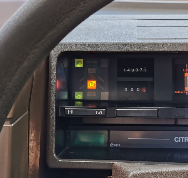

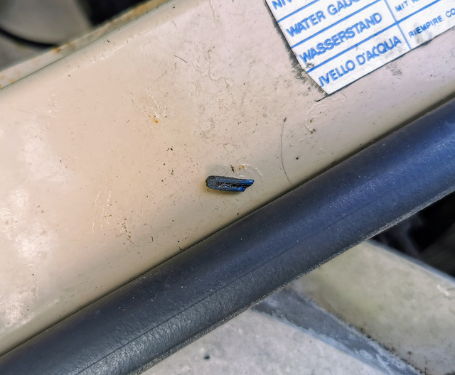

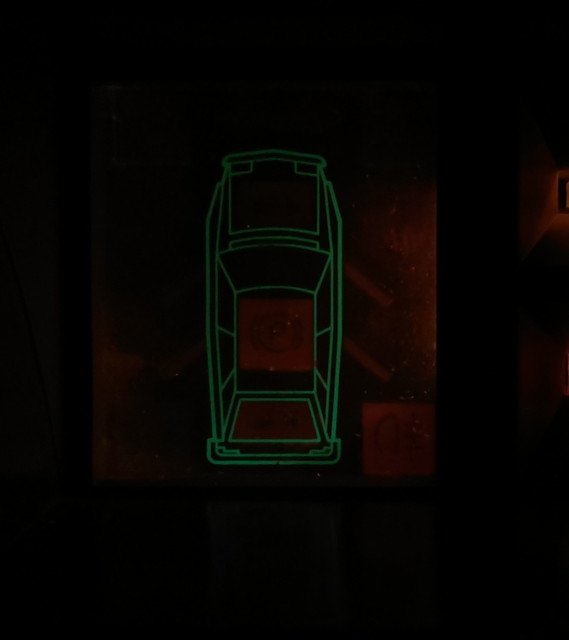

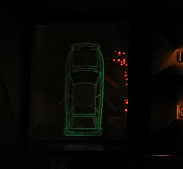

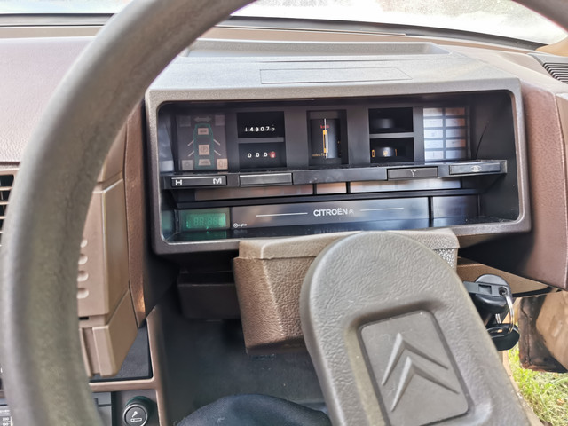

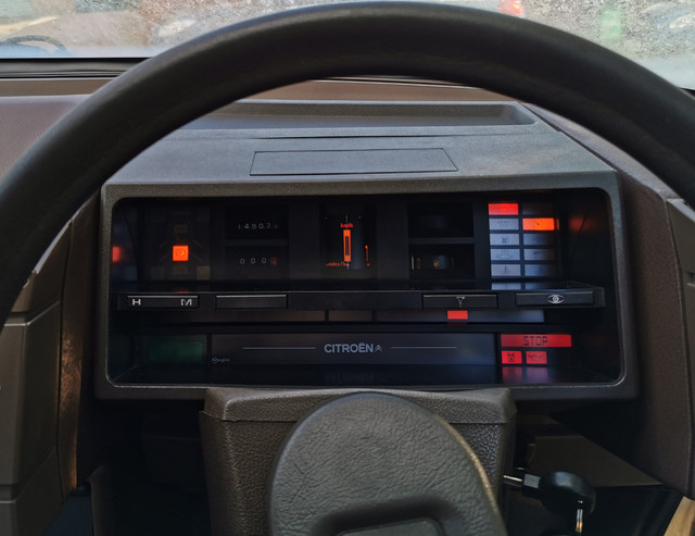

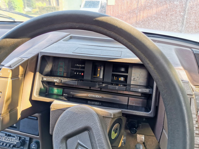

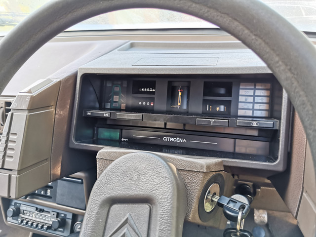

Well we've found why the BX speedometer doesn't work.
That little bit of plastic should be attached to the end of the lower cable. So unless I can come up with a bodge I'll be needing a new lower cable.
The dash is back together now though. Looks far less scruffy.
Before:
After:
All seems to be behaving.
I really had not appreciated quite how big a visual impact just repainting the pointer on the speedometer would make.
After dark I was able to take a look to see if the panel lighting was behaving...yep!
There used to be horrible blotchy bleed through here...
Much better now.
The slight bleed through on the right is actually just due to the frosted surface on the plastic light guide rather than light getting through the backing.
I've not been able to sort the clock yet so have just disabled it... having it show 0:00 every time the ignition was on was more annoying than it just not working. I'll get to that at some point in the future.

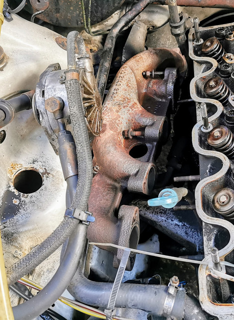

I've decided to take a step away from the Merc for a few days as I was just getting frustrated with it today.
Have discovered that to get the timing chain tensioner out (because I need to take it out and dismantle it to reset it so I can reattach the sprocket to the camshaft) I first need to remove the alternator. Of course one of the mounting blts is just spinning and I couldn't find the right size spanner to lock it in place. I'd already spent half an hour chasing tools around by that point and getting clocked on the head by the bootlid didn't help.

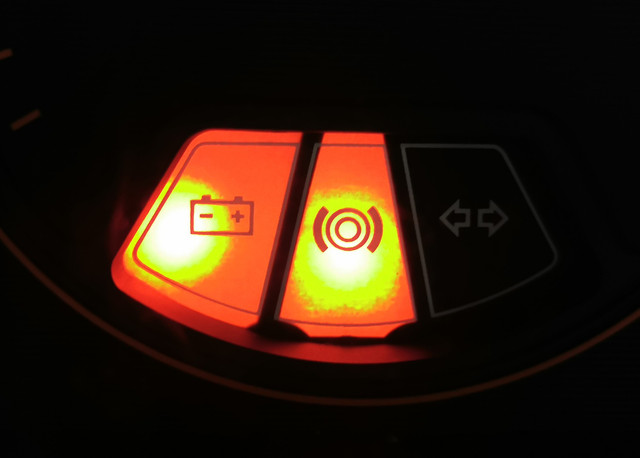

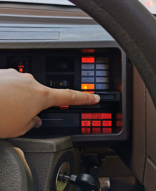

Much better now.

That instrument panel is looking a WHOLE lot better (and considerably better than I could have done).
- Posts: 28501
- x 5606
Re: Zel's Fleet Blog - BX, Jag XJ-S, Sinclair C5, Mercedes 208D & 230TE, AC Model 70.
Certainly is but I compared the first and second photo's and thought that there must be a lot of wishful thinking going on there - then saw the others

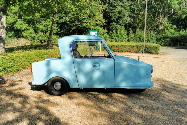

Two entries in one today as I ran out of time and energy halfway through yesterday's one...
Currently I have five cars on the drive. That's two too many.
Current status of them...
[] Jag: Intermittent charging fault. Reeks of fuel when the tank is more than 3/4 full. Sold anyway, waiting for the new owner to complete their house move so they've got space to take it on. I intend to stick a fresh MOT on before it's handed over (and obviously sort the alternator).
[] Van: Working...though being 2.6 metres tall means it's not the most practical daily driver as so many places around here have height barriers.
[] Merc S123: Currently half way to having the cylinder head removed.
[] BX: Hasn't been on the road in at least 11 years, we're making progress but still a ways from being a working car.

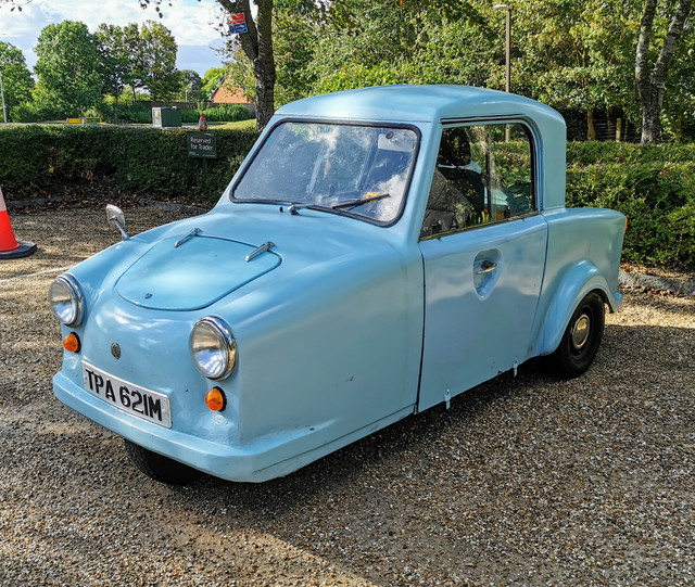

[] Invacar: Working, though the brakes need adjusting.
So yeah...two out of five. Not a great average.

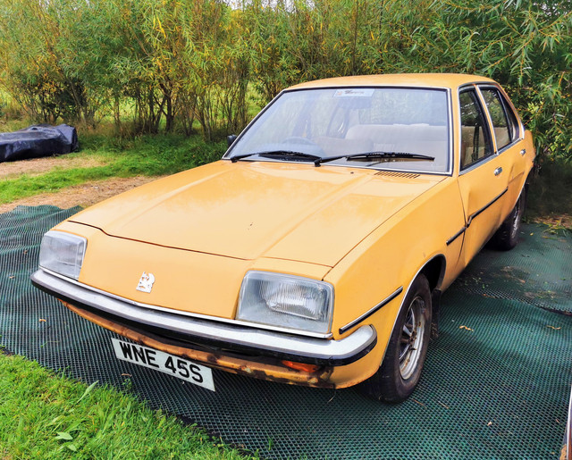

Absolutely the last thing I need is another project...so why the heck was I looking at one yesterday? Honestly I think the answer is because I'm an idiot.
I went to look at it with heavily tempered expectations, though was really quite pleasantly surprised at what I found.
So what did I find?

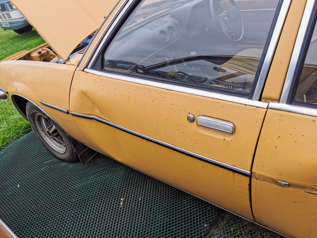

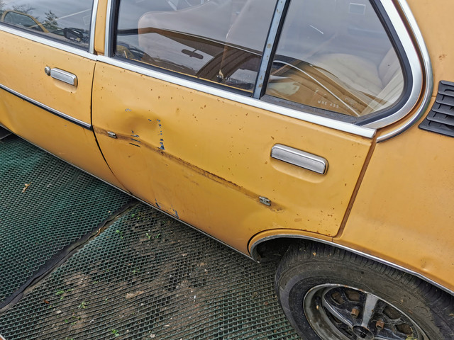

Looking a little bit sorry for herself from being in storage for several years and sporting a few dents and dings which have occurred during that time, but here she is.
Here's the real surprise though given this is an unrestored 70s Vauxhall...

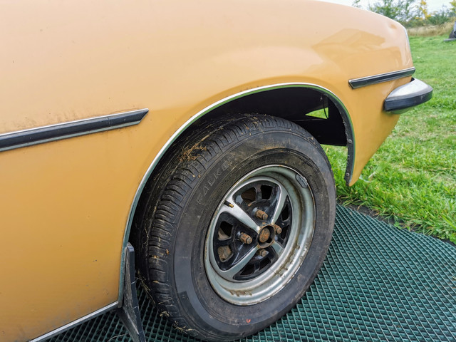

Incredibly little rust for one of these. I did find a couple of crunchy bits though, would have been downright miraculous if there weren't a couple. One is a hole just in front of the rear offside wheel. Which is probably the most difficult one to sort as it'll be an awkward pig to get to with welding spatter going in my ear.
Oddly the nearside...which is where I'm used to there being the most rust...seems perfectly solid here.
The crispy looking bit at frame left is the wheel arch lip rather than anything more sinister, poor framing on my part.

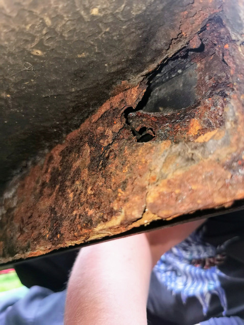

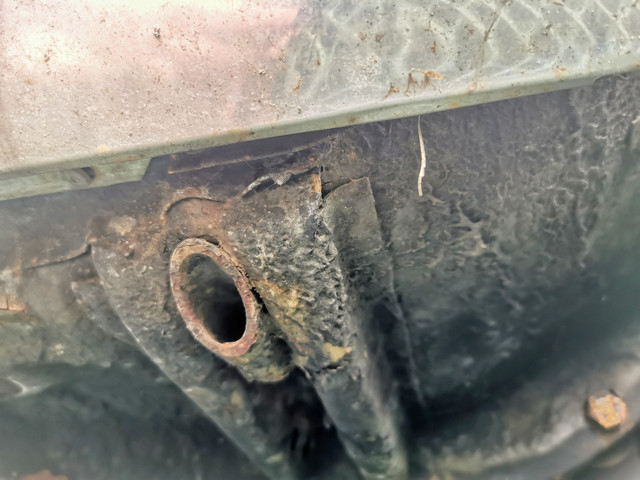

The other bit of note is on the nearside front chassis rail. A patch was done for the last MOT this car was back in 2010, however rust has got into the seam and blown it out.
This initially looked quite alarming and had me thinking it was going to be a sigh and walk away situation when the whole surrounding area went "scrunch" when I poked it...but it didn't. It all feels solid and does look to be a case of cutting out that old patch and letting in new metal. It's one of those hugely rare instances where welding is concerned that it's both easy to get to and doesn't require half the car to be dismantled. Wheel off and one plastic fuel line to be tucked out the way should be all that's needed.

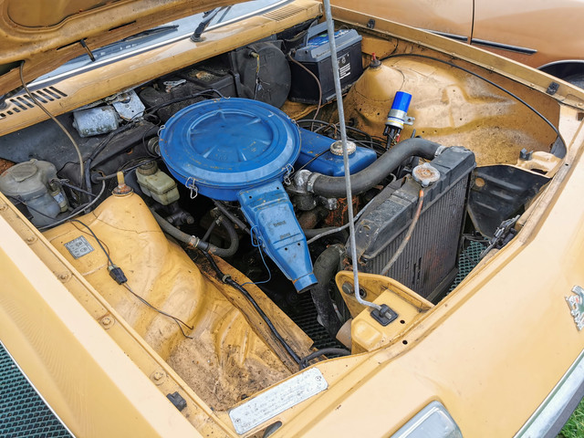

While we're under the bonnet already, look at those inner wings and shock towers...
We only had about a pint of petrol in the tank today so only managed a few minutes of running before running out, but she fired straight up and ran incredibly smoothly, albeit a bit tappety. Though from what I remember these engines did tend to rattle a bit.
This was about ten seconds after she was started up, so still on the choke.
This was originally an automatic but suffered a gearbox failure somewhere in the distant past - why the car spent its first stint in storage for a while. Back in 2007 it was rescued and converted to a 5-speed manual using a gearbox from a Manta. I know for a while the previous previous keeper had been chasing an odd running issue which seemed to point at a timing problem, however we don't know for certain whether this was resolved or not...we haven't been able to replicate it though so I think there's a bit of crossing fingers and hoping there.

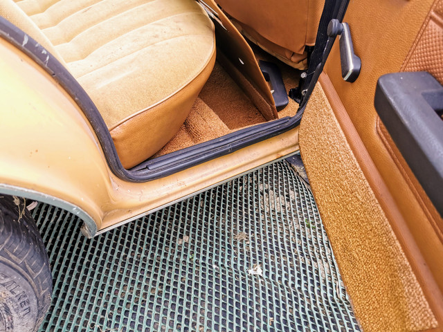

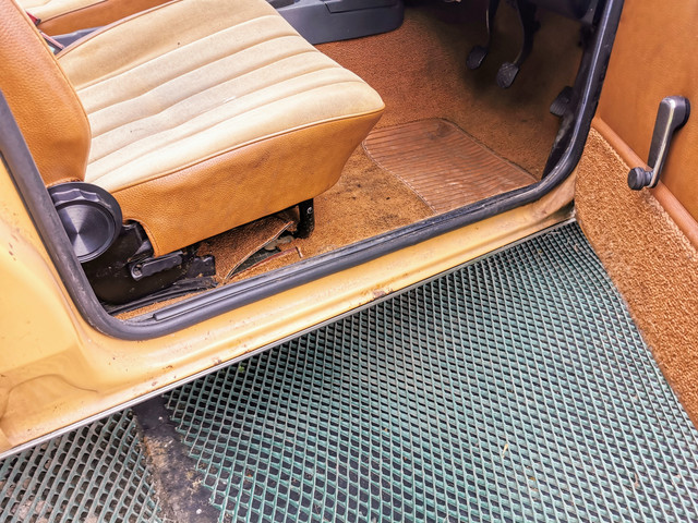

Being a GL this has stainless steel sill covers fitted...which is always a bit of a potential can of worms.
However from what I can see this is pretty much the story most of the way around.

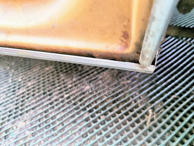

I gave them a decent thump along the full length both sides and the only bit I could detect any give in was the last couple of inches at the rear on the nearside where I'm absolutely sure there's a hole.
Bottom and inner sides of the sill are still there though, so not panicking too much. Wouldn't be the worst repair ever.

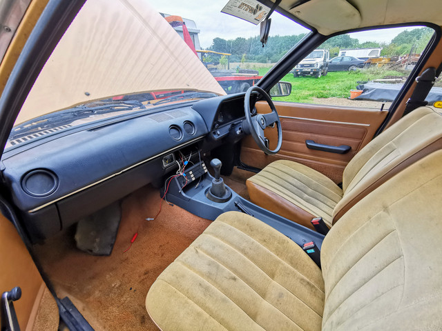

While the exterior has survived the last 43 years extraordinarily well it's nothing compared to the interior.
The 80s Manta gearknob and gaiter have to go and be replaced with something more period appropriate. The console (which is also Manta I think) will need to stay as there's a gap in the carpet due to the gearbox change having required modification of the tunnel as the Cavalier one would normally be further forward.
This may have something to do with why there's so little wear there.
Always a sucker for a dash with funky warning lights that aren't just square or round, even if my camera couldn't make heads or tails of the colour.
The door card for the nearside rear is present, it was removed a couple of weeks ago when folks were looking at whether the dent in that door could be pushed out by hand. Needs a bit more strength than that, but I reckon both of these could be sorted to an acceptable standard without too much drama.
I have always had a soft spot for these. An almost identical car was actually the first car I ever drove at about age 12, so there's a lot of nostalgia there. Memory is a funny old thing, first thing I noticed was that I remembered the smell of the interior. Never actually driven one on the road though!
It's a car I've always liked, for all the front end styling is divisive. Just never come across one for sale that was for sale that wasn't rotten, heavily performance modified, too expensive for me or any combination of the above. I wasn't looking for this...and in fact deliberately avoided looking at it too closely when I was last over there a few weeks ago because I knew I'd wind up asking "how much?" if I did. Then it popped up for sale...so here we are.
This is pretty much spot on for what I'd like...tidy enough that it could clean up well with a bit of elbow grease, not having comfort destroyed in favour of track lap times, and a pretty simple car to work on.

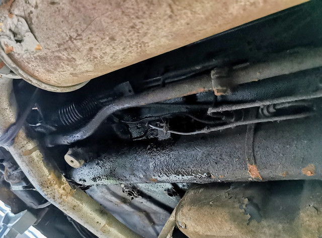

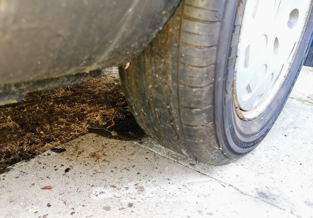

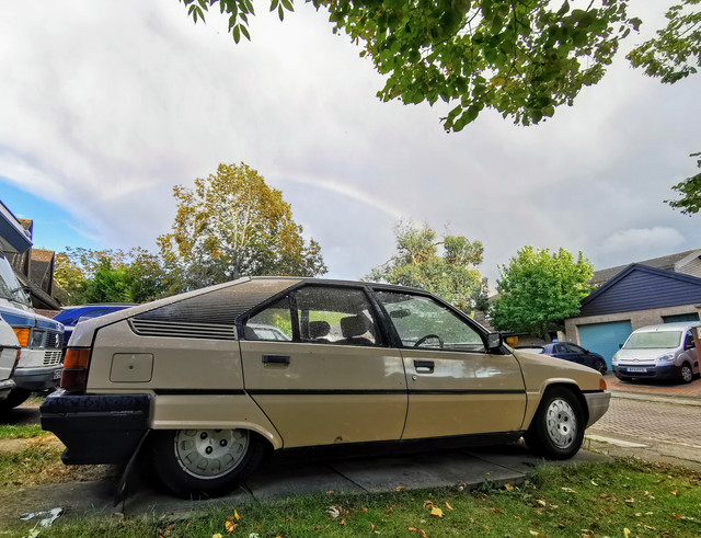

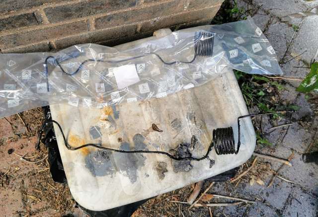

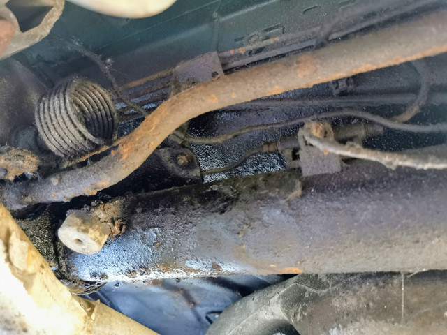

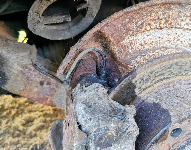

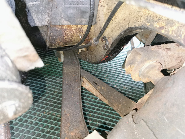

Having finally picked up the brake pipe for the BX I really had no excuse not to get cracking on sorting it.
Somewhat to my surprise both ends unbolted from the unions with relatively little effort. Rounding those off was high on my worry list.
All of the lines look crustier than I would like...so I can see them all being changed before the car is pushed into use.
While the clamps holding the pipe were really fiddly to undo it wasn't really that difficult.
Putting the new one in was equally fiddly but without drama. All in was about two hours, though at least half an hour of that was fiddling around trying to figure out where half the tools were.
Oh.
Yeah...about my diagnosis of that pipe being at fault... totally wrong. It must be the main brake supply line to the rear axle. Really hard to tell as I can't see the actual location of the leak, but it's not suspension related as the leak only happens when the brake pedal is pressed.
That will be fun to change. I know the official way to do this involves dropping the subframe...which is a road I really would rather have avoided at this stage when I don't even know for certain how far from an MOT we are.
Bit frustrating to be honest having spent that amount of time on something which probably didn't need doing!

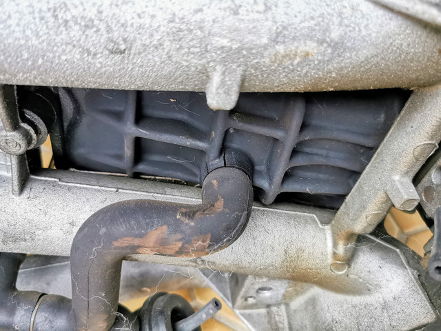

Oh.

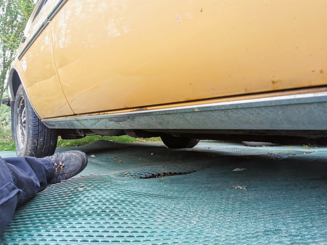

I have a car roller you can borrow if you want to roll it onto its side for any welding, Zel. Bolt it to the wheel studs on one side and safely put it up on its side - it don't half make life easier for such things

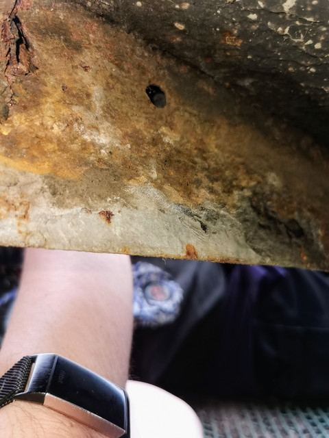

That would probably be an absolute godsend for doing that work on the inner sill.bobins wrote: 27 Sep 2021, 06:58 I have a car roller you can borrow if you want to roll it onto its side for any welding, Zel. Bolt it to the wheel studs on one side and safely put it up on its side - it don't half make life easier for such things![]()
The first thing which will be happening once the welding is completed will be getting it professionally rust proofed. Yes it'll be £5-600, but given the tendency of these cars to dissolve even back in their day, having a warrantied corrosion barrier in place will be worth every penny. Plus I know they'll have the kit to get properly into all the cavities and such way better than I can. It's so clean by and large underneath it really should be preserved.

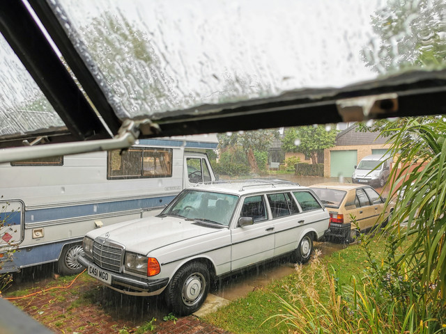

Having now got hold of a 12mm Torx bit I had hoped to get some more work on the Merc done today...
Yes, the weather had other ideas. As a bonus there's about an inch of water in the garage again. Oh what fun.

The arrival of the Cavalier on the scene really has complicated things... Really hadn't been anticipating any more automotive arrivals for a while. Very much looking forward to getting stuck into it though.
Biggest issue though is that I need to clear a space before I can get it delivered...Jag isn't going anywhere for over a month. Merc Currently is obviously...in bits. BX...well I really want to get that back on the road. Bah...need to make a slot somehow! Preferably quickly as I'd like to try to get at least some of the work done before the weather totally dives for the winter.
Yes it will be delivered. I know it's technically MOT exempt, but I'm not about to go all Vice Grip Garage on this...I know the front brakes are shot, there's a bulge in the nearside front tyre the size of an egg, we're missing part of the exhaust, and it's been sitting in a shed for at least 11 years. Plus there may have been an unresolved running issue prior to that. If I was still in the back end of rural Aberdeenshire, maybe if I changed the tyres, made sure it actually ran well and sorted the brakes...Down here...not happening!

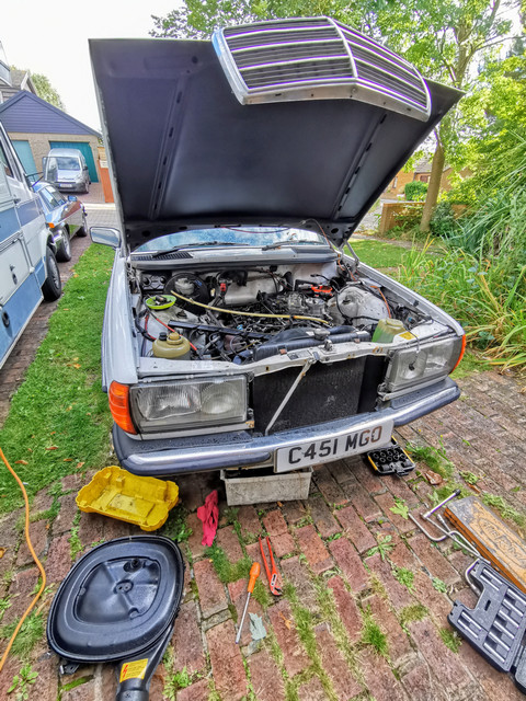

Back at it this afternoon.

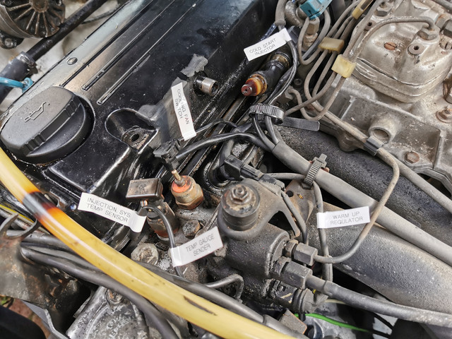

Step 1 I decided was to label the handful of wiring connectors which would need to be removed. Have to admit this is one of the reasons I love K-Jet injection systems...so simple electronically.
IAC valve is hiding just out of shot above the frame.
Checking it with a straight edge the spare head appears to be flat. Once it's had a good clean I'll inspect it closely for any signs of damage. Being used to relatively tiny and not performance focused OHV engines those valves look positively huge. I guess that's the real bonus of an oversquare engine with a crossflow head...more room for big valves.
I'll be transferring my inlet manifold complete with fuel distributor over, but I'll be removing it from the head off the car. Both as the inlet manifold will give me something to get hold of to help lift it and because a couple of the retaining bolts are a real pig to get to with it in the car.
Definitely want to use mine though. Assure from it being filthy it looks like the plastic housing on the fuel metering head has started to fail on the spare.
A vacuum leak there could cause absolute mayhem with regards to fuelling. Hoping the one currently on the car is better or I'll need to come up with some sort of repair.
Let the strip down commence!
A huge surprise arrived midway through this when I went to tackle the part of the whole job I have been dreading the most. Removing the exhaust manifold.
I have never had to remove one on a car which has not been an absolutely horrible war of a job.
Right up until today. This just unbolted from the head without any drama whatsoever. Okay, was a 50/50 mix of the nuts unscrewing and the studs winding out of the head but that's irrelevant as far as I'm concerned. I have never known a manifold come off that easy. Ever.
So...this brings us up to here:
[] Rocker cover, camshaft carriers/rocker assemblies and camshaft removed.
[] Exhaust manifold clear of head.
[] Coolant drained (block drain is hidden behind exhaust manifold, hence choosing that sequence). Oil had already been drained before we started.
[] Throttle cable and gearbox kickdown cables disconnected.
[] Various electrical connectors disconnected and de-threaded from the vacuum pipework they wound their way through before.
[] Vacuum line to brake servo disconnected at manifold end.
[] Engine earth strap disconnected from inlet manifold.
[] Fuel flow and return lines disconnected and moved clear (after discovering the hidden 10mm bolt holding them to the fuel distributor.
[] Disconnected heater hose from rear of head.
[] Removed half a dozen small bore vacuum lines, not forgetting the near invisible one to the gearbox.
[] Unbolted the thermostat housing from the front of the head.
[] Removed the top alternator mounting bolt.

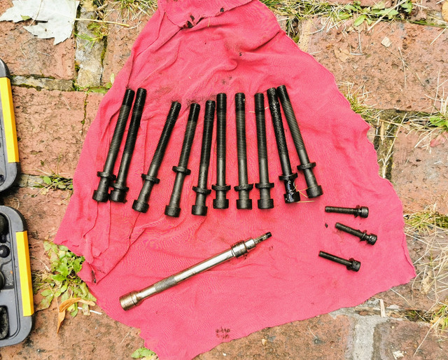

[] Removed head bolts ( including the sneaky ones right at the front and the *really* sneaky one over by the warm up regulator masquerading as a plugged coolant sensor hole.

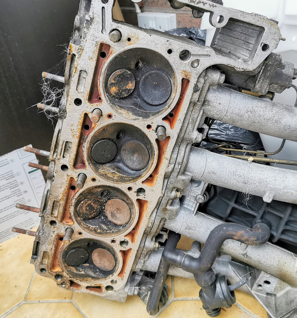

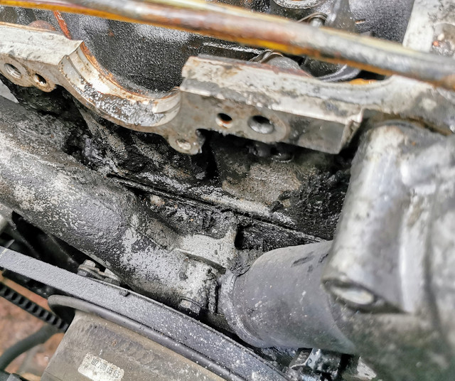

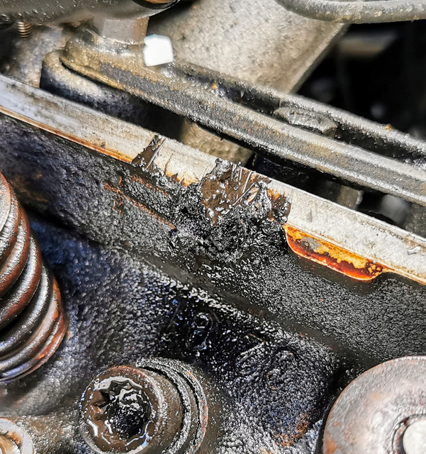

Yeah...to put into perspective how filthy this head is, this is how much gunk I had to scoop out of the head bolt heads before I could get the bit into them properly.
That is probably the best part of 1 X 2 cm.
After a certain amount of swearing we got to the point where the head has split from the block.
However I haven't so far been able to get it to separate around the full perimeter quite yet. I've also realised that due to the design of the timing chain tensioner that I need to faff around with that first before I can fully remove the head. The tensioner has a pin which passes through the middle of the loop of the chain...so either than pin needs to come out or the chain needs to be split. Apparently the inner of this pin however is threaded so you can wind a bolt into it and then pull it out of the head... we'll see if that's true tomorrow.
Kinda feels like a failure that I didn't get the head fully out today, I had really hoped to. We're about 95% of the way there though.
I can't start rebuilding things yet anyway as I'm still waiting on the head and inlet manifold gaskets (exhaust ones are of a type which should be fine to reuse) to arrive. Depending on what the weather is up to tomorrow we'll hopefully either get the whole head off the car or start stripping down and cleaning the spare one.
I'm telling myself to stop being bloody lazy and lap the valves in, though I can't for the life of me tell you where my valve spring compressor is...
It's a bit of a strange engine to work on...a lot of it is really well thought out and easy, but every now and then there are just a few bits which are seemingly needlessly complicated or awkward. The non-resettable timing chain tensioner and chain guide you need to use a puller/slide hammer to remove from the head immediately spring to mind.
I have checked the measurements of the head bolts and they're all well within spec so should be fine to be reused. I can't see any evidence of this head ever being off before so far so not a huge surprise.
Just need a really good clean as like everything, they're covered in sticky black tar.
As is now about 3/4 of my toolkit, the garage door, my hair and the side of the van.
Hopefully we'll have good progress to report tomorrow.
Of course just to add to the fun the heavens decided to open just as I was tidying up...and immediately stopped about the second I closed the garage door.
With a bit of luck we'll be able to do a side-by-side comparison of the two heads tomorrow.
