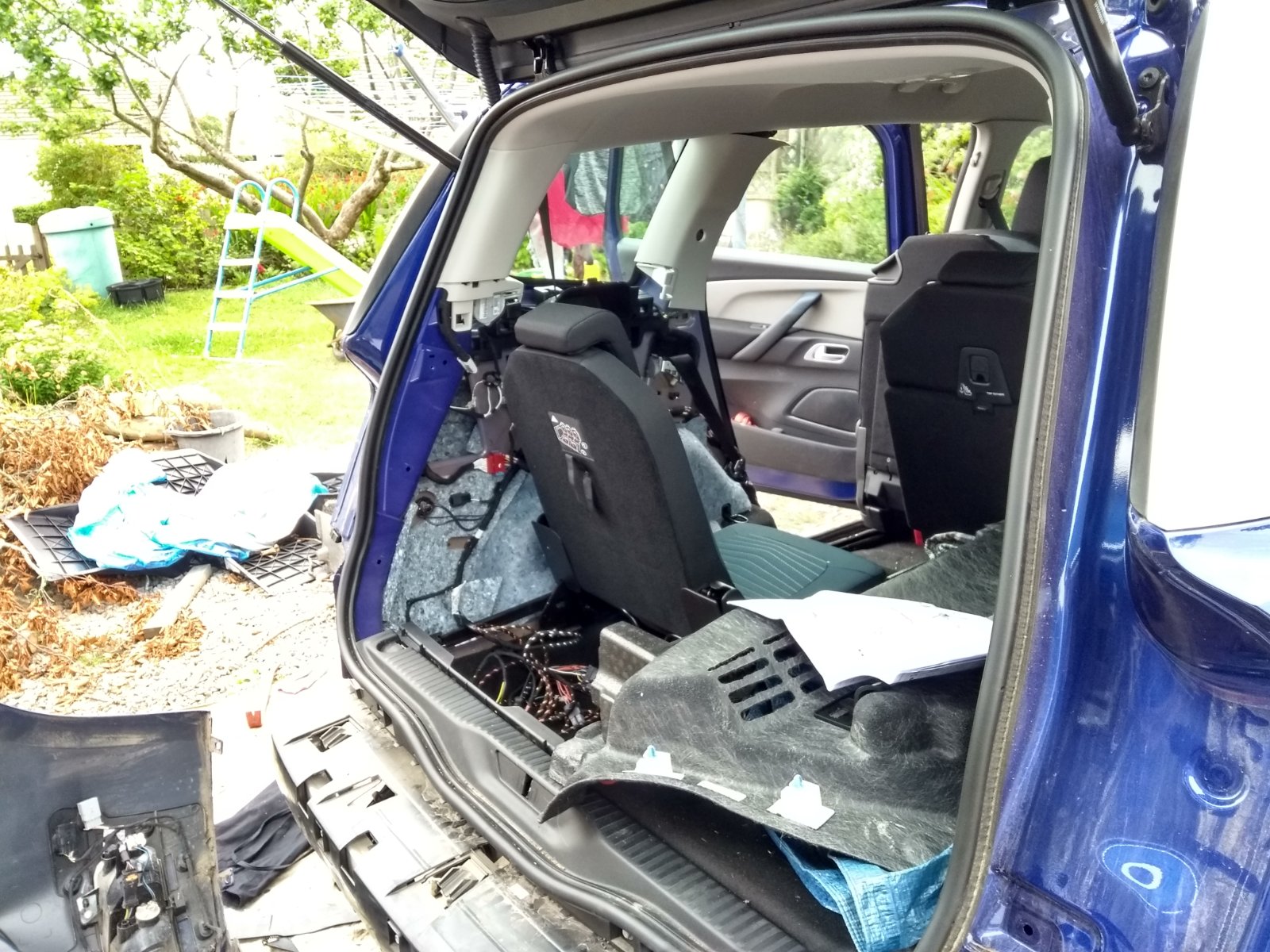

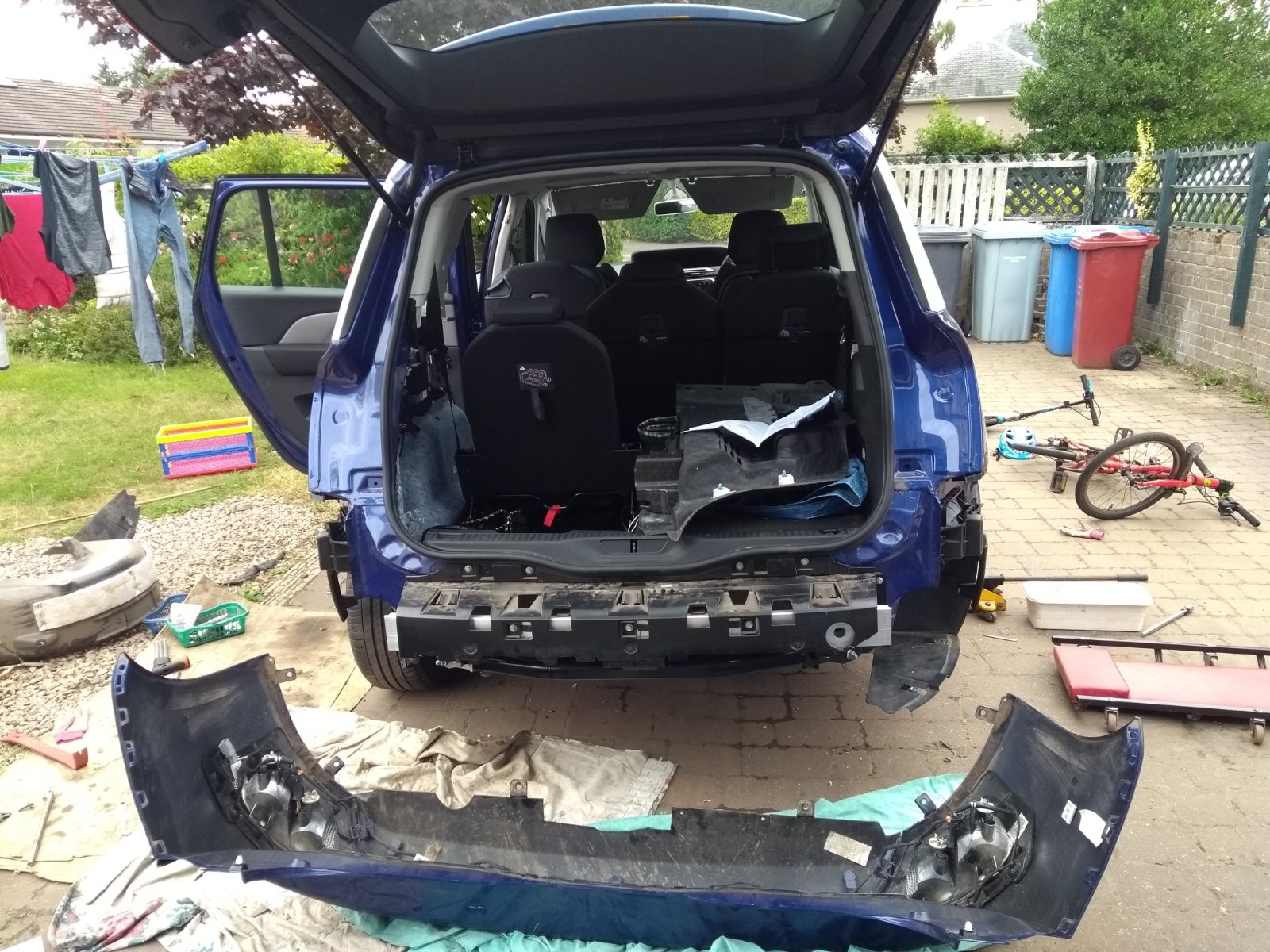

Fitting a tow bar. Bar is on, and bumper refitted - although it needs to come off again as it's not right somewhere, and I can't shut the boot at the moment

Today I have mostly been...... taking our nearly new car apart!

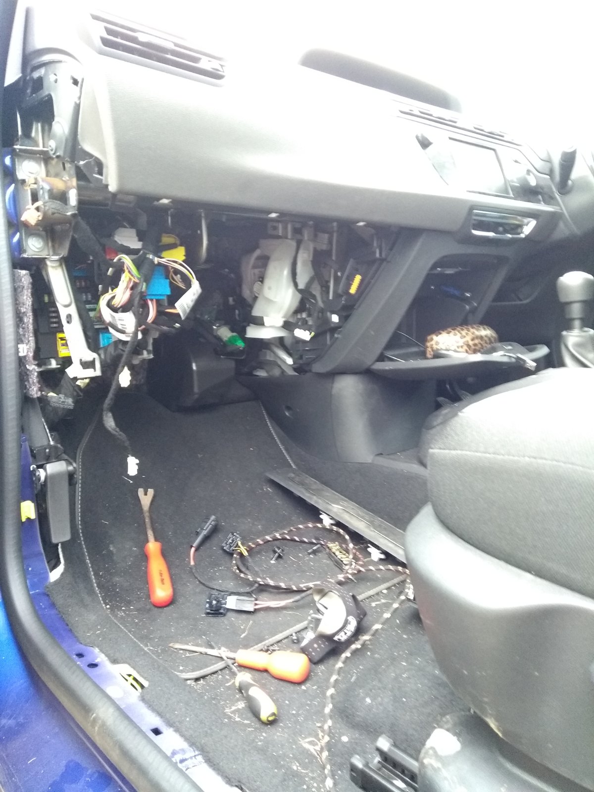

Fitting proper integrated electrics, the connectors are by the BSI, and I couldn't see one of them so the glovebox had to come out. Fortunately I have managed to feed the harness under the edge of the B pillar trim, as taking that off was looking like a whole 'nother heap of trouble! Hopefully I can remember where all the bits go!!

It looks like you left it parked in a bad neighbourhood for a few days!
Hope you got it back together or at least rain proof before the rains descended tonight..

Got it all back together, no bits left over, and only a couple of broken clips
Seems there are some tags on the top of the bumper that need to be tucked in, once in the right place the boot shuts again
. Electrics all working, so they must already have been enabled, including cutting the rear park sensors when a trailer is plugged in. The electrics kit also have a party trick - switch on the hazards, and then plug the trailer in, and it runs a light check, putting each of the light functions on for a second or so in turn so you can check them easily - which is rather odd to see! It also apparently makes the brake / side light flash if it detects the indicator is not working. Traced a faulty side light on the bike rack to a loose wire in the plug. Then onto looking at the bikes - trued up the front wheel on my bike, but it still seemed to be running out of true - a closer look revealed that the tyre was breaking up and had a big lump on it, so off to Halfords for a new one. The one that was on there, I'm pretty sure was on it when I bought it nearly 20 years ago... d'oh really must get out on it more!!!

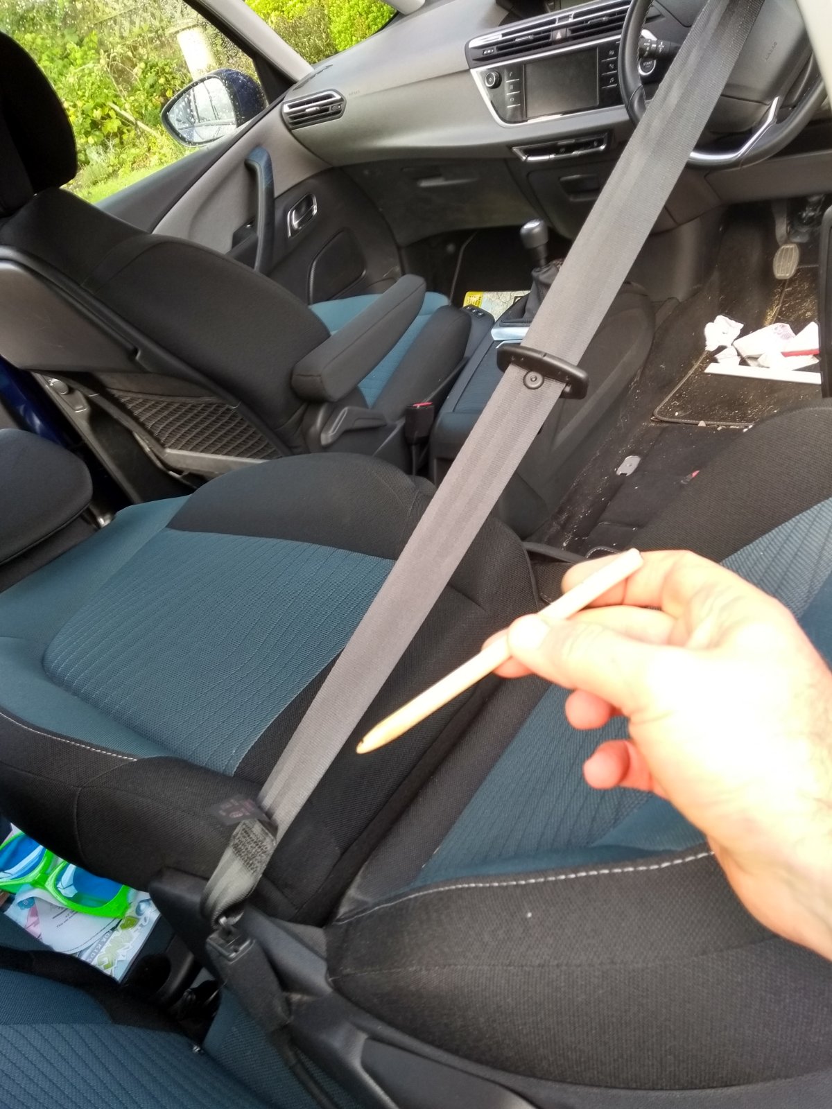

Regular readers may remember me stripping out the passenger seat on our previous C4GP as it had a pencil stuck in it. Got in the new one yesterday, and noticed the driver's seat was catching.... Investigation today revealed a pencil in the inboard runner

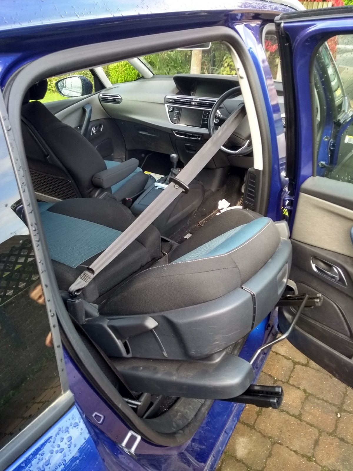

A few minutes poking failed to dislodge it, so decided seat needed to come out while it was still slideable
Supposedly you can unplug the bottom end of the seat belt with 2 3mm rods, but I couldn't spring it; no matter, I got it moving then was able to tip it out:
Boys may be banned from pencils forthwith!
