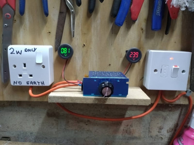

Well I received the last parts I needed enabling me to complete the supply setup:
MTMO
MTMO
and following that I was able to mock up the final test bed for the idea thereby putting you all, well both of you, out of your misery :-D :
Spoiler: show
Unfortunately after a few tests the 300W strimmer motor was not at all happy so I am looking for a more powerful motor, but at least it proves the fundamental idea works!! :-D

With that hub, are you making a wheel balancer!?

Re: DIY Car Maintenance with function over finesse!!
Not a balancer Matt no, that needs too much precision !! :-D

Wood turning lathe?
Pete
Posts: 15859
x 6749
That is my secondary objective Pete, not for anything fancy but just to be able to spin something for fun, but we are in the Car Maintenance thread and the prime objective is for that purpose!! :-D

mickthemaverick wrote: 19 Oct 2024, 08:38 but we are in the Car Maintenance thread and the prime objective is for that purpose!! :-D
Ah yes.
Alternator checker then
Pete
Posts: 15859
x 6749
Now that's an idea that hadn't come to mind, yes it could be adapted for that but not my prime objective! :-D

Is it a brake disc checker to see if there warped or not? Or belt tensioner tester?
Yes Ryan it is for brake disc checking and cleaning and run out testing. At least it will be when the final version is done. The strimmer motor is not up to the job but was good in proving the theory. I am on the lookout for a cheap more powerful motor at the moment, possibly from a washing machine or similar!
It may well get used for other jobs like tyre lining or general rotary maintenance of various sorts. My main issue is that it has to be easily assembled and dissassembled as I have to keep the garage clear for SWMBO's car! :-D
