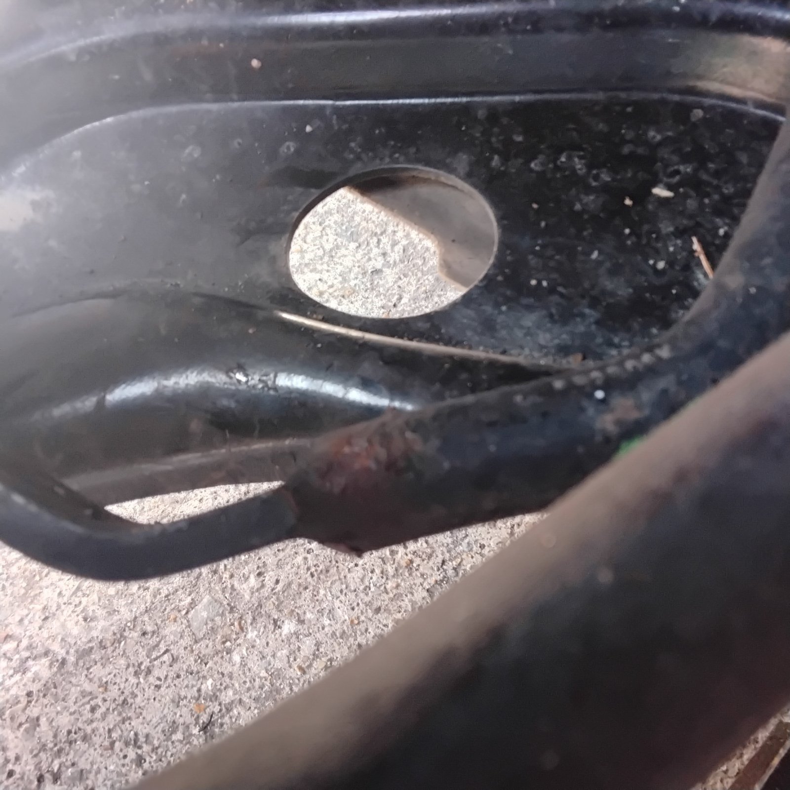

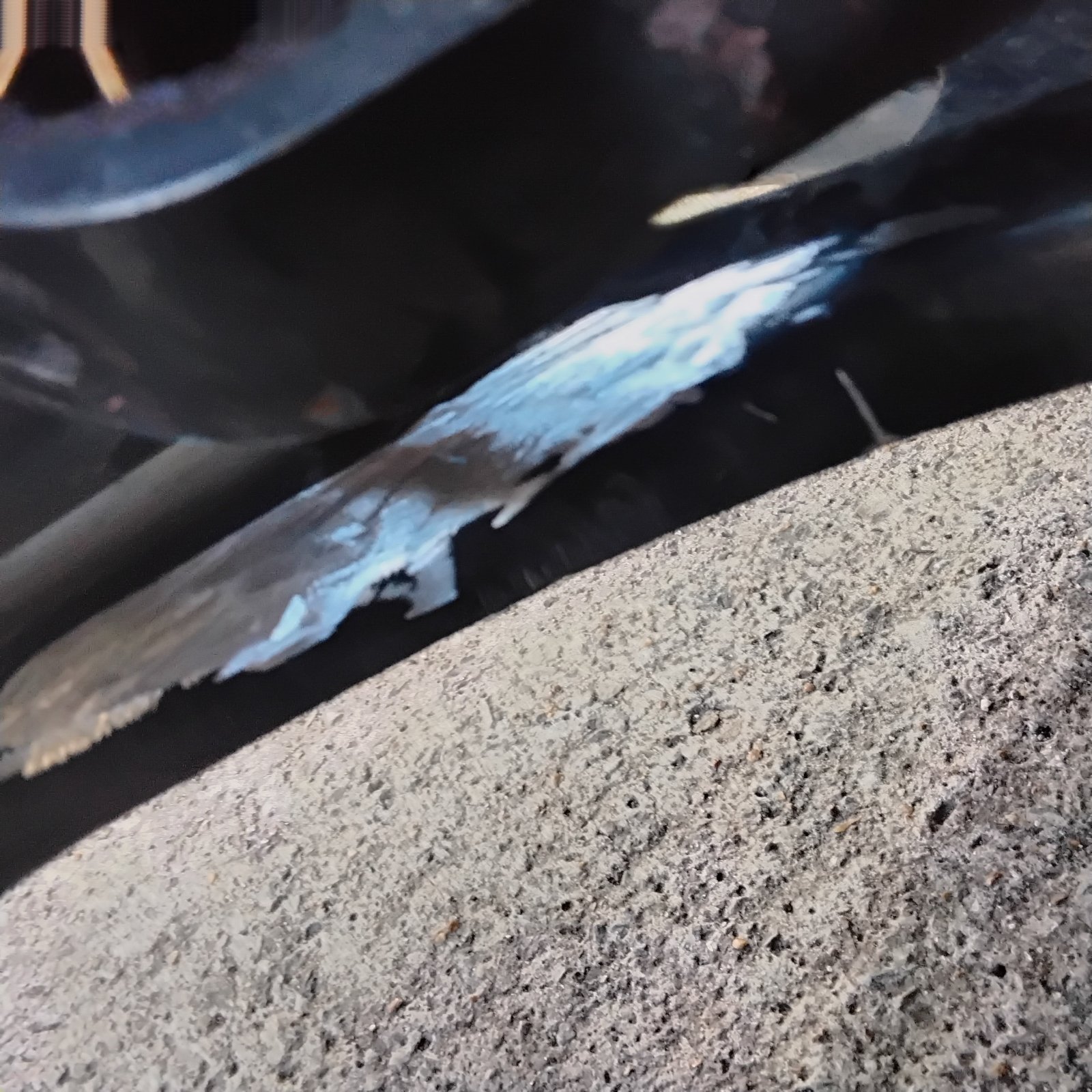

The passenger drop link had no space to get the whole of your finger like the driver side did as I checked that which was a good thing I did because my new steering tie rod gaiter had poop off its clips , so I've put 2 new jubilee type clips which the inner was a pain but that done , im now doing the passenger side and the gaiter is fine but check out the impact marks on the new lower wish bone I renewed a few weeks ago ! The drop link has been hitting it
As I made me way to the car I was greeted with a trail of feathers ! So I said good morning dad

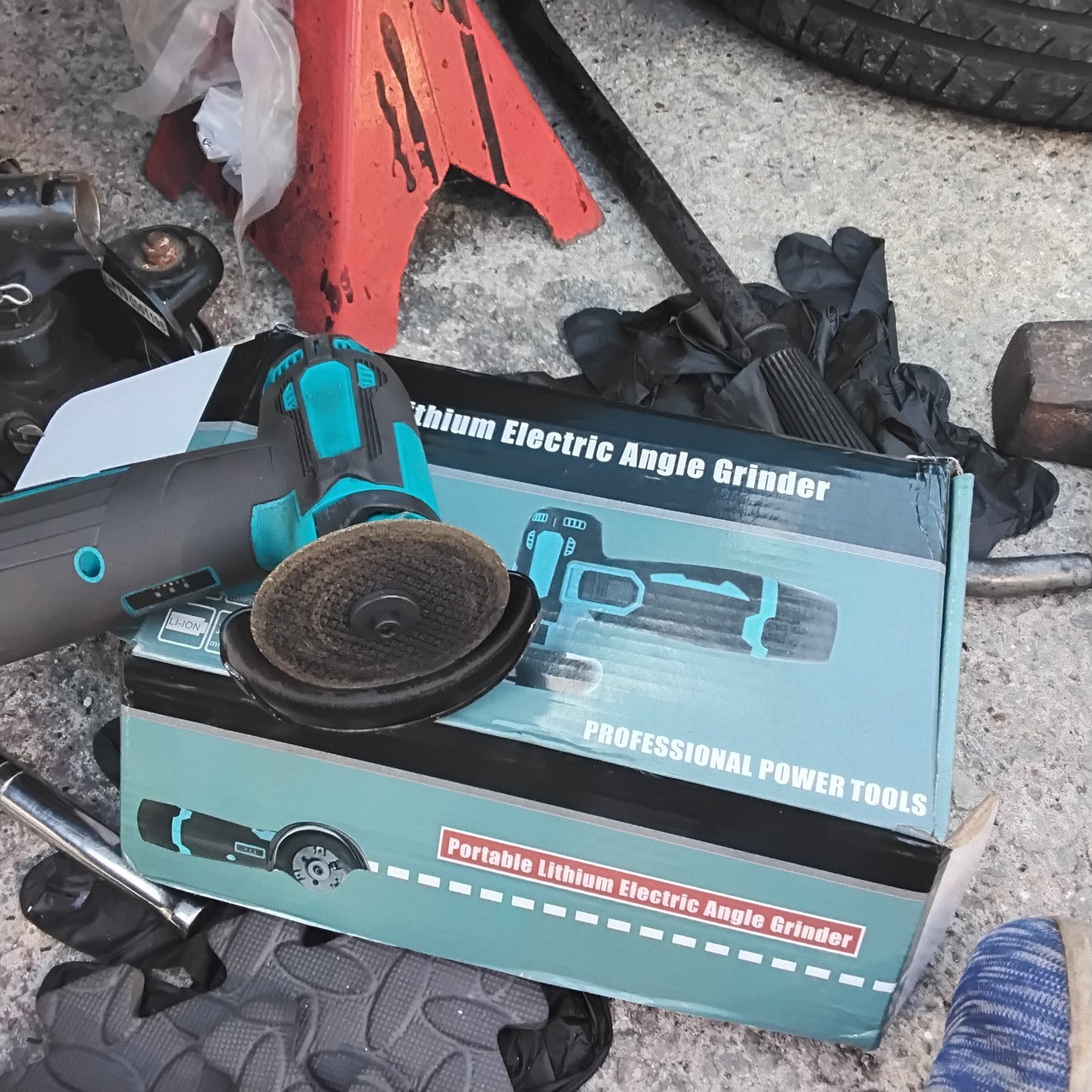

Ok my findings. The lower wish bone compared to the one that came off doesn't have a lowered section where the drop link sits above so im creating my own fix with this rather handy little angle grinder
