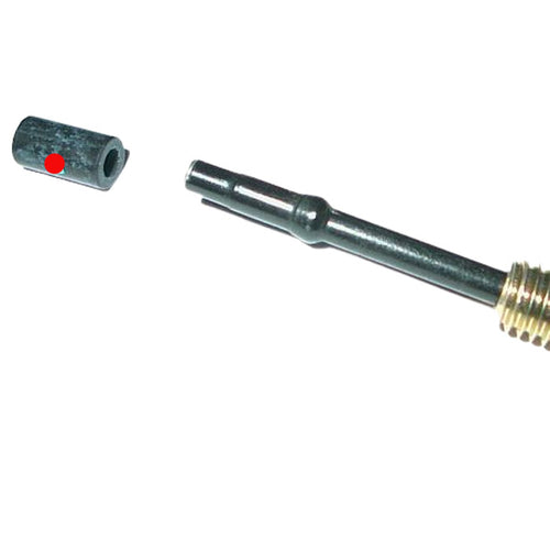

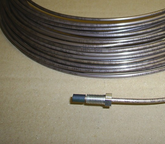

Cheers Steve! But having repiped a BX from top to toe a number of years ago, I don't think there's any call for the stuff that Svod and I are developing, as IIRC the BX is all the old LHM fittings, in 3.5mm and 4.5mm format. What I'm terming LHM fittings are the ones with a rubber tube that gets pushed onto a bulbous section on the pipe used on pre-hydractive cars, like this:
EDIT: Added better picture of LHM pipe end:
I bought a tool to make those ends from Pleiades, an off the shelf item for them, in the naughties (god I'm getting old), so that system has good support by Pleiades (the godfathers of Citroen Hydraulics IMHO) and Euro Car Care (who are also very good), so my stuff is more for C5 / C6 / XM(?) / Xantia(?).
