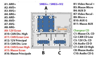

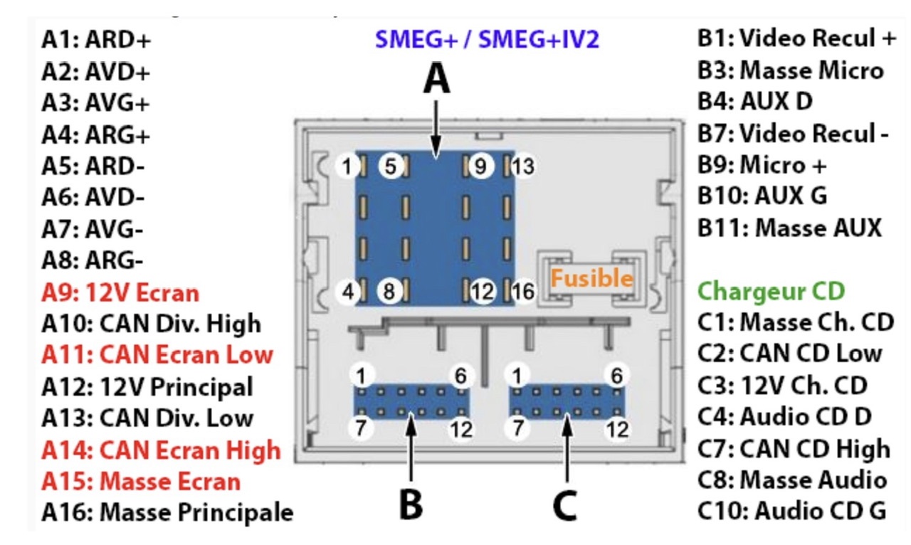

So. I don't really care about NAC. I've got genuine SMEG+ IV2 purchased(brand new). I've got panel and screen. I need to find power source for screen and tele coding SMEG to my vin. Do I need change any pins in cable to get front panel working as it should because some functions are different?

You’re talking about RT6 to SMEG+IV2 upgrade?
Changing the VIN on that one is only possible with connection to Citroen servers. So it’s either a dealership (10 minutes job) or you can do it yourself (if you have Lexia cable and Diagbox), but you’ll still need to purchase a 45€ token on ServiceBox to access Citroen servers.
As for the panel; I assume you’ve kept the old infotainment panel from RT6 and now some buttons aren’t quite right with SMEG+IV2?
That’d be cause some buttons are removed with the touchscreen (and corresponding new panel).
No change in pins is needed, though (you got it working, right?). Those “some functions that are different” should be done by telecoding it right. Needs manual telecoding of said functions, so will be a bit more hassle for the guys at dealership, or you (should you choose to DIY)…
As for the screen; I think the pin outs are the same for RT6 and SMEG? The connectors are the same (no adapters needed).
Anyway, here’s the photo of those on SMEG. You find the one for RT6 and compare the two…

Ok so I've got nac unit. I've plugged in with adaptor and screen won't power up. I will buy another adapter but can someone provide nac pinout diagram please?
I'm worried that I will have to upgrade screen to multi touch as it doesn't have additional power cable I think.

Read these pages carefully. NAC screen doesn’t use brown power cord (it becomes unnecessary). Both data and power go through the rounded USB cable from NAC (black connector in the bottom row)…
Mine’s not multitouch, but plain DGT7C and it works just fine.
