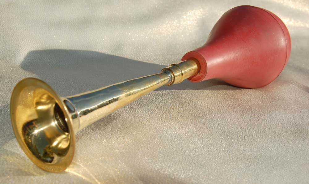

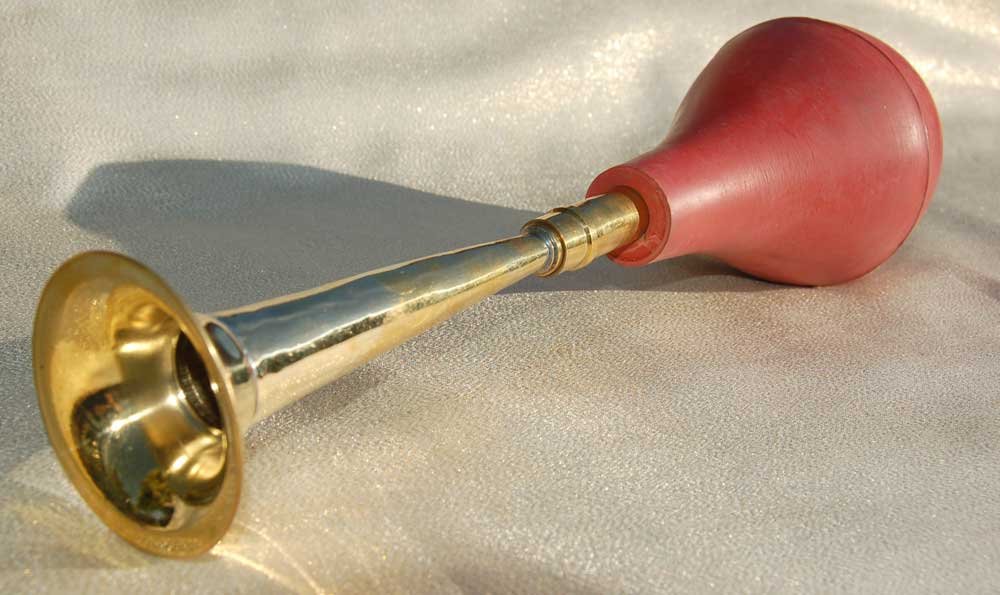

It could also be the switch contacts. I think the horn button is in the center of the steering wheel - i can never find it when I need it but I'm sure you know where it is. If it is it may be the dreaded clockspring wiring at fault. Accessing that is no better than the horn units and care must be taken with the airbag that lives in there.
I'd bodge it and buy one of these: -
