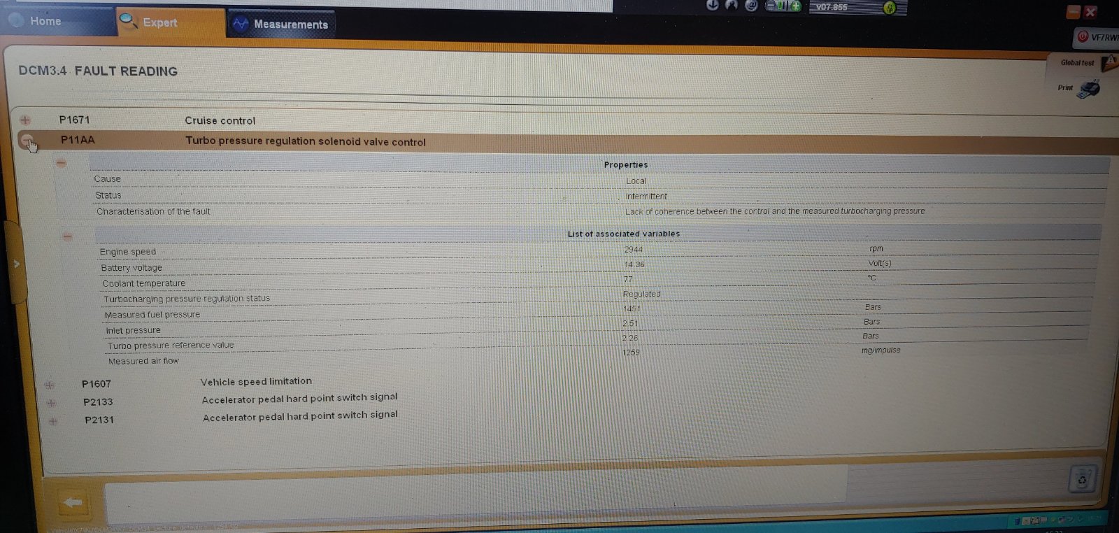

To me that looks like 2 faults - a permanent one (P11AA) which is the same as your first post on this, and on your top screenshot of the 2 above, there is a temporary fault regarding the open circuit. Is there another fault code? - if not, then that is separate and as it's temporary, it may not generate a code and will clear - but if it becomes permanent, it will likely generate a different fault code.
So with that secondary info, I would double check the electrics.... as if it is intermittently having a supply fault then it might be enough to cause the original P11AA fault.
You might possibly get some more information if you use Diagbox Alasdair.

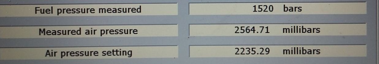

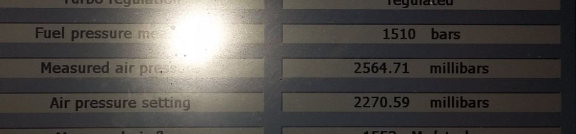

These look like different fault events, as some of the numbers are different:
But the measured pressure is exactly the same to 2 decimal places. Have a look in the live data, and see what it's reading - my guess is you will find it is reading that figure even with the engine off.... I suspect the pressure sensor (or wiring) has had it. As to where it is.....????

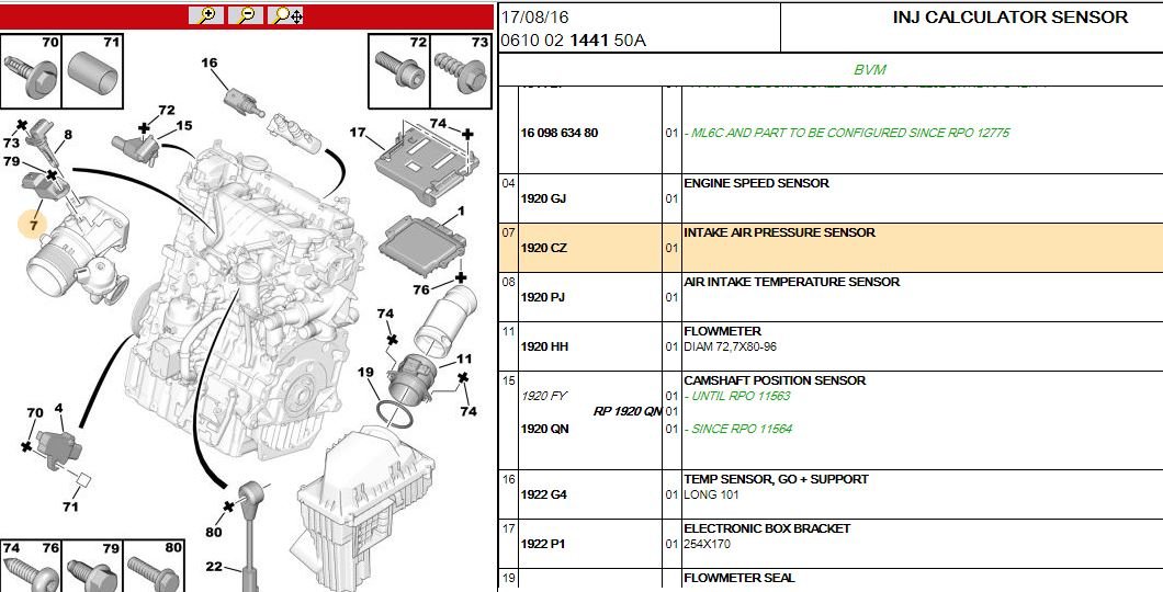

Right on the front of the engine by the looks of itRichardW wrote: 05 Dec 2019, 07:37 I suspect the pressure sensor (or wiring) has had it. As to where it is.....????
£95.96 from Citroen mind you.... but available for <£20 from the bay of evil

For that reading of 2564.71 milibars (256.47 kilopascals), the voltage of the inlet air pressure sensor should be circa 3.6 to 3.7V.

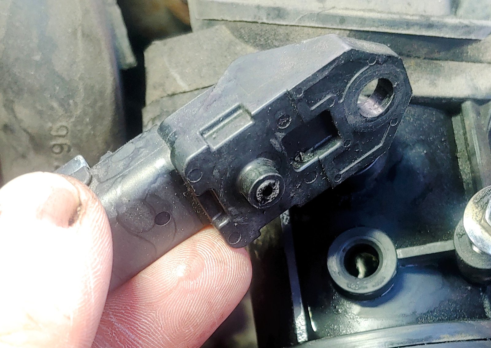

In my case the problem seems to be (at least so far) damaged and leaking boost pressure sensor.
Found out that some previous owner has broken the sensor plug. Sensor was attached with some gasket sealant but was slightly leaking.
Didnt have new sensor on hand so reinstalled the sensor with sealant and added a cabletie to hold it firmly on place.
So far so good, no fault codes yet with a few days of testdrive.
I'll order new sensor and install it later.
