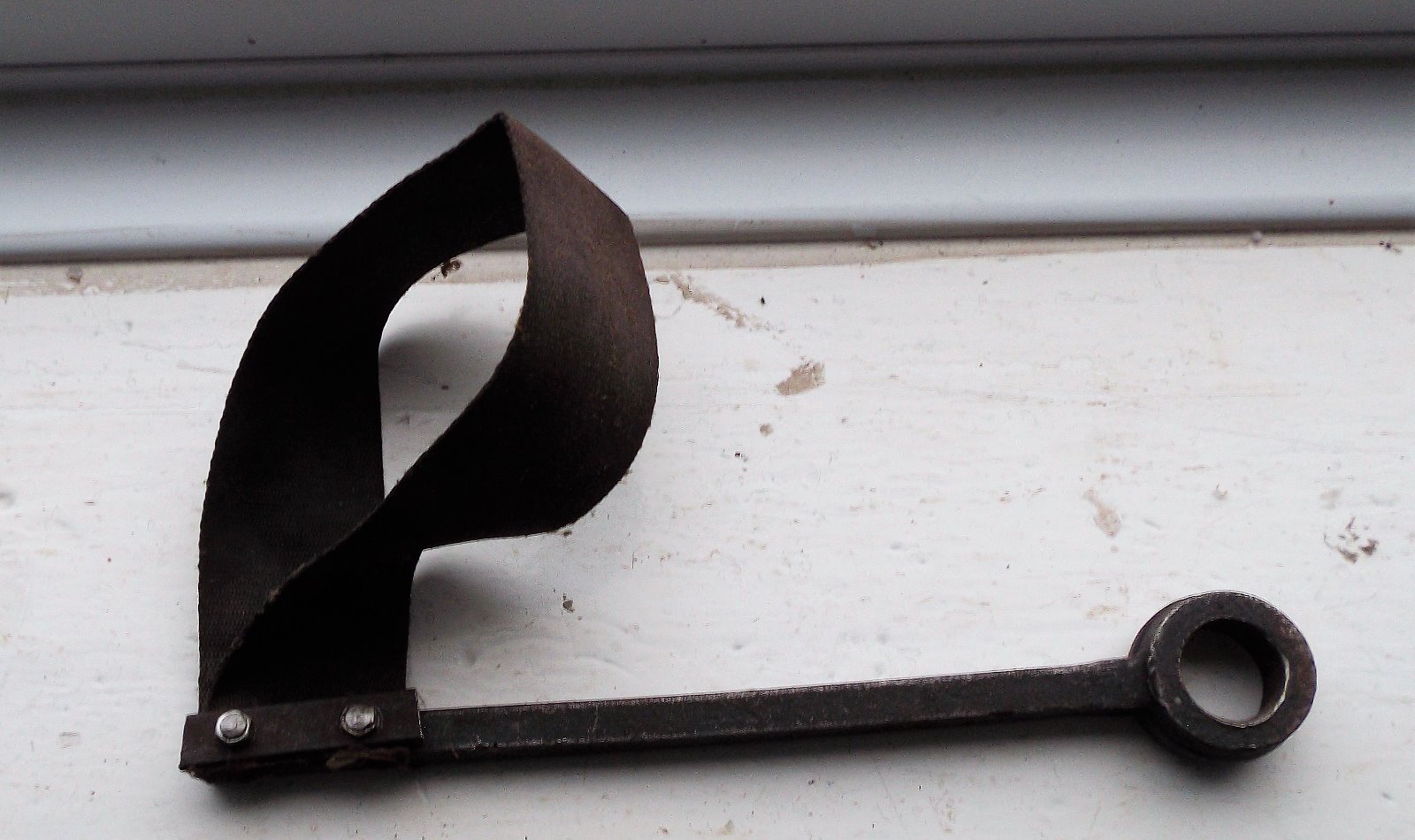

Hell Razor5543 wrote: 13 Dec 2017, 06:00 Nope, I wasn't that bothered. It is just the webbing that broke, and if I can get hold of some more, and get it securely stitched, it will be simple to fix.
I used an old seat belt to make a webbing filter remover, cut it to the right length then bolted it to an old jack handle, must have done good service for more than twenty years now.

I made a similar item some 35 odd years ago. I bronze-welded a duplex timing chain onto an old 1/2" drive socket. It worked perfectly until I mislaid it one final time.

Done the same, with seat belt webbing slotted through a slit cut in an old long socket tool. The webbing tightens on itself as the tool is wound up.
Having used chain and strap wrenches for many years, I must say I do now like using large diameter filter sockets. Minor disadvantage is needing to stick to a chosen make/type of filter which the tool fits.

This particular filter on my Ka is the one I snapped James' webbing on. I'd serviced the Ka in the office car park on Sunday as it was covered and wind-free but failed miserably to remove the oil filter. Obviously, I'd already drained the oil, so wanted to get the new filter on asap as it was full of fresh clean oil.
My trusty oil filter pliers, which have never failed to remove any oil filter couldn't budge it. I even mole-gripped them shut to get maximum squeeze on them.
My phillips screwdriver through the filter and lean on the handle - failed. It simply ripped the metal body of the filter
My 30cm long T50 T-handle smashed through the filter - simply mangled and tore it even more. Wouldn't move.
It then snapped James' webbing - I had a 2ft torque wrench pushing as hard as I could on it. Still didn't move.
I then fumed and let James attack it with a large cold chisel and a BFO hammer on the base ring.
IT STILL DIDN'T MOVE.
I called the scrapyard. I was 5 mins from scrapping the car. Not paying anyone to remove it on a £200 car..
Got my dremel out. Cut out chunks of the filter around the base ring, used up two cutting discs and my vocabulary of curse words, in both English and Spanish..
Finally, it came off. 3 hours!!
Fortunately, the fuel filter I've just changed, with all it's potential for snapped brittle fuel lines, broken holders, jammed clips and so on took me all of a minute to change. Obviously, it would, as I'd got all my tools out ready, rags, put it up on ramps etc. I could have done it with one hand with the car on the ground..

My strap tool has a 1/2" square drive hole and a 21 hex head (for a 21 spanner). I will get some suitable webbing and replace the failed webbing. I will try to get the stitching done, then folded over and done again (assuming that this will still pass through the slot). I will strongly suggest (based on what happened to Michel on that BLOODY filter!) you make sure the stitched section is in the slot when using the tool, as it was mainly the stitching that failed. If the stitching is in the slot the overlapping webbing should protect the stitching from being over-strained.
