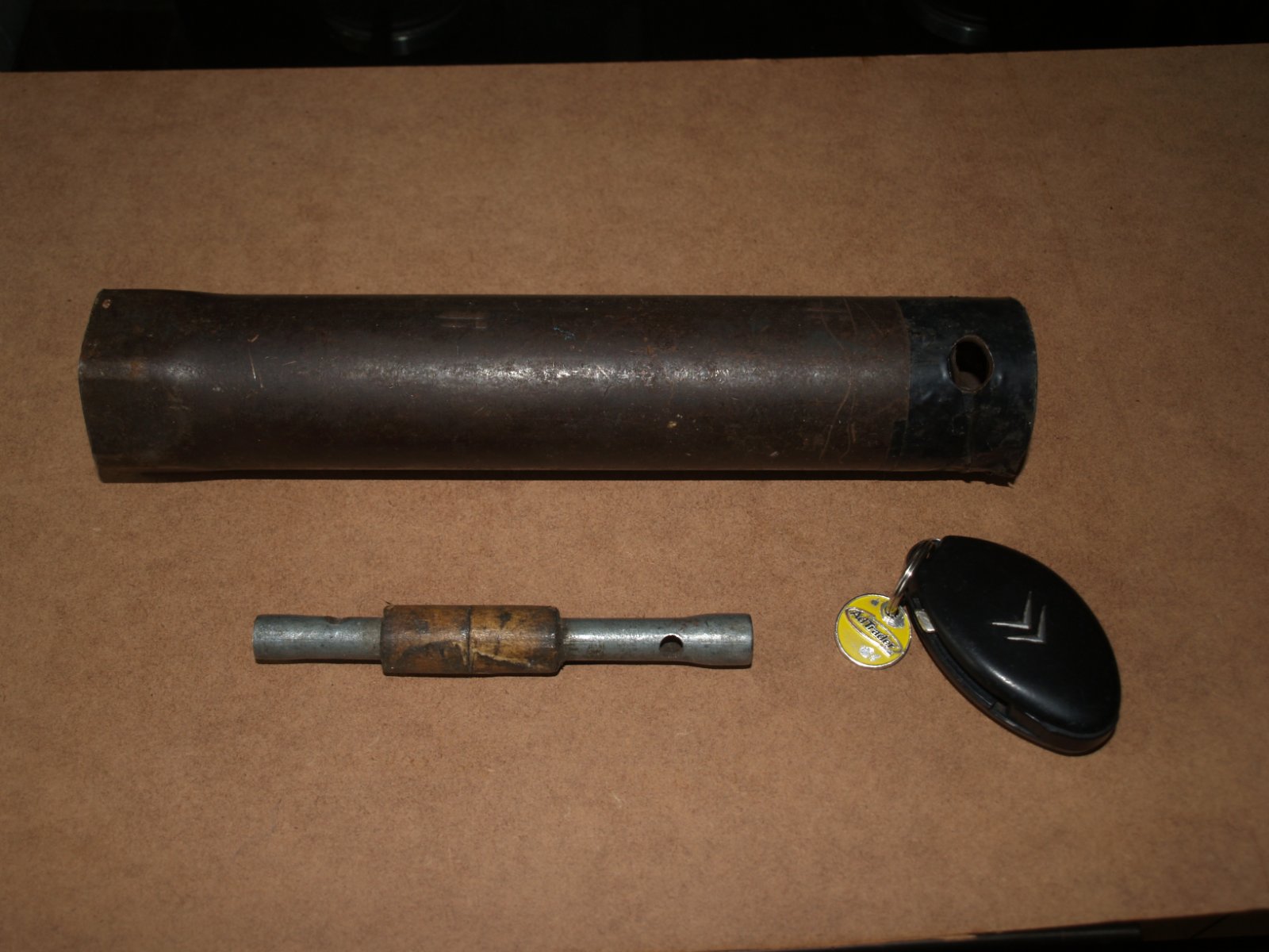

Found the Citroen specific one, used on the GS rear hub nuts.
Was ineffective as the nuts are , it the words of Sir Jim, Biblically Tight.
Discovered the official method was to smash them off with a cold chisel and fit new C-nuts and hex nuts and wind them up as tight as possible with the tube spanner - or a socket that I couldn't afford at the time.
Other one and key fob for scale, although some of my dad's tools would dwarf it.

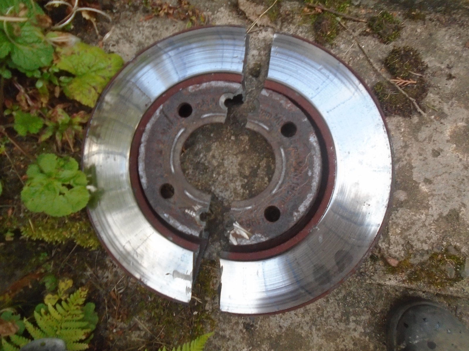

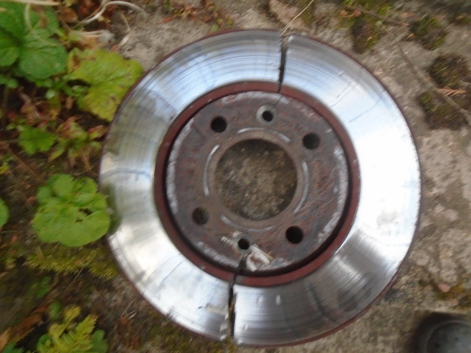

Disc Removal for the desperate.....
Worked yet again for me today

A trick I have been told (for driven disks) is to undo all of the bolts (so the only thing holding the disk in place is rust), start the engine, put the car in gear (first), and then hit the footbrake. The shearing action should break one of the disks free. Put the car in neutral and turn the engine off. Secure the loosened disk (with the wheel bolts), start the engine again, put her into reverse, and repeat. It should break the other disk loose. This cannot work on disks that are on 'free' wheels.
Obviously the car has to be properly supported, and when the disks come loose it can make a bit of a pop. I have NOT tried this for myself, but I have not (as yet) encountered disks that are so securely rusted in place. When I have changed brake disks I had smeared copper slip grease onto the wheel hub before fitting the disk, so that it should not rust hard into place.
- x 1750
Re: Toolbag Tales-Homemade and improvised tools
Some discs (and drums) also have a couple of threaded holes between the main studs/bolt-holes, into which bolts can be inserted, and tightened down, thus pushing the disc/drum away from the hub. If this doesn't make it pop off, with the bolts well tightened down, clout the disc/drum with a lump hammer, and the impact should spring the disc/drum off.
The same threaded holes can be used to squirt some WD/PlusGas into the rusty gap between disc/drum and hub.

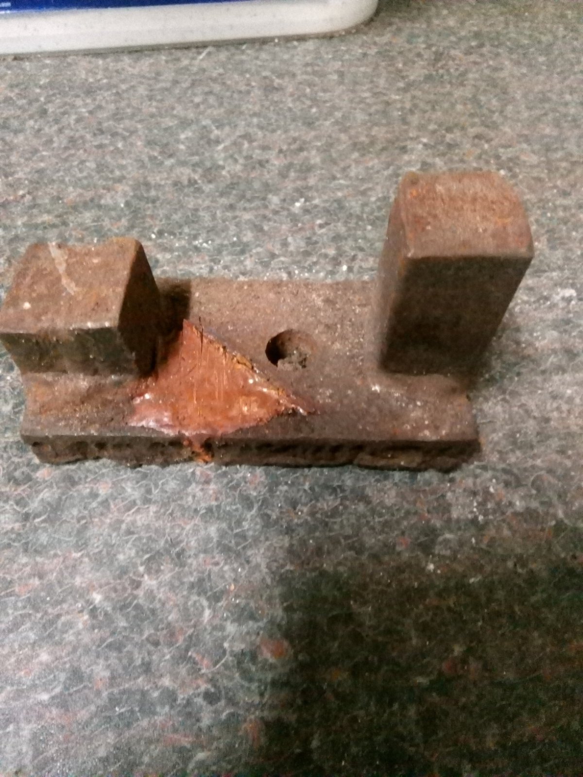

Can anyone work out what this homemade tool is for?
Oh buggle
- Posts: 20318
- x 7855
Maybe for lining up capping on the top of a wall?
Place longer leg against wall face with shorter leg level with capping and then position cap against shorter leg?
doctle
- Posts: 947
- Joined: 16 Oct 2014, 12:17
- x 226
Its for pressing in the back axle bushing on a Mk3 vw golf. Nasty little bugger to get in. Needs must when the devil fits a bush on a Saturday evening without the proper tools

Ingenious suggestion!mickthemaverick wrote: 24 Sep 2019, 21:39 Maybe for lining up capping on the top of a wall?Place longer leg against wall face with shorter leg level with capping and then position cap against shorter leg?

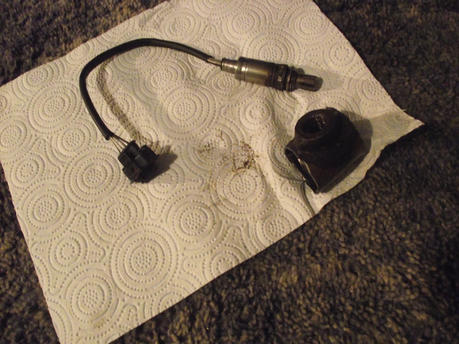

Shear Head Bolts
Any accumulated wisdom or top tips on removing shear head bolts?
This type of thing, which you will come across should you ever wish to remove an ignition barrel from the steering column (for a legitimate purpose of course!) like renewing the ignition switch which has nigh on impossible access problems to the screws retaining it without removing the barrel.
They are purposely designed so that the Cutting a "slot in the top" and using a screwdriver is hampered in that they are recessed just enough to make grinding with a dremmel likely to slice into the steering column at the same time
- Posts: 6833
- x 3556
If the head has already broken off, then you could try roughening up the remaining 'head' and bond something onto it (JB Weld ??) so you can undo it and just pray that it wasn't done up too tight in the first place.

A nut in the earth clamp of a welder then put a spot weld inside the nut. They aren't very tight disconnect the battery before welding
