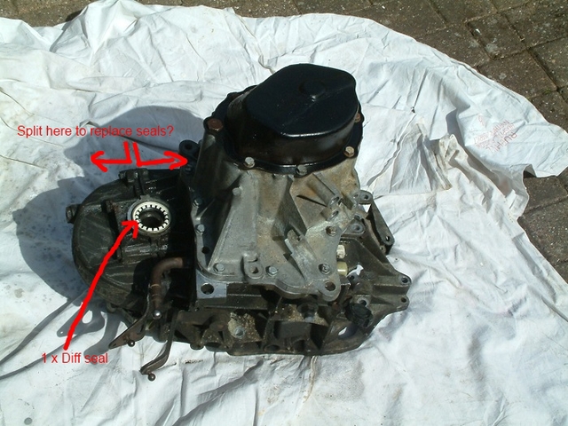

Ahhh, so I don't need to split the diff off of the gear box as shown below? :)
...And the other diff seal is on other side...

Nope, no need at all to split the box :) 5 minute job to change both.
It's the kind of job i'd do straight after making a cup of tea while it cools

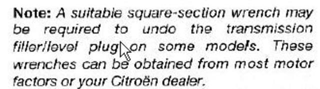

Anyone know the size of this square oil drain plug tool/s?

the drain plug key is 8mm square as below
