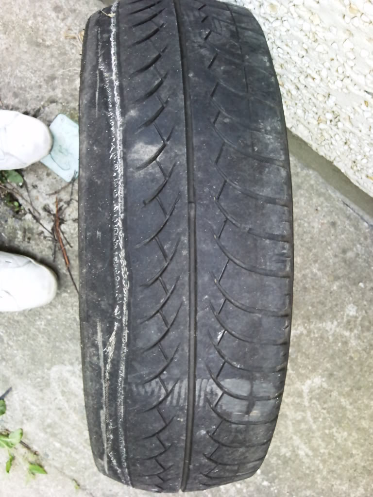

I went to the beach on Monday and when i was driving back,As i was going around the roundabout looking at the signs and not paying enough attention to my position on the road i clipped the front wheel off the kerb :evil:
A minute down the motorway and i heard a knocking in the front that sounded like the wheel bearing and i taught oh great just what i need 50 odd miles from home .I pulled in to the hard shoulder and luckily enough i was happy that it was just a flat tyre ..Here's where the fun started ](*,)
I took the spare wheel down,and that was basically flat aswell :cry: I was only 300 meters from the motorway exit and if worst came to worst i was prepared to carry the spare to a garage and pump it up there.Then i had a look for my jack...Nowhere to be seen :dunce: ..All i had on me was €20 ,so with no other choice i had to ring directory enquiries and get a some cowboy sent out to me.
€65 call out fee :eek1: He was the biggest cowboy going,he was literally there for 3minutes wheel off ,wheel on ,smallest amount of air possible.Pump it up at the next garage he said to me #-o and you'll have the bill in the post...of which i'v yet to see :roll: ..I must mention that i had to put it on my girlfriends fathers creditcard because he was happy to just get back in to his van once i told him i only had €20 on me,of which he took too :(
So i limped to the garage with my hazard lights on and he hadn't even put 10psi in it ffs :evil: I felt sick all the way home :( and if that wasn't bad enough i had two idiots giving me the finger and making all sorts of gestures to me,it was unbelieveable and this was when i was just sitting in traffic :roll: .I guess it takes a special kind of person to be so tough when they can lock their doors and drive off ..(-expletive removed-)!! I got the reg of the car do..

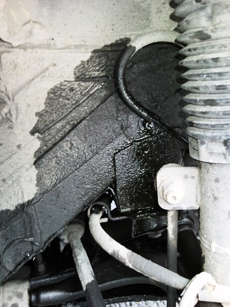

There's a pipe leaking fluid now and the car doesn't feel to great either.I don't know what damage i'v done but it just doesn't feel safe to drive at all
This is the tyre that was taken off,words can't describe it!!.A 6month old tyre

The hydraulic leak you have there is the suspension cylinder leak off return pipe. These get brittle with age and eventually spilt.
Is a low pressure pipe, so splicing in some new rubber pipe will get you back on the road again. These returns are available new from Citroen also.

Wow, that is quite a tracking problem you have there! Is that the inside of the tyre which has the cords exposed? Looks like it might have been a little soft too?
That was a bit of an ordeal, its a shame people take the mick where call outs are required. It might pay for you to be a member of a recovery service for future use. Their fee is rarely more than you paid to get a tyre changed!

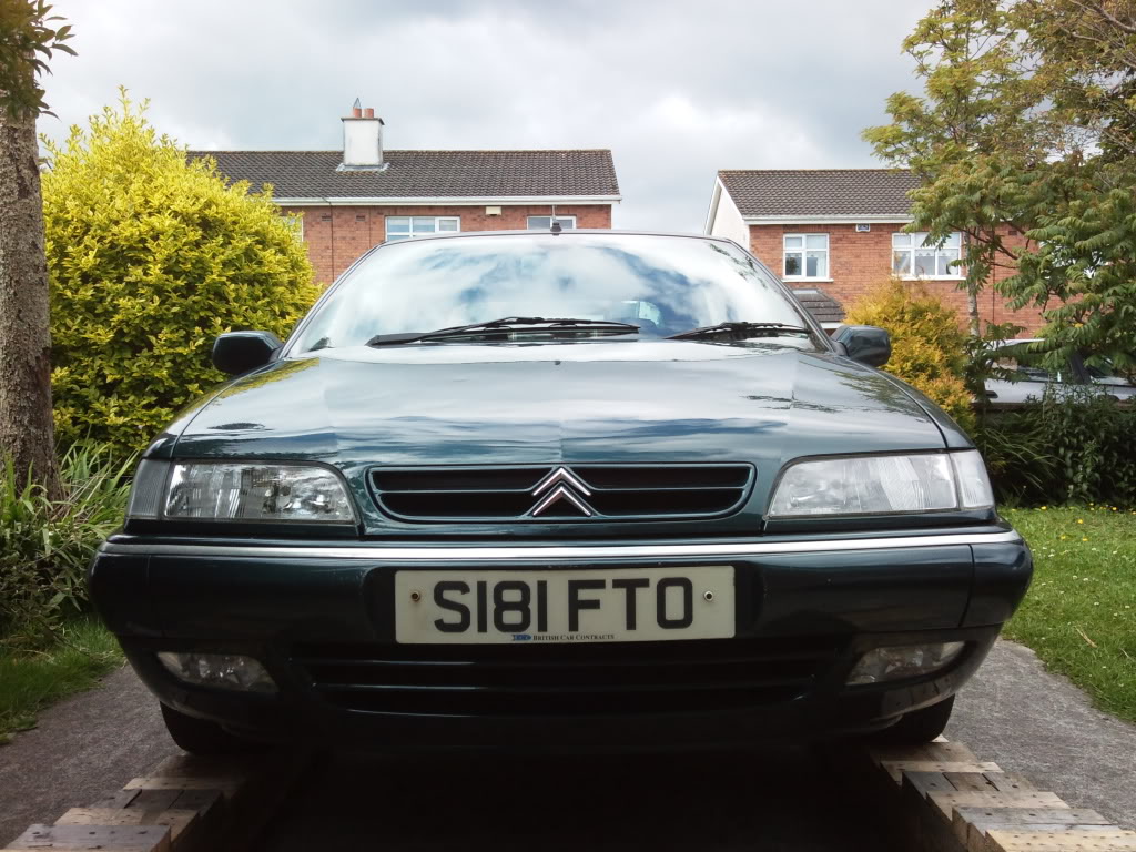

I bet the ride is so much better now too, even better again with the rear ride height set ...
What is it parked on there? Is that just your drive or some homemade ramp affair? :lol:
24 Toyota Yaris Hybrid
03 Seat Arosa 1.0S
XantiaDaveEire
Posts: 560
Joined: 27 Sep 2008, 02:20
x 4
Unread post by XantiaDaveEire »
Citroenmad wrote:I bet the ride is so much better now too, even better again with the rear ride height set ...
:lol: Homemade ramp affair :lol: Easy access for getting at height correctors ,spheres etc ...
I haven't set the rear height yet ,hopefully tommorow if the weather isn't too bad :)
Out of the 4 Xantias i'v had, only my silver car is the softest and what i would expect a hydraulic citroen to perform like,i don't know if that is really a criticism :?
I hope to know more when i correct the green cars height,it seems like it is on the intermediate height at the back currently,but the front is lovely and soft....
