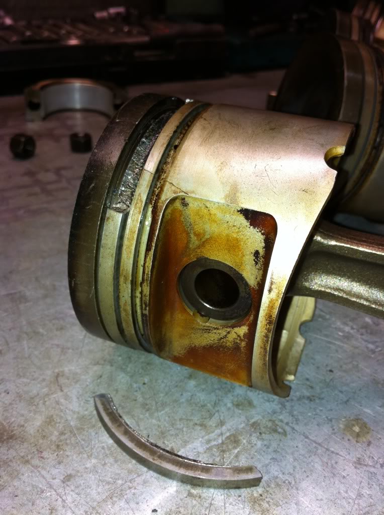

I was going to change piston rings today, but then i noticed something nice..
Piston rings we're holding it together so i didnt see any cracks until that piece came off

Unread post by XantiaMan »
Thats a common failure, usually a bit too much advance for the boost/fuelling, or just reaching the limits of the cast piston.
