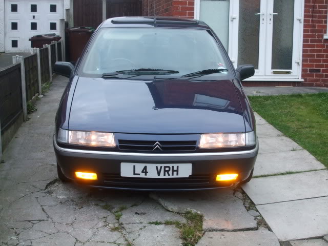

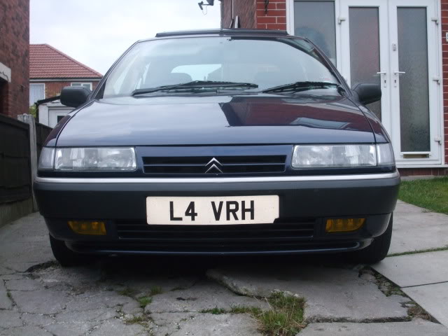

In the meantime, I have converted my front fogs to old style french yellow ones......I like them when they are lit up (the photo makes them look a little washed out but they are very yellow) but i am undecided whether i like them when they are off....opinions are welcome
Notice the nibbled off corner of my number plate....i nudged into someones towbar at the lights a while back
As far as your dash bulbs go, from a chat i had with Citroen the other day the bulbs differ with the make of clocks you have in...im not sure if thats true but i have Jaeger clocks in mine so they are 286 push in bulbs apparently. I will find out when i take the clocks out...and see if they were right

I like them, want to do the same for mine. Is it just yellow film over the glass?
