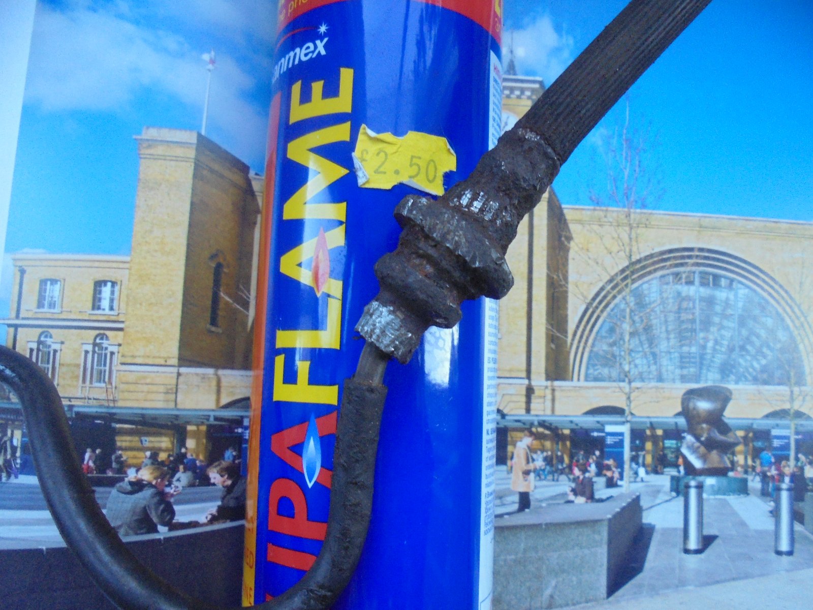

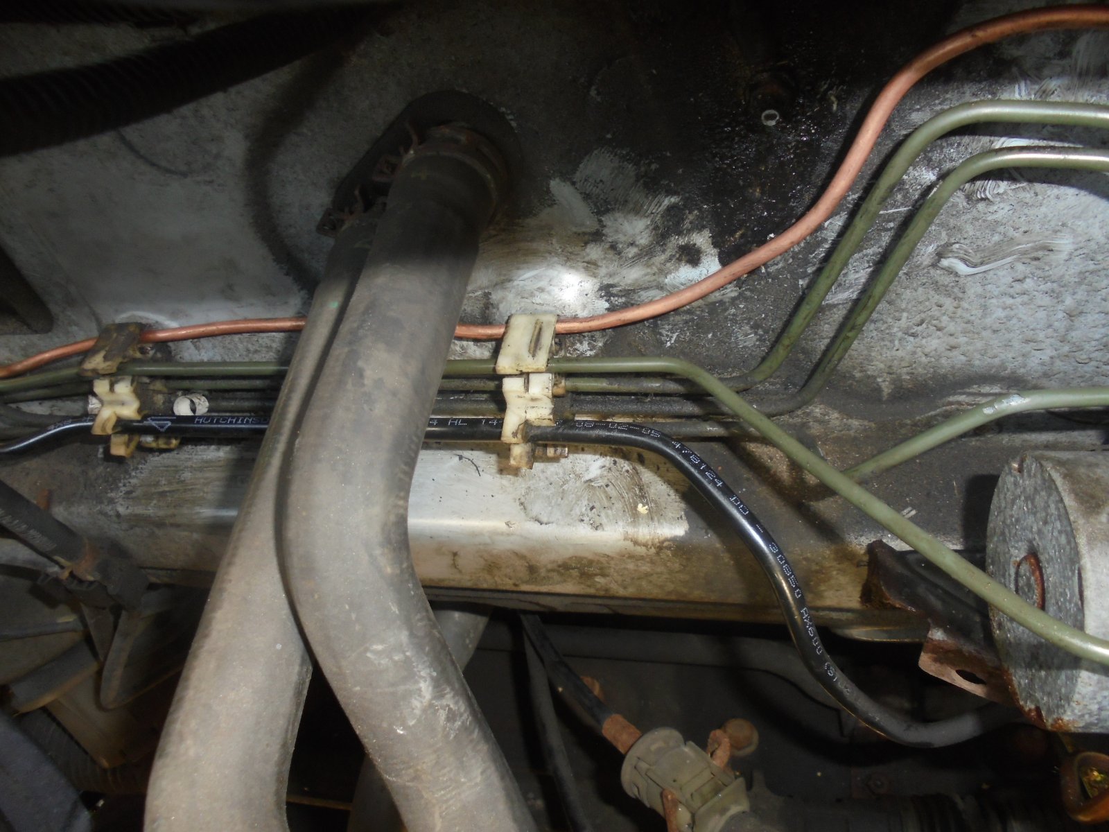

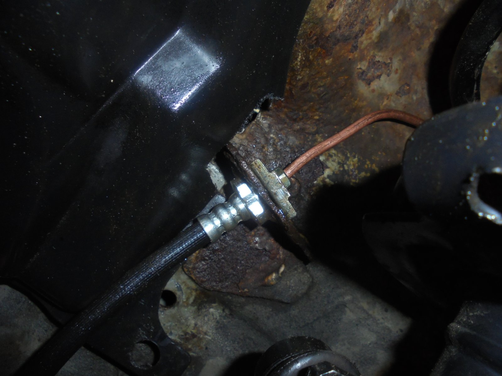

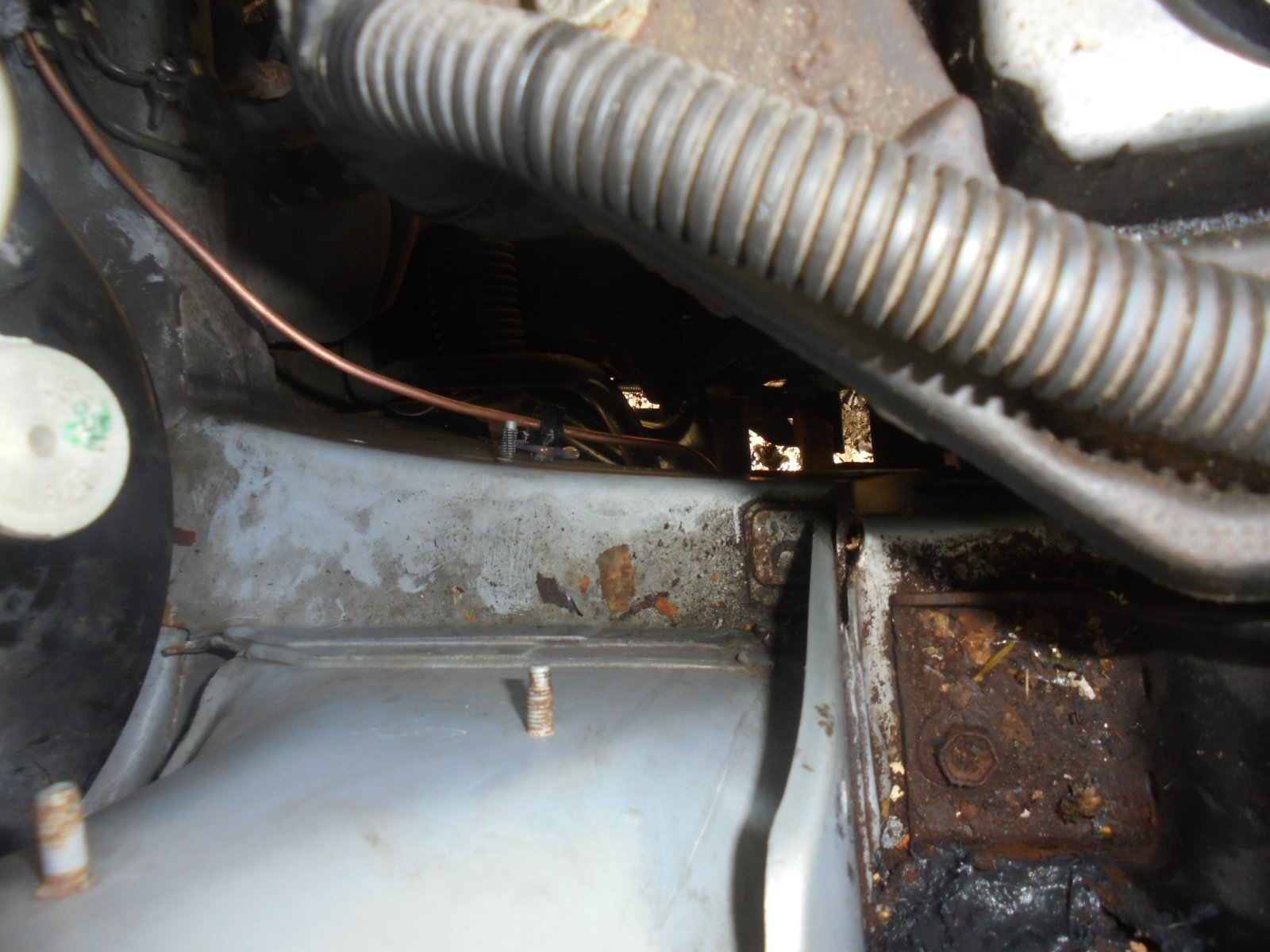

Thought I would give the undoable union another go after spending £2.50 on a can of butane to fill up the much neglected pencil torch. It wasn't budging so the hacksaw came out to play. That union was a right-off, right from the start. Should I get round to doing the other side at any point in time how many minutes before the hacksaw, 2 or 3!
Had to make the pipe in situ on the car as I needed to thread it through those plastic clips on the bulkhead, because I just couldn't work out how the back row of brake pipes came out without breaking the clip. Those at the front just prise out.
I discovered also that the ABS union end was not normal size. Same 11mm head but meatier and a different thread. Had a new one which was a decent approximation but reused the old one.
Didn't even look at the bleed nipple, broke the caliper end connection to do a bit of bleeding.
So BB Micra for now is back on its wheels, ready for the MOT man to examine my handiwork.
POTD Thought I would give the undoable union another go after spending £2.50 on a can of butane to fill up the much neglected pencil torch. It wasn't budging so the hacksaw came out to play. That union was a right-off, right from the start. Should I get round to doing the other side at any point in time how many minutes before the hacksaw, 2 or 3!

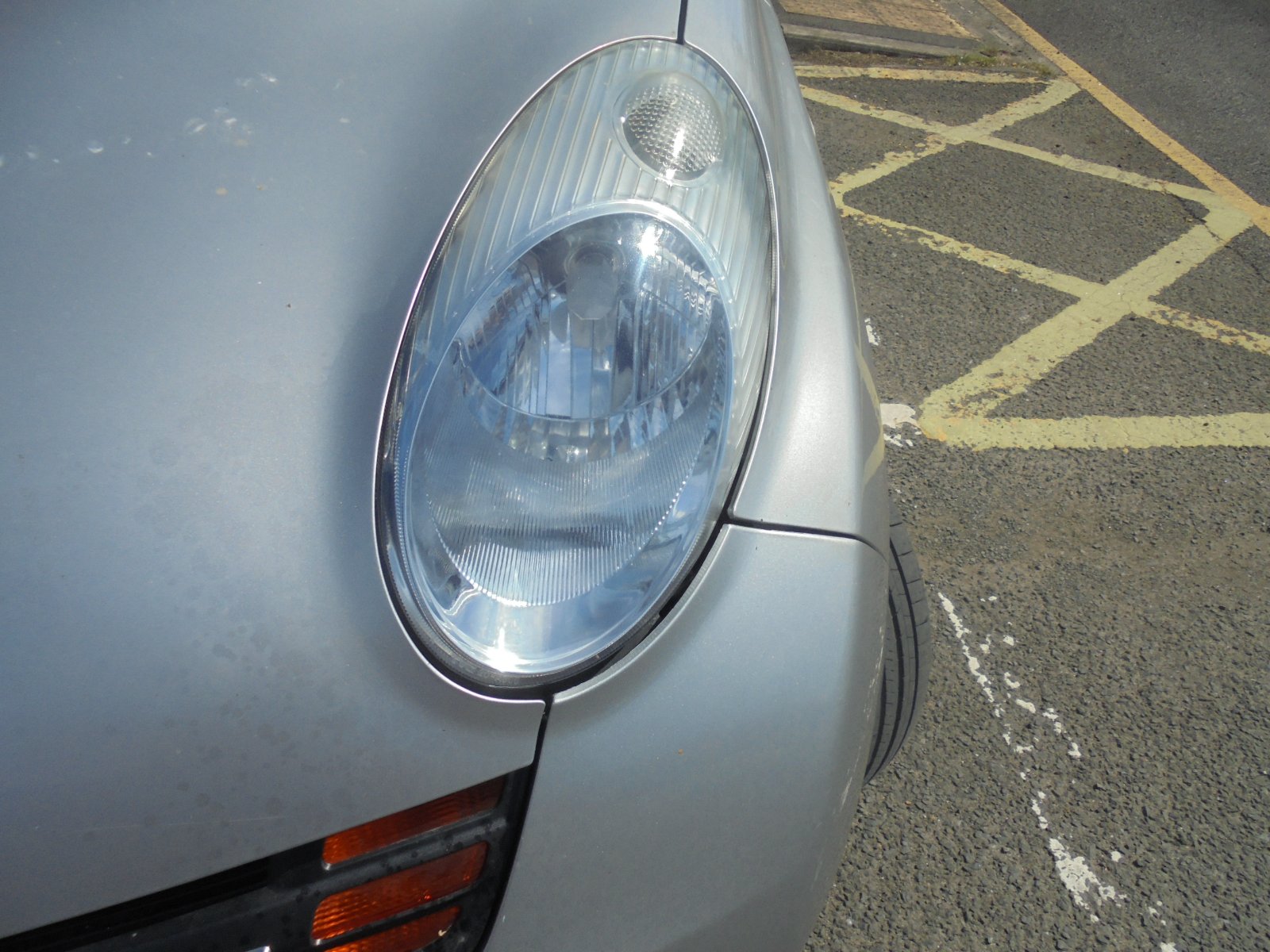

Glad I didn't waste any money on 3000 grit and Windolene the abridged Mick Method was good enough, with just a brief spray of GT85 to give it the crystal clear finish prior to the testmickthemaverick wrote: 25 Jul 2022, 14:17You do realise that if it doesn't pass I'll claim it's because you skipped the most important bit don't you?NewcastleFalcon wrote: 25 Jul 2022, 14:10If it does gets a pass, it would be thanks to the abridged Mick Method (-the 3000 grit and - the Windolene)!mickthemaverick wrote: 25 Jul 2022, 14:06 Glad that's worked out ok for you Neil, A pass without a doubt!!![]()
Handiwork examined and passed, MOT for another 12 Months, well pleased. £34 for the lower arm, £2 for nuts and bolts, £10 for the wet and dry, £6 for the new brake hose retaining clips, £24 for the Brake Hose £6 for the brake pipe, £2 for ends £4 for brake fluid £2.50 for the butane can £90.50 plus the MOT £40, £130.50 in total.NewcastleFalcon wrote: 05 Aug 2022, 16:35 So BB Micra for now is back on its wheels, ready for the MOT man to examine my handiwork.
Plus of course a lot of uncosted time and frustration, but pretty bargain basement.

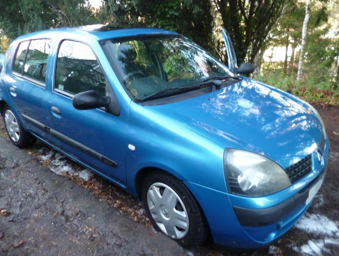

Bit of attention required to the BB Clio the thread started off with...reluctor ring. Yes, it's a daft term and when I enquired at the local factors, they confidently told me they didn't do them. Rubbish as it turned out. Phoned another local outfit TMS, they had them in but a bit more of a trek. I told them what the other factors said, and they said we are part of the same group, they do have them in stock, I can see that on my screen. Anyway, got one from the more convenient outlet, maybe they just call them "ABS rings".
With an older Bargain Basement car which has had 17 years of rust-inducing attrition to nuts/bolts, replacing a reluctor ring will seldom if ever just be replacement of a reluctor ring. First off, track rod end...needed replacing, and while you are on with it the bottom ball joint might as well be replaced too. Then there is the caliper retaining bolts. They are supposedly torqued to 105 NM on the Clio. The dread of cracking them off is that the crack turns out to be the head shearing off the bolt.
Never mind after a day spent running backwards and forwards to the car parts shop to get the parts which I probably should have anticipated would be needed, the job was done all bar the final act, screwing the hub nut back on. That's when I discovered it had been cross-threaded, could have been a couple of schoolboy error hammer blows from yours truly on the driveshaft end. The thread is M20x1.75, given time and a bit of research a die could be obtained to recut the thread, or the end machined or ground to a chamfered or flat end to undamaged thread.
No time to faff about like that. More important to get the job done and the car back in action than delay for another day. New driveshaft for £80 from ECP, in stock at Sunderland, and the almost completed job, stripped down to square 1, and reassembled with the new driveshaft. Better solution all round...the old driveshaft was pretty tired looking, and the intermediate rubber was pretty perished.
Could have had exactly the same driveshaft £20 cheaper at £60, had I had the patience to wait one more day to collect it from any of the 4 or more ECP outlets in the North-East, by ordering it through Carparts4less. Carparts4less do offer collection from any ECP outlet, as well as free home delivery, and I have found exactly the same parts as ECP can be a decent slice cheaper.

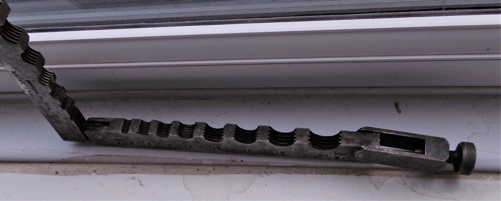

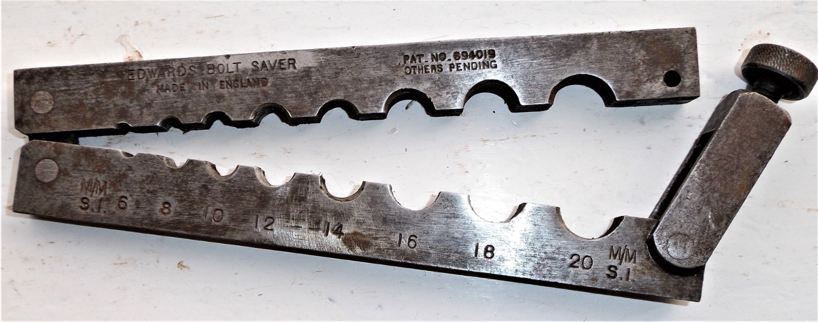

I've got a set of these in metric, ANF/UNF, and Whitworth thread sizes Neil for those bruised thread jobs.
- Posts: 26252
- x 7084
Re: Bargain Basement Motoring
Do they work by chamfering the end of the bolt/ threaded shaftGibbo2286 wrote: 22 Sep 2022, 10:08 I've got a set of these in metric, ANF/UNF, and Whitworth thread sizes Neil for those bruised thread jobs.
- Posts: 7853
- x 2780
Clamp it on part way down the thread then wind it off Neil, it straightens the thread as it goes cutting away the bruising.NewcastleFalcon wrote: 22 Sep 2022, 10:30Do they work by chamfering the end of the bolt/ threaded shaftGibbo2286 wrote: 22 Sep 2022, 10:08 I've got a set of these in metric, ANF/UNF, and Whitworth thread sizes Neil for those bruised thread jobs.
Here's a better picture.

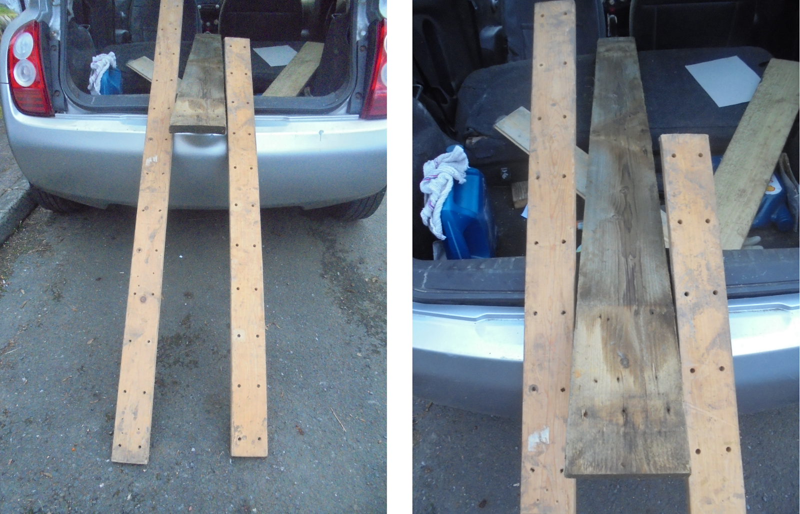

BB Micra assumed heavy haulage duties today. Two-way washing machine transport, click and collect new one, and taking the old one to the recycling facility. Now, at the collect the new one stage...easy. The chaps from Curry's just wheel it out and lift it into the "boot". Yes, the Micra is amply large enough to transport a washing machine without it hanging out the back.
But how do you single-handedly get the washing machine out of the Micra and into the house. That's where the two planks I had taken along for the ride came in. A gentle slide of the pretty well polystryrened-up new machine onto the pavement, and a couple of bits of binding strapping to aid with the manhandling adjustments.
The task of loading the old washing machine up was more challenging. No two blokes from Curry's, no packaging or straps, and with the two planks bit of a balancing nightmare that could easily turn into a very heavy object dropping on my very vulnerable toes, and a bit of a back breaking lift/ push in any case even with the "ramp".
The solution another plank this time in the car and protruding out to act as a balancing point as well as a low resistance pushing "rail" to get the machine fully in the cargo area.
The recycling centre, end of things was much easier, thanks to the helpful lads who just slid it out on the plank to their jack-up-able up trolley thing.
The BB Micra proving itself to be a useful workhorse once again.

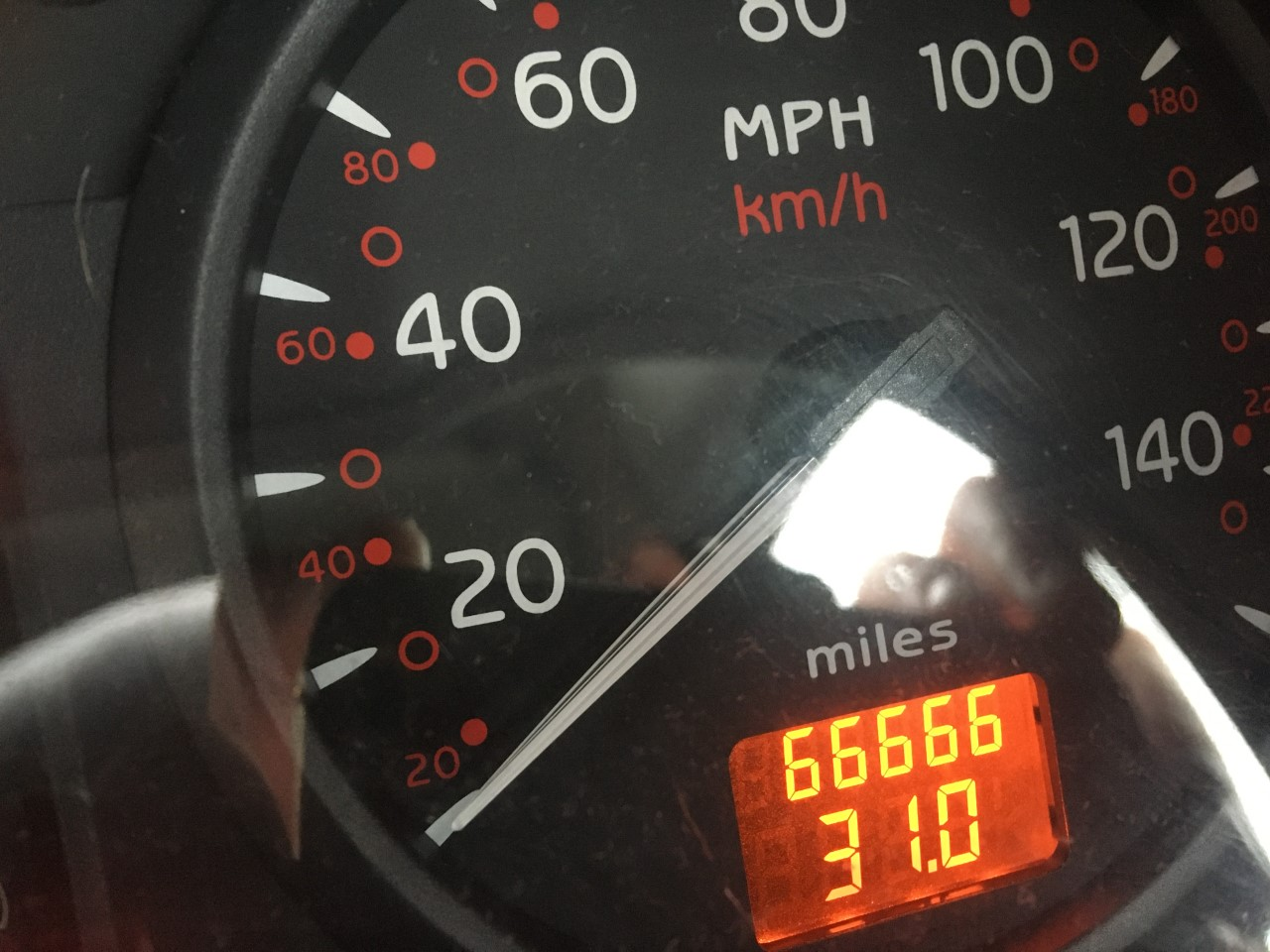

Still in the maintenance fleet today it clicked over to a significant milageNewcastleFalcon wrote: 03 Dec 2017, 14:46 Six Bottles of Wine has just bought me thisCase of right place at right time and being cheeky enough to ask.
4-door Clio 1.2, around 38,000 miles surplus to the owner's requirements. Another example of the "On my walk" method of acquiring vehicles as per Gibbo!
Well pleased
