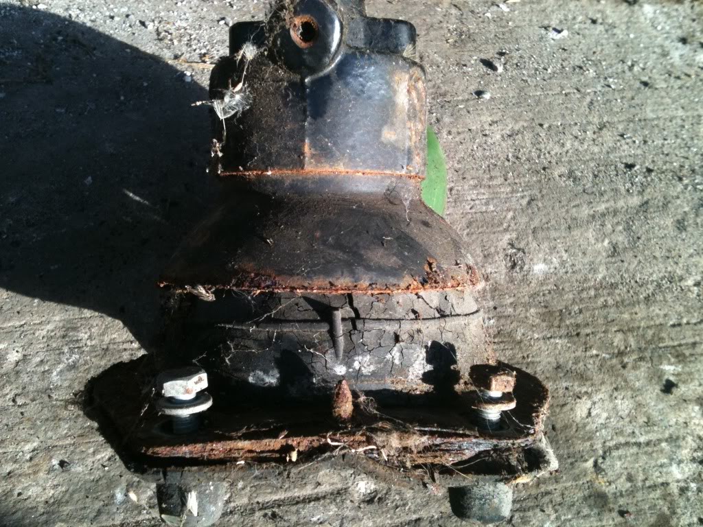

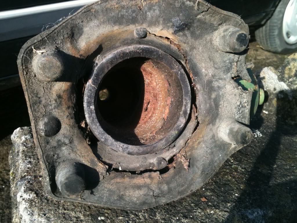

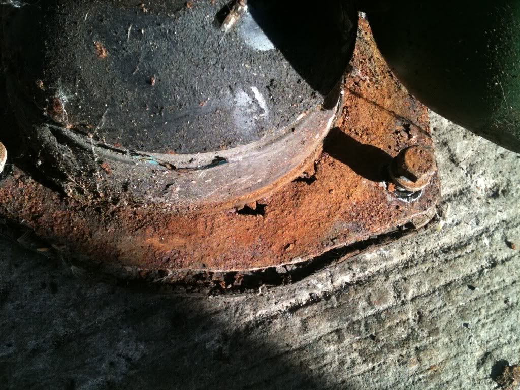

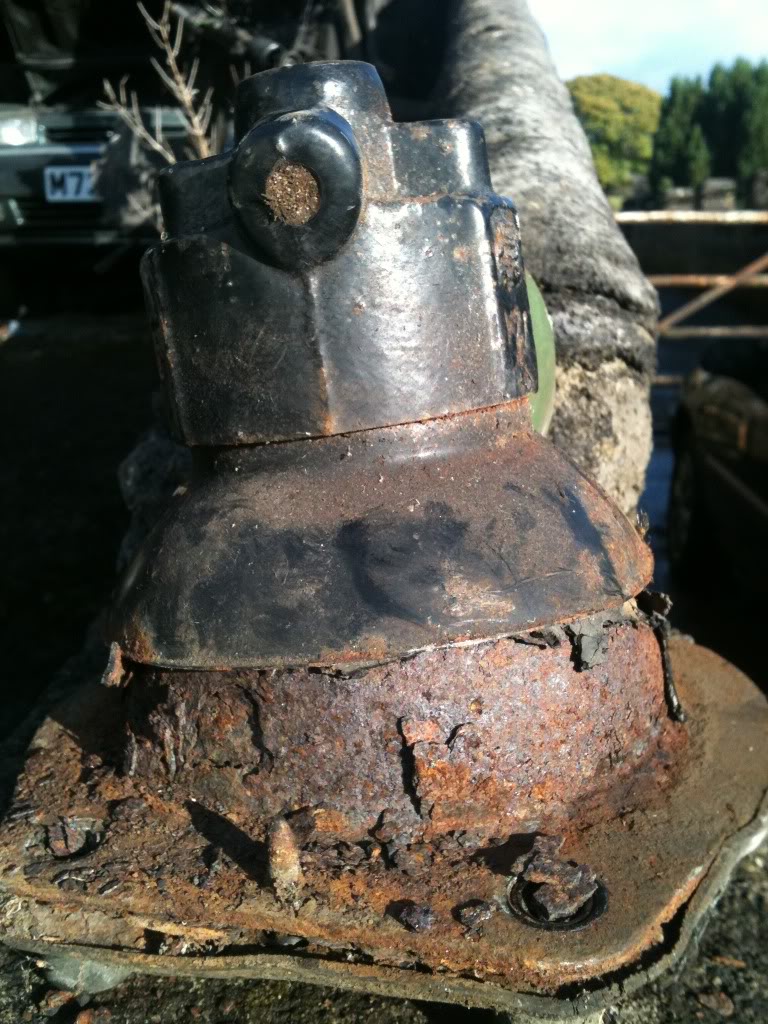

Worse case perhaps but only after the rubber was peeled away.
Just found a pair I removed off a car I broke a while back
- agreed they've got a tad worse since perhaps but they show
just how bad they can get and where they rot out:
this
peels away revealing
It was shocking just how out of true the alignment on the head of one of these
two strut tops is and the bukling of the remaining metal on the mounting plate.
Andrew

They look like something Time Team may have unearthed on an archaeological dig
I can just hear Tony Robinson saying "And here we have a really exciting find in trench 4: a pair of late 20th century strut tops. Oh look, in trench 5 they've just found a strut gaiter..."
Seriously Andrew, were they that bad before they were buried?
