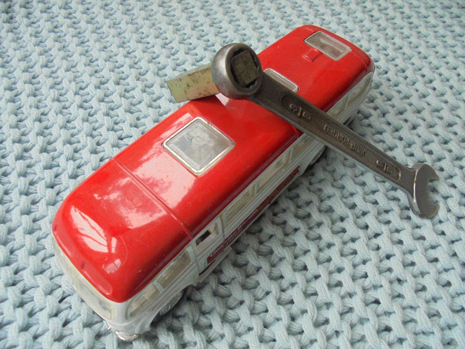

Page 1 post 1 of the thread, a bit of DIY Blacksmithing from yours truly
Just a picture...the details are over here viewtopic.php?p=864923#p864923
Not quite the amateur blacksmithing of making a timing belt tensioner tool I kicked this thread off with in 2017. Nice to see the thread still gets the odd entry. It is the essence of DIY mechanic-ing creativity. Not many will go back to the beginning and read through the thread so for a little indulgence this was my first entry.....
This was the finished articleNewcastleFalcon wrote: 27 Feb 2017, 18:01 ..or alternatively what could I make out of this....
Its a piece of Key Steel about a foot long 8mm x 8mm and by hook or by crook its going to turn into the perfect timing belt tensioner adjuster for a 2.0hdi 8 valve engine, as fitted to my Citroen Xsara Picasso. Suggestions welcome...with the restricted space, and air conditioning pipes between the tensioner and the bodywork its going to as a whole have to adopt an "L-shape" although being key steel its going to be hard as nails and maybe not possible to achieve the sharp bend required. I have used a number of improvised tools over the years some of which I have posted in the past but it may be nice to have a thread to fill up with "tales of the toolbag"

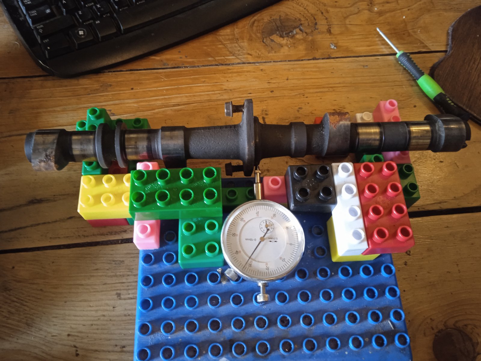

My new camshaft verification jig

Making that job look like child's play!

Just seen this Pete, that's awesome!!!!

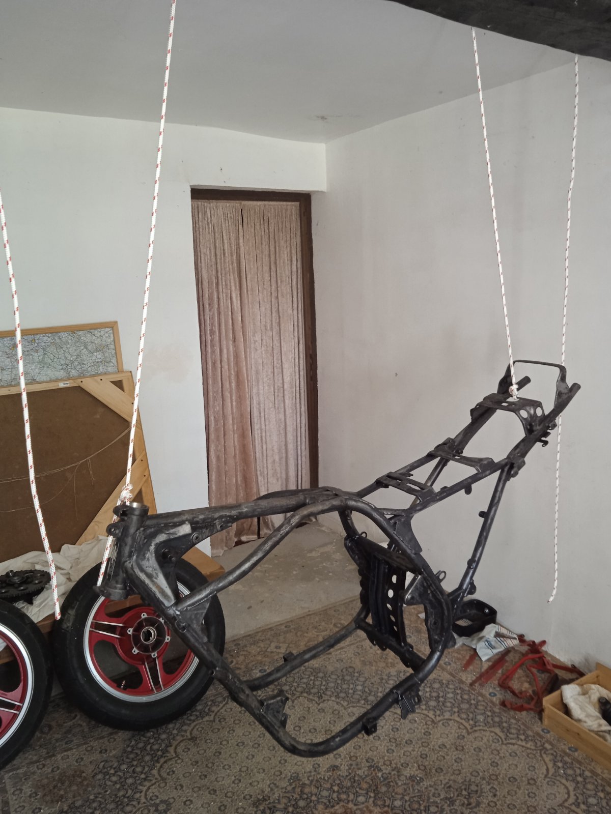

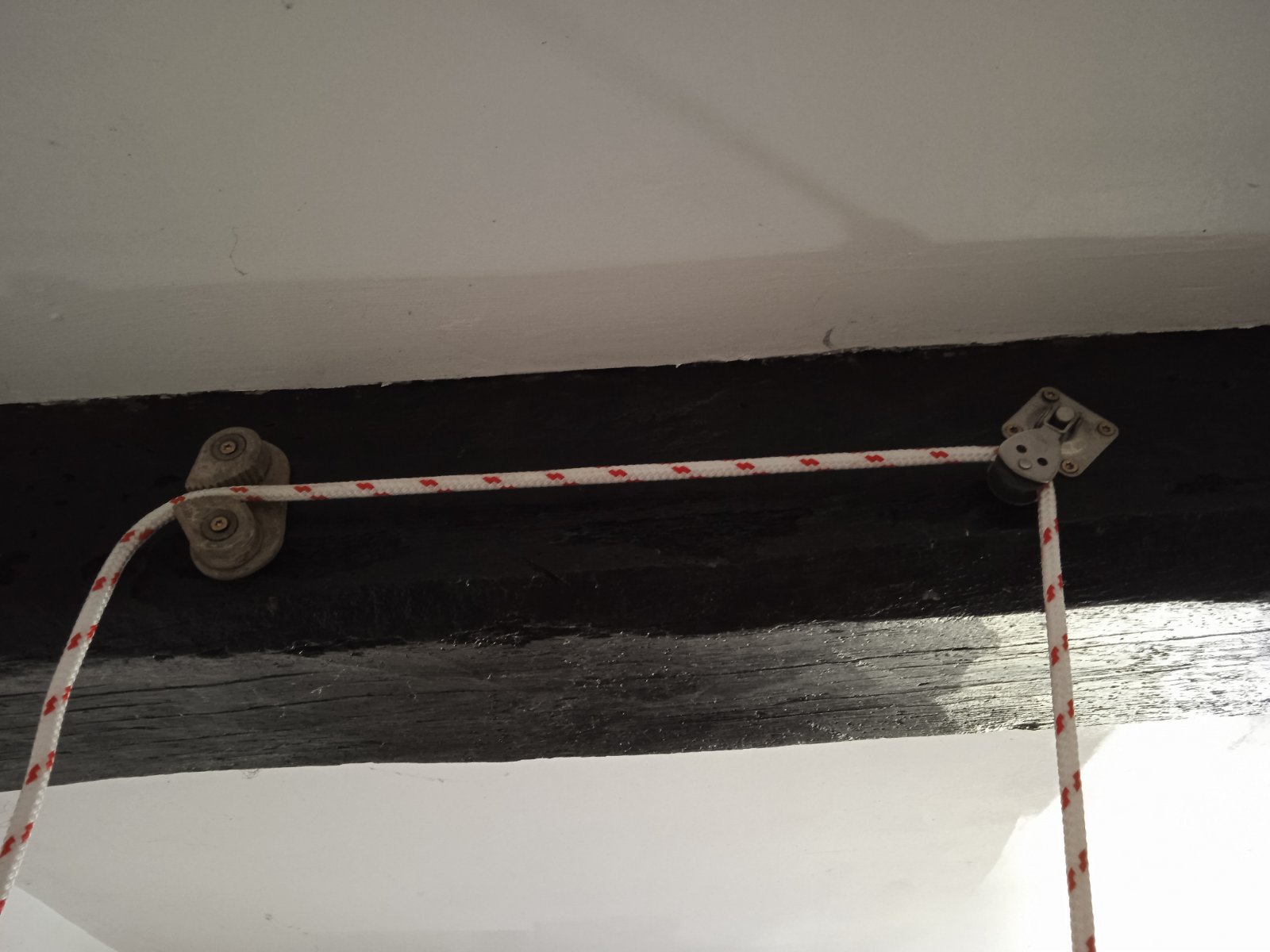

Frame hanging for spraying using old boat sail stuff

That's a proper job Pete!
