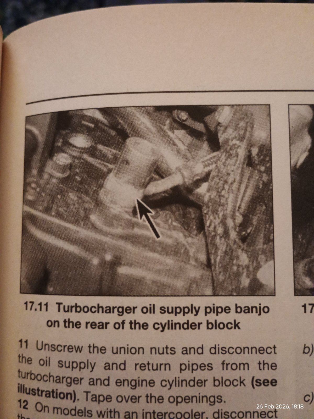

The thing in question gets a picture in 4B "Fuel and Exhaust systems - diesel models" but wasn't logical to put the associated torque setting in the same chapter!?!

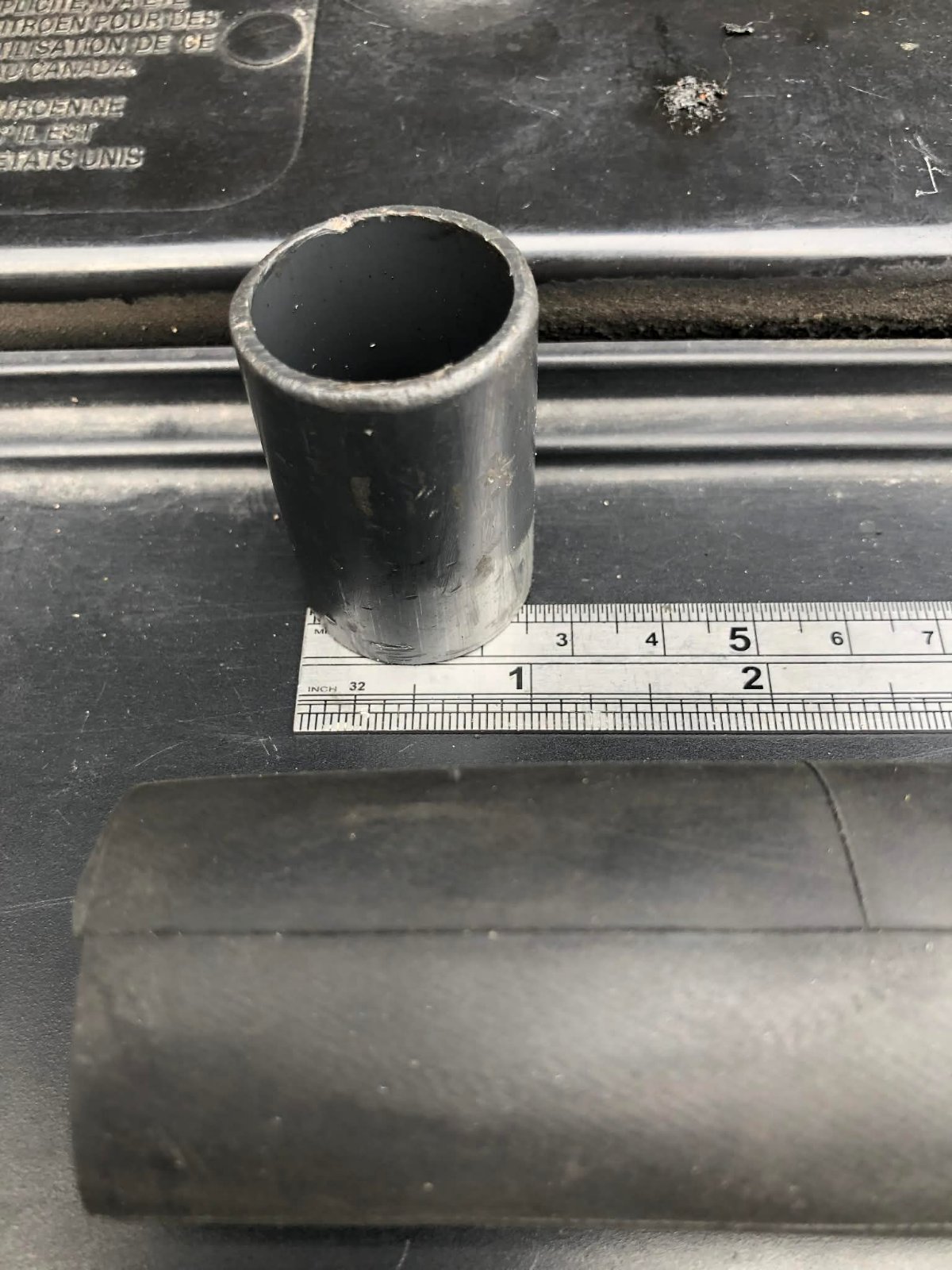

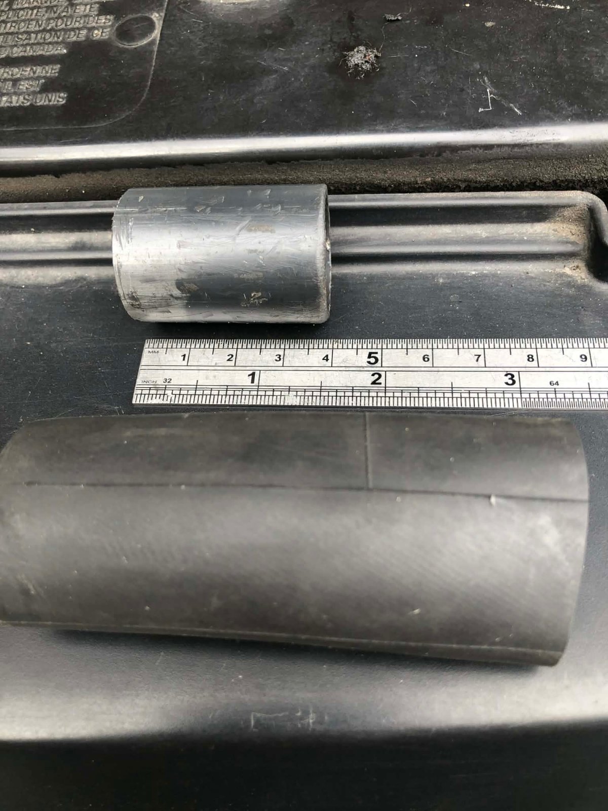

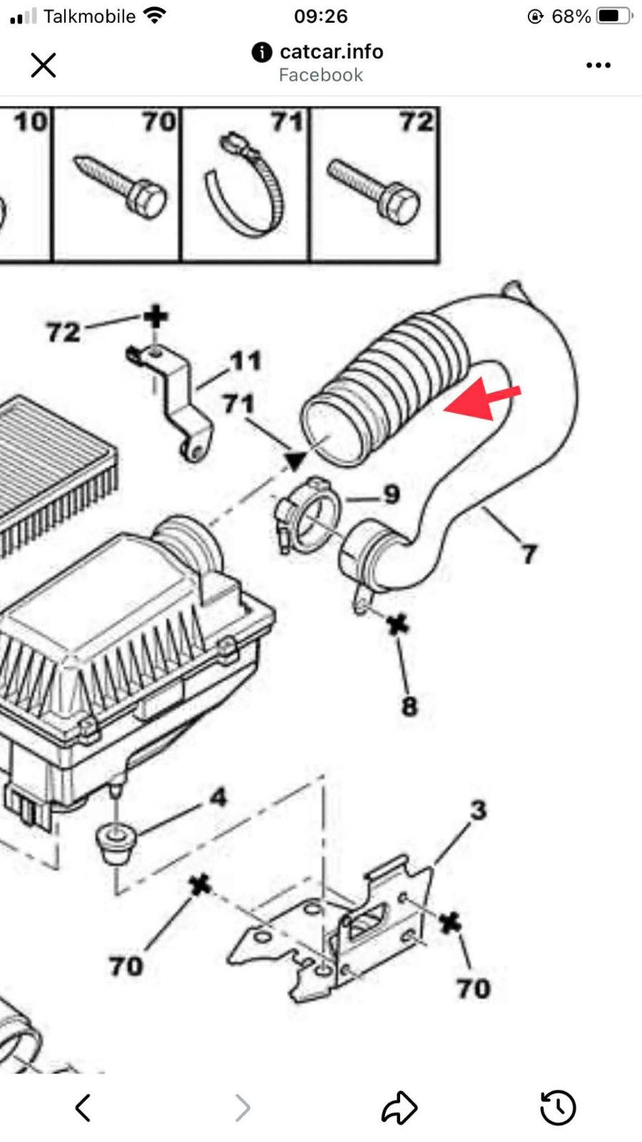

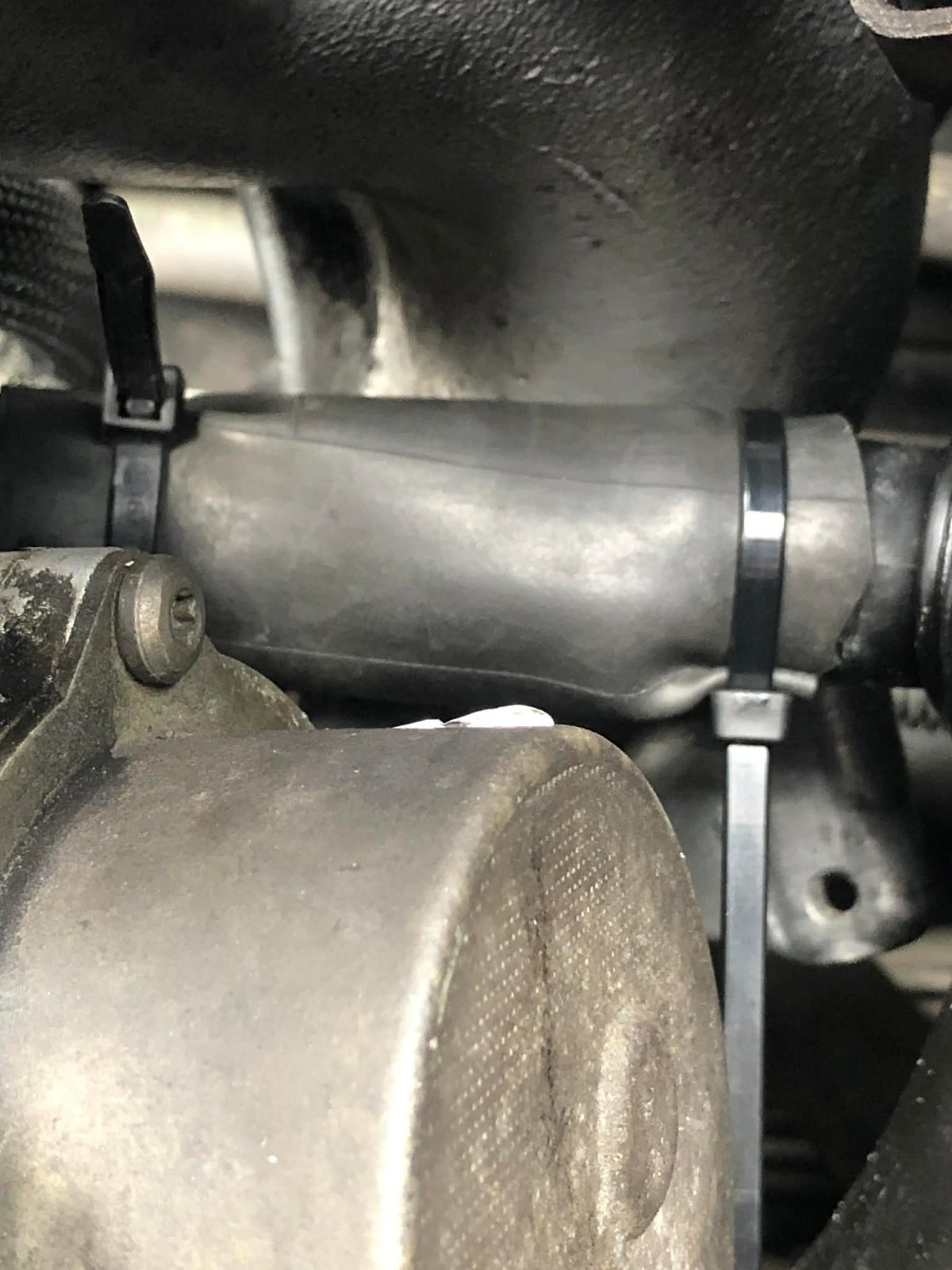

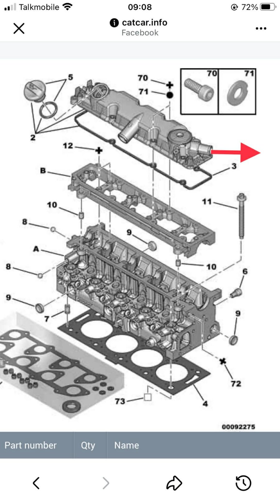

I'm missing a rubber pipe that joins between Camshaft Cover and Air Intake Ducting
Not a clue where it's gone and I can't find the part I'm missing - never mind the relevant part number on these images......
So I made this which hopefully will suffice for now, there were no clips on either end of the original pipe, but as I didn't want the inner tube injested into either orifice I reinforced it with a plastic pipe that's too big to insert fully..... Parts used to replace
The resultant bodge until I find or replace the missing part

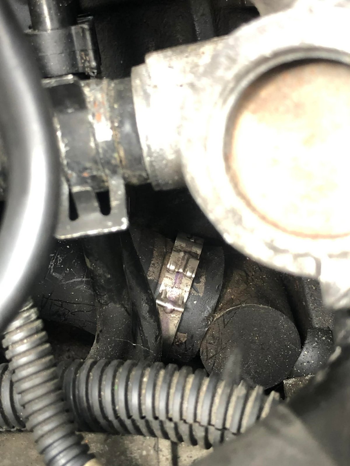

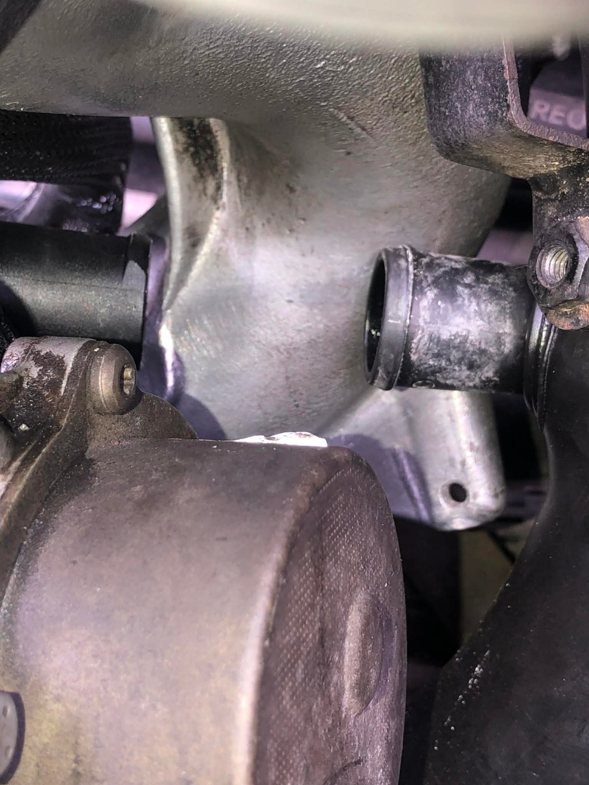

Also whilst tidying some pipework and numerous clips there was one clip spare
I found out where it goes and have got it into situ but I can't get the clip pliers into position as the coolant outlet is now in the way - it's on the bottom of the large and long engine breather pipe that goes from the lower engine block to the camshaft cover - it was impossible to remove despite heating up with the hot air gun so I'm hoping it's tight enough not to leak or I will probably have to resort to a replacement jubilee type clip - an embarrasing oversight on my part probably because I've done this job over a prolonged period

More car prawn.Skull wrote: 19 Mar 2026, 16:08 but as I didn't want the inner tube injested into either orifice I reinforced it with a plastic pipe that's too big to insert fully.....
It'll on the road in no time

It was either that or sucked off/in

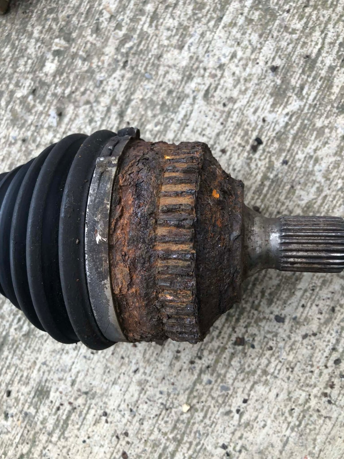

Cheers Jim it's more of a jigsaw than I remember, I've braved going back under the car today with a sheet down to help keep my wound clean which is still weeping (waste of effort) and managed to get the Turbo Support Brackets 2x 5mm Allen Bolt 1x6mm Allen Bolt (15 Ibf/ft) and Rear Engine Mount (3x 16mm Hex - 37 Ibf/ft and 2 dowel pins) and Bearing Carrier mounted and torqued up ready for the Driveshaft to be installed ...
I was preparing to fit the driveshaft but I thought I would clean it up a bit first ...... for several years I have had an intermittent ABS issue at slow speed, pulsating brake pedal but never had a ABS fault logged or dashboard warning light, I inspected all the ABS rings and sensors but wasn't able to determine where the faulty component was ....However after a clean up of the ABS ring it's very crumbly and probably needs replacing....
I think I might as well replace the ring prior to the driveshaft going back in and in the meantime I can get the engine timed up and tested ...

Sheesh! That reluctor ring is in a right state. Hard to believe no fault was thrown. Was this not picked up on Jim's Lexia session?

Rothgar Yeah it's rough alright, it's probably 4 years since I last inspected them so it looks like it's time to change that one at least.Rhothgar wrote: 23 Mar 2026, 15:28 Sheesh! That reluctor ring is in a right state. Hard to believe no fault was thrown. Was this not picked up on Jim's Lexia session?
