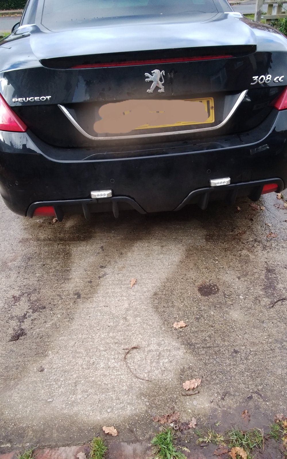

My new reverse lights now im seen by others much better proved by the person getting out of my way faster then before when they weren't fitted

Nice.
They are in a stupid place mind you, my Renault Megane is the same bottom corner of the bumper as well????? WHY. At Night a complete waste of time lights up NOTHING!
Who on earth thought that would be a good idea.
307cc they weren't, Megane 2 they weren't. To make it worse my Megane 3 CC has two clear plastic lenses on the inner lamps on the boot lid which don't work but "look like" reverse lamps, at least mine it clear thought the wife 308cc has read lines on it so it does not even "look" like a reverse light
I find to reverse park on high street I stop & indicate, select reverse, by the time you have done that the car behind is almost on you, to close to see the bottom of your bumper, then wave arms at you when you reverse.
There is aesthetics and then there is just silly.
