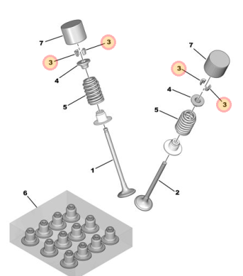

And now i've messed up - dropped a collet on the floor as I was clearing up the stripped parts to make space for another quick job, and I can't find it. That's a real pain. A quick google last night didnt show anything up, although I dont have the OE part number to search in detail.
Valves are surprisingly cheap though, at around a tenner. After a bank holiday break i will have a try at swappgin and lapping a valve and see how it cleans up and seals. Trouble is, I will then need the right number of collets !

If anyone is able to point me to the part number for the collets I'd appreciate it. I can't find that one that I dropped.

Guys - if you are requesting parts, please use the official thread as I may not see your request elsewhere unless I read through every post - and I don't have time for that:
Official Parts Request Thread
(3) Valve Half Cone, part: 9816171280, £3.48
