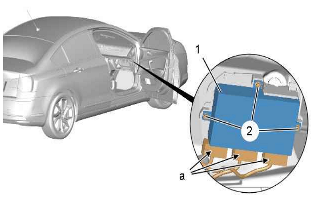

It's in the glovebox - shown below - although not very clear. The glove box needs removing to remove the amp normally.
- Posts: 26
- Joined: 23 Feb 2020, 21:54
- x 1
Re: C5 X7 RT4 - Fitting Factory Amplifier
I know it should be somewhere behind the glove box.. but I didn't find any place to put it, after I removed the glove box. So far... the only idea that i have is to put it into the glove box.. a bit weird..but... I don't see another option..

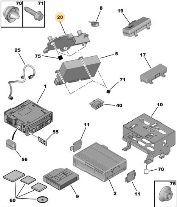

No other info - but I think it is actually mounted on the inside - as if you look carefully at the picture above, you can see what I think is the air conditioning rotary outlet control (the white circular object). The bracket below fits over the rotary control so you can still open or close the A/C vent for the cooled glovebox.
On the parts diagram below, you can see item 20 shows the mounting bracket for the amp -
It is part number: 657908 and costs (UK) £11.06, including our VAT at 20% from Citroen - so not that expensive if you need the originally designed fixing bracket.
