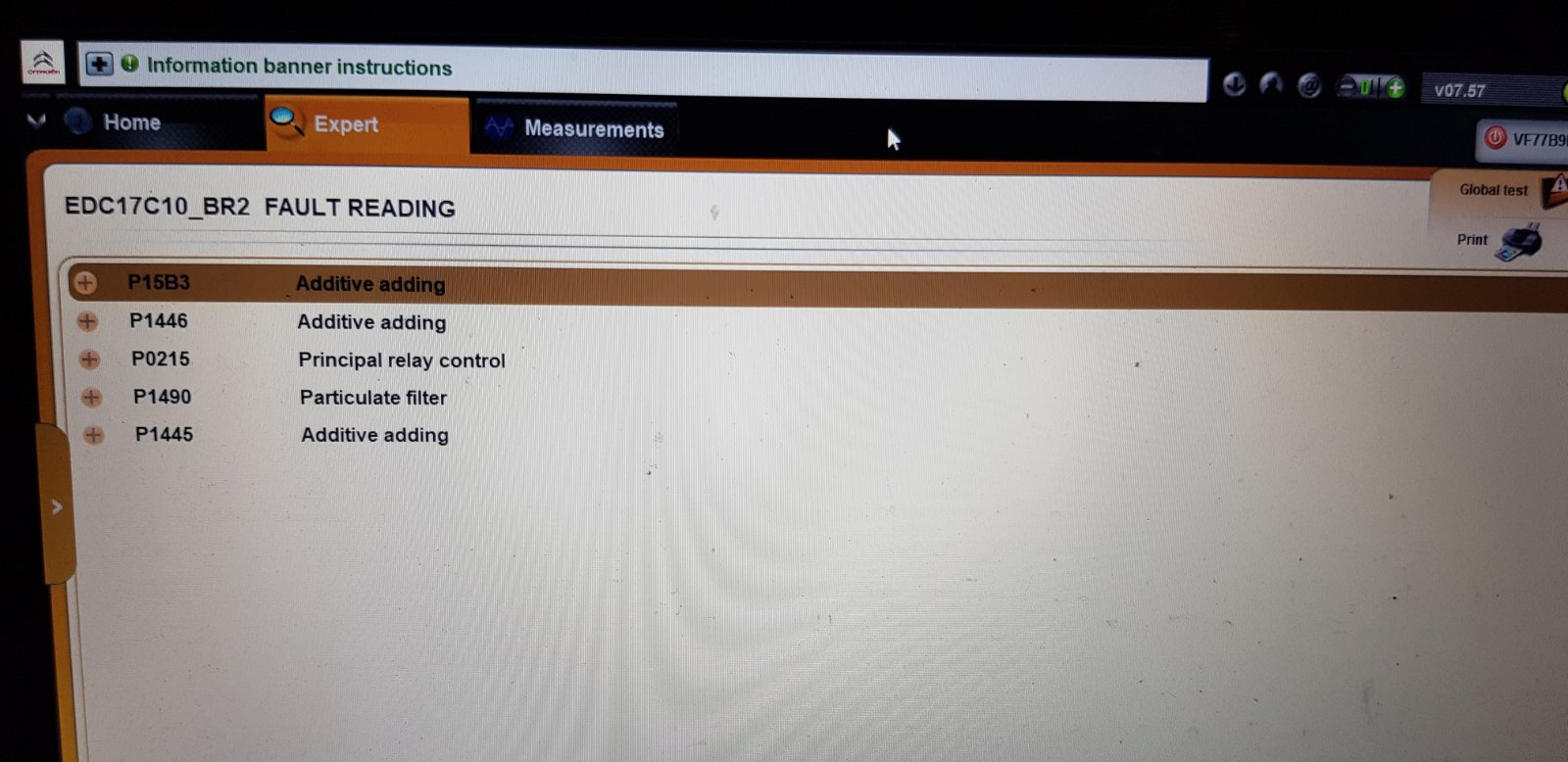

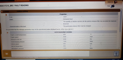

Ok, now we have the fault codes - I think you were interrupting the diagnostic instead of letting it finish, which is why they were not presenting previously.
Codes:
P15B3: Additive adding: Additive level calculated lower than the minimum threshold, the engine management ECU indicates that the additive minimum level has been reached. This is when you get the message: "risk of clogging of the particle filter".
Suspect Areas: Particle filter additive reservoir and / or Particle filter additive
P1446: Additive adding: Calculated additive level below the critical threshold. The engine ECU indicates that the critical additive level has been reached.
Down grade Modes: Deactivation of the additive pump and also deactivation of the request for regeneration of the particle filter from the diagnostic tool.

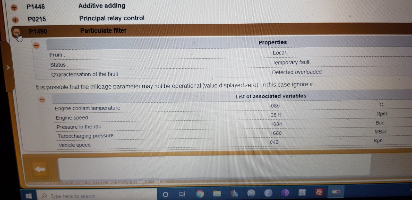

P1490: Particle filter: Detected overloaded. There are 3 possibilities:
P1445: Additive adding: The quantity of additive injected into the particulate emission filter has exceeded the maximum threshold - the particulate emission filter must be changed. The volume free in the particle filter is not sufficiently large. It is necessary to replace the particle filter at the next service interval.
Suspect Areas: The Particle emission filter at the end of its service life.

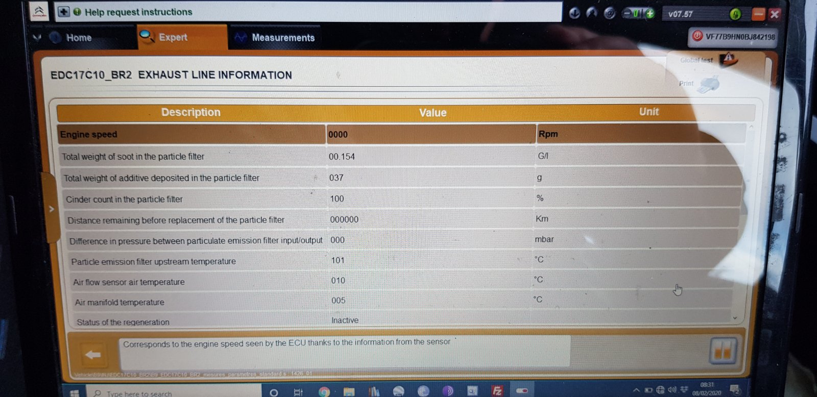

Here is the dilemma:
Your particle filter (from the "cinder count in the particle filter") is now reading 100% - in other words the filter is now totally blocked!
No amount of regeneration will fix this; once it has reached anywhere 75% or above, it will have to be removed to be cleaned. Even an 'in-situ' clean will not likely be able to remove this level of clogging.
The second issue is, that because you have the system reporting there is both insufficient additive and also that the additive is below the minimum threshold, forced regeneration by using Diagbox has been disabled - in other words it will not allow a forced regeneration to take place for safety reasons and as it will damage the engine components (back pressure will be too high when filter is fully blocked).
So this is where you are at, and the quandary is that you may not be able to reset the additive level - because the particle filter is totally blocked and 'end of service life' as reported by code P1445. In addition, the additive pump has been switched off - because of the problems it has detected with the quantity of additive it thinks is in the tank, so is not injecting additive into the tank.
There was an Engine ECU fault P0215; Main relay control: Poor operation of the relay, the ECU is not being supplied as it should be - The engine management ECU is still supplied 1 seconds after the request to cut off its supply. Loss of supply of the engine ECU for 1 s without a prior request being detected, due to an incorrect value memorised at the following wake-up. This fault can disappear after driving for 5 minutes.
Suspect areas: Main relay, Electrical harness, Connectors
I'm not sure what impact that will have on the other issues if any though.

Codes:
- For a volume flow passing through the particle filter of 300 000 l/h, the differential pressure is greater than 320 mbar for 3s.
- For a volume flow passing through the particle filter of 800 000 l/h, the differential pressure is greater than 460 mbar for 3s
- For a volume flow passing through the particle filter of 1 200 000 l/h, the differential pressure is greater than 500 mbar for 3s
