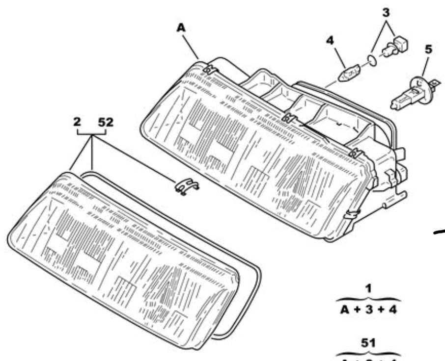

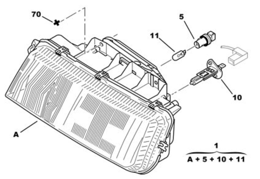

Not too much difference visually,
Xantia S1Xantia S2
I only ever had a Series 2 and found the lights absolutely fine.
