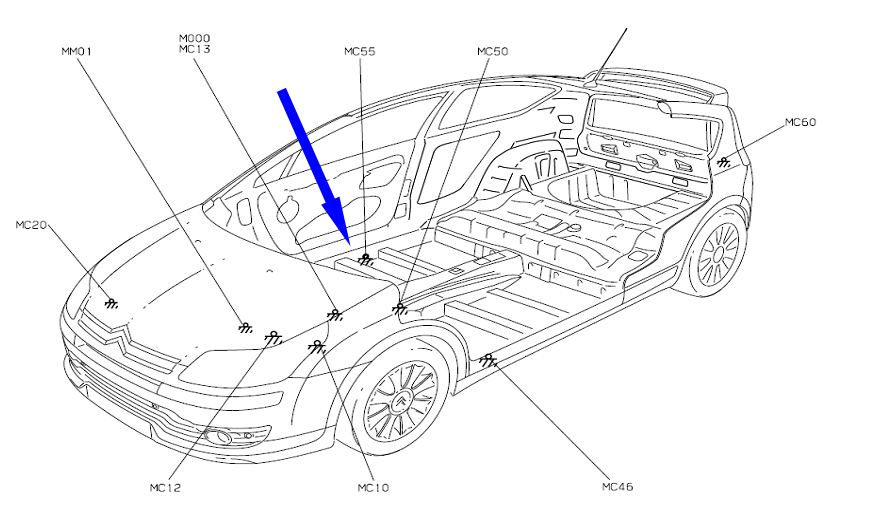

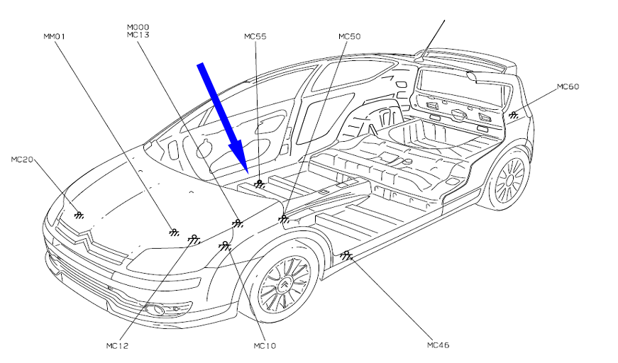

Check Fuse F39 in cabin fuse bank BFH5 (a bank of 5 fuses F36 to F40)
The common earth could be an issue MC55

Replaced the fuse and checked the ground - all fine.
Are heated seats controlled by the BSI or some other controller? Peugeot 508 has a controller under the driver's seat. And how can I check temperature sensor and seat cushion pressure sensor for faults?
