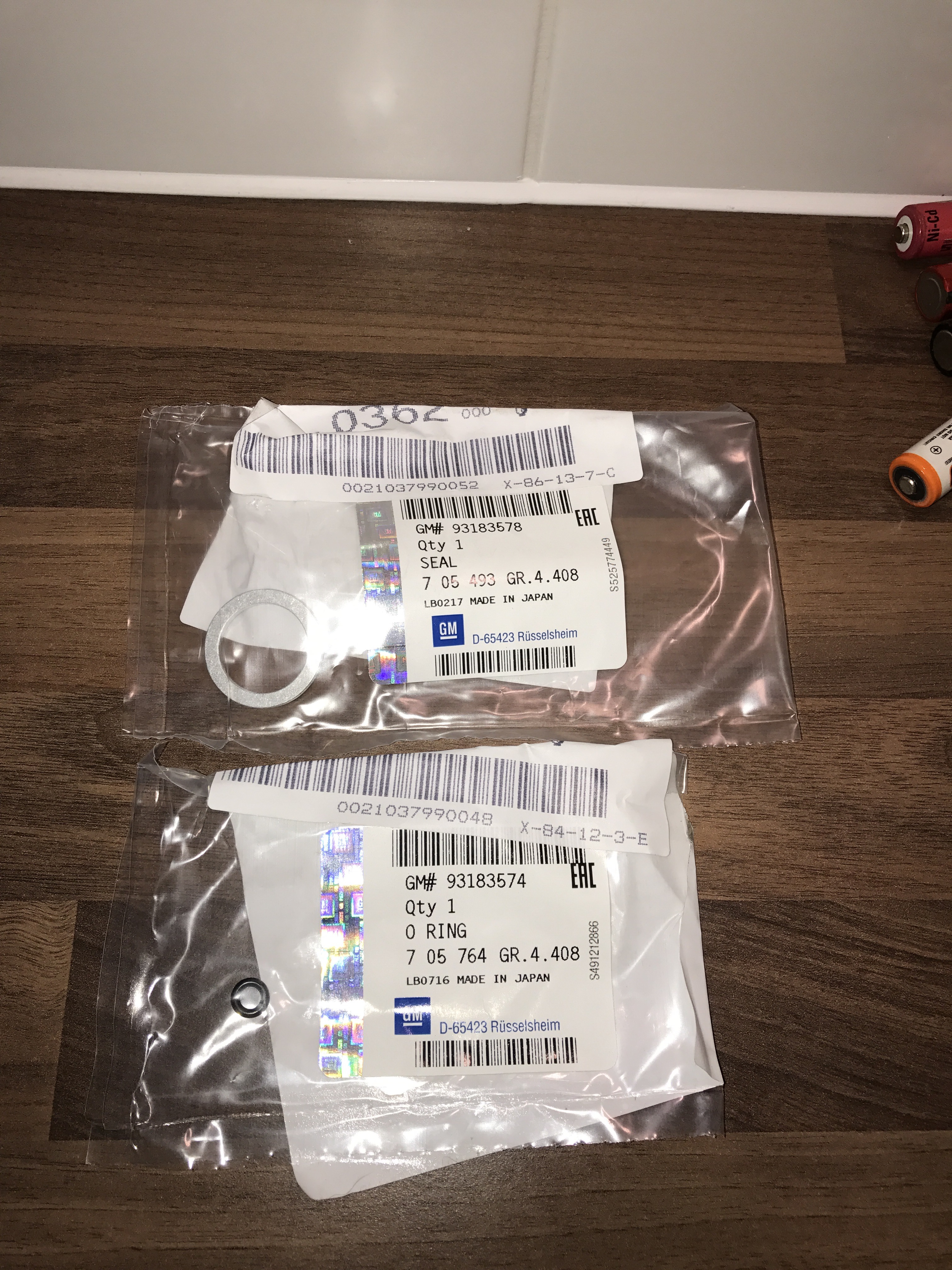

And I picked up my parts from the Vauxhall dealer today.
"Made in Japan".... that's a good sign

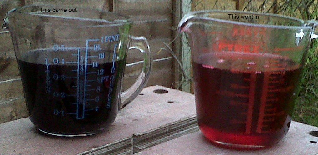

My dad said that I shouldn’t bother as its working well now.... but after i showed him this:
... He changed his mind.
From the sounds of it, these 'boxes appreciate preventative maintenance.

Re: Aisin Tf-80 / AM6 Oil Change Questions
That's a bit of an eye-opener....yuck!
Exactly!, apparently that picture was taken after only 58k miles (Exactly what my C5 clocked over yeaterday
I'll take a pic of my old oil and we can compare.
Just a note, my order from SAABits also arrived today, so I now have 5 sets of O-rings and Crush washers for the drain plug (Plenty for the foreseeable future), they are identical to the ones from the Vauxhall dealer which is good to know (and not unexpected).
In addition to the several litres of purest grade virgins blood ( JWS3309) I also have a funnel with a clear bit of pipe on it, should be very useful for the actual change.
So, no excuses now..... the oil change is ON!
