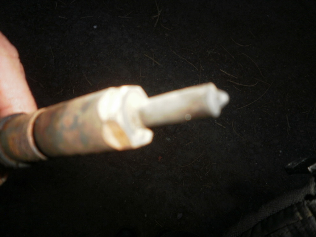

Maybe i have underestimated my diy mechanic skills. I have just completed a haynes 5 spanner job in half an hour!
...the injector on cylinder no. 4 is out...
The hole is dissapointingly sma?l though

Re: Glow Plugs Annihilate 2.0HDi Xsara Picasso
ahh Neil that isn't a large nozzle

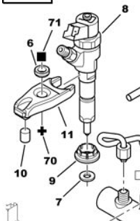

The injector diagram
Item 9 described as engine injector protector I haven't discovered, and another slight difference with the digram is that all injector clamps are secured with bolts rether than studs and nuts.
The little sealing ring is definitely still in the injector bore.
