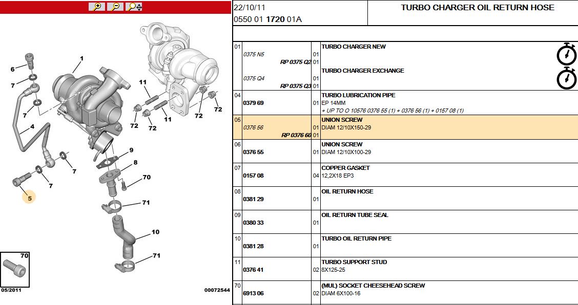

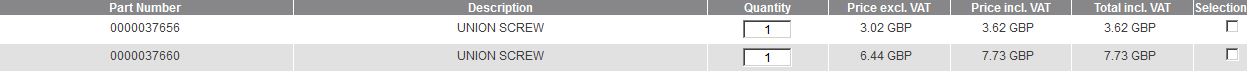

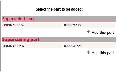

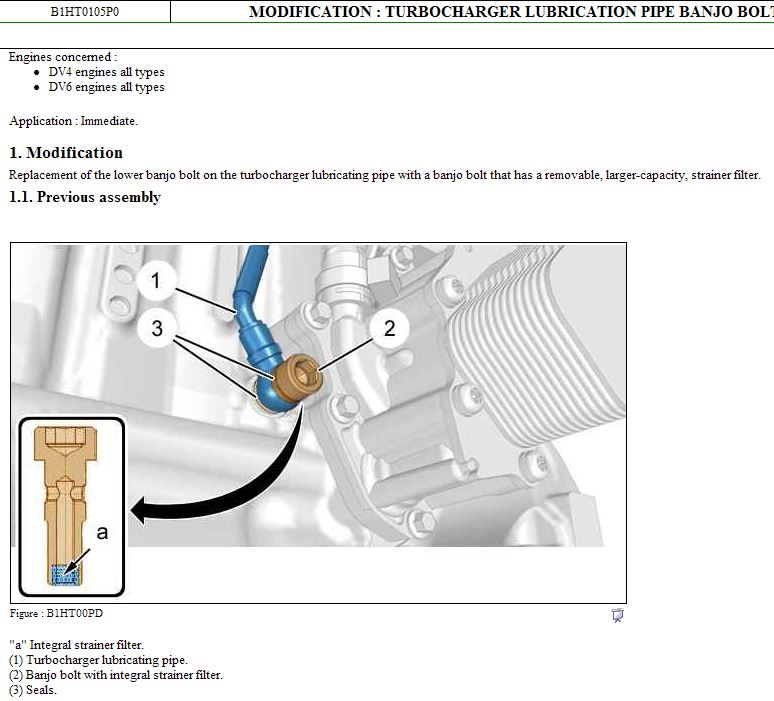

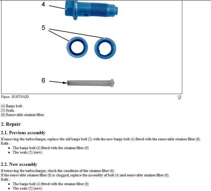

It's not so expensive using OEM parts.
Using your VIN gives me this parts diagram (banjo highlighted) Selecting the part brings up a choice of original or revised part numbers And at the checkout, their prices And the modification document had to crop in two parts...

Thanks Mike,
1. If I've understood correctly - it's just the union nuts that have been superseded?
This does not apply to the oil feed pipe or any other parts?

Re: 1.6 HDi Buying guide
The revised part is the banjo bolt, and it contains a larger plastic filter, rather then the tiny metal mesh of the original. I wouldn't bother with any parts, just remove the bolt, and dig the filter out. I replaced the turbo on our C4 at 70k, and removed the filter. Since then, it had low oil pressure twice due to blocked sump pick up, but the turbo is still OK at 110k - so removing the filter will protect the turbo. On a 90 BHP without DPF and the simpler turbo it should be possible to remove it without having to take the radiator out, which will cut down the time. I'd reckon 1.5 hours tops.
