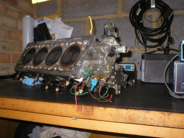

Mike, although there are no core plugs on the gearbox side of the head there is a complex water manifold (what our snail-eating friends call an outlet tank) that bolts onto the side and contains the thermostat, the sensors and the heater matrix take-off. I'd not be surprised if the gasket between the head proper and the manifold is not gone and causing the leak.
If you want, I'll take a picture of it later... It bolts onto the side of the head. I've looked in service.citroen.com but I can see no gasket.

Mike, here's a picture of the head and it's water manifold...
Please note that the rest of the engine and the car have been removed for clarity...

Mike, If I have the time and energy tomorrow I'll whip the manifold off that head and see what lies beneath...
